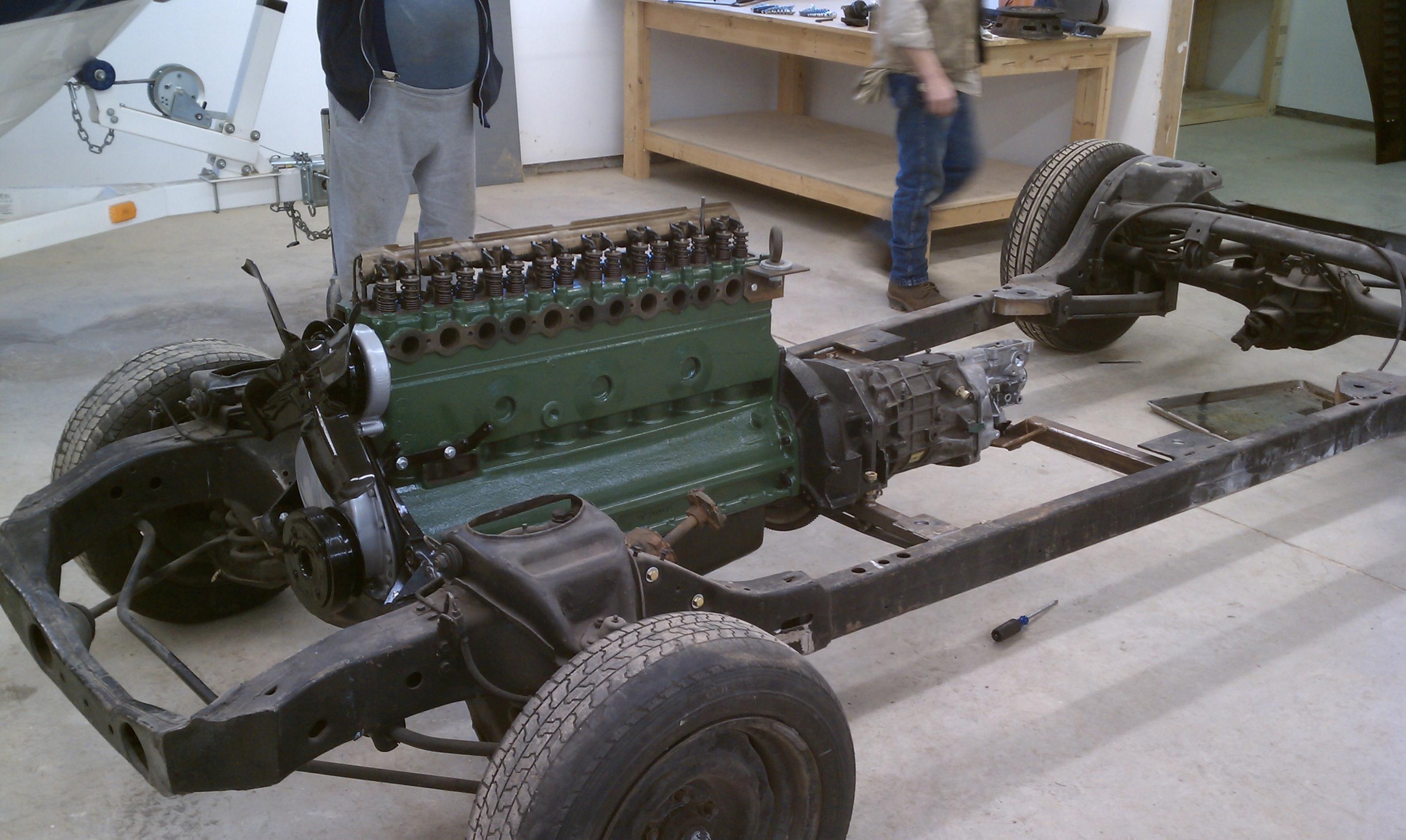

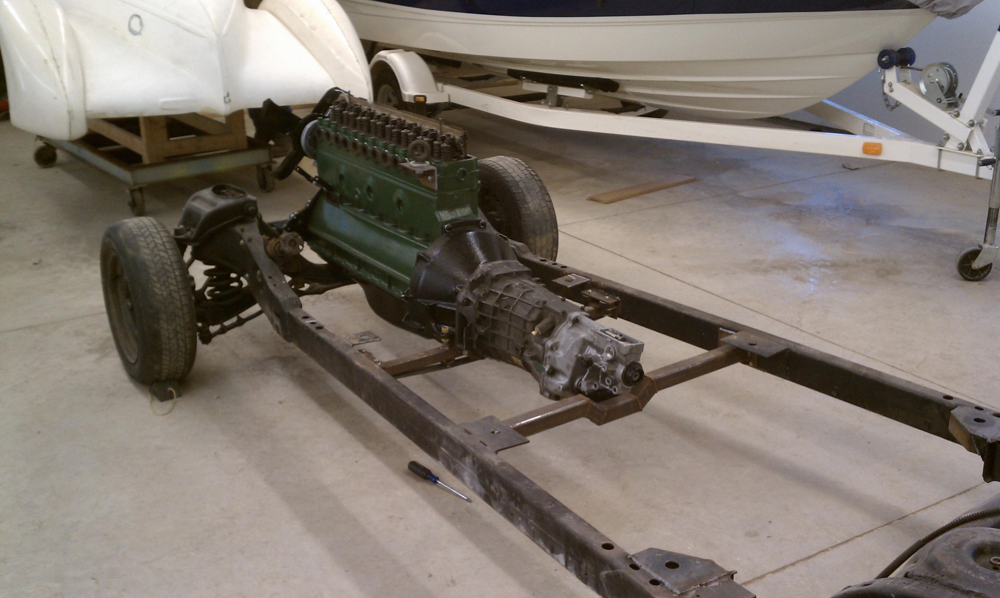

    Hey all got an update:
    Moved the engine to the house and installed he in the ch***is today!
    I will post pictures possibly as early as tomorrow
    We needed to remove the body so we have some pictures of the engine in the ch***is, and we re installed the body
    Man it is exciting
    I hope to light a fire in it in the next week or so and have it running.
    Clutch linkage and steering is next on the list
    Thanks
    Dave

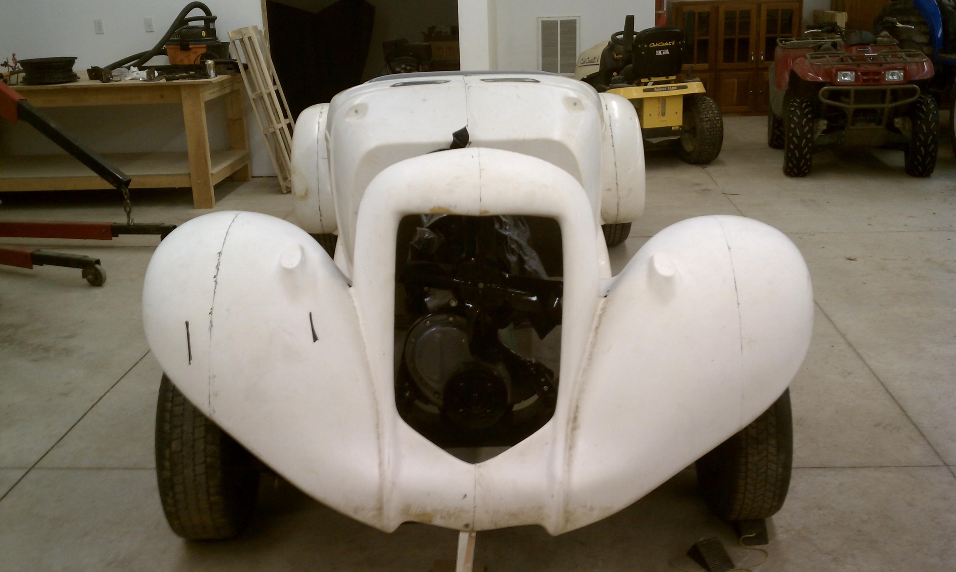

    Here are some pictures of the progress
  15. 320 Auburn
    Joined: Jan 27, 2012
    Posts: 52
    320 Auburn
    from NE Ohio
    let me know your input
    Dave

    Looking good - I think you´ll need some seriously large diameter tyres to fill the wheel arches. Those motors never fail to impress.
