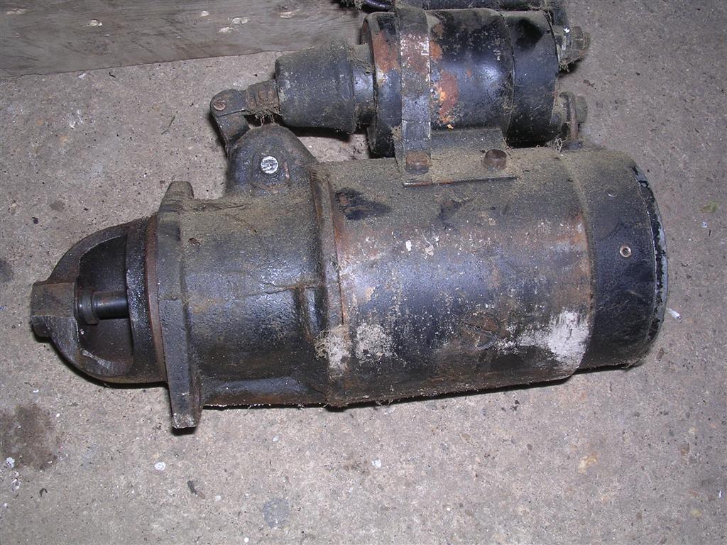

    If yours looks like this solenoid setup with the lever?
    - The first thing is to know what's in there and how it works;
    the solenoid does two thigs. when it starts to pull the piston, it moves the gear towards the flywheel. But, it will not make an electrical connection to spin the starter armature UNTIL it the piston reaches the very front of the solenoid. How it makes the connection, is that it shoves a round copper contact to jump the main post to the post that goes to the case..which goes to the windings.
    so, as designed when new, the gear should be fully into the ring gear before the starter spins.
    if the starter spins before the gear is all the way in, then there is slop in the linkake or a worn yoke, or worn areas on the groove in the gear ***'y.
    Think of this as a typical throw out bearing and yoke, they work the same.
    One thing I wonder is if the yoke is not inside the correct groove, or jumped out?
    What I would do; Take out the small pin at the top of the linkage, take off the lower big terminal nut, take off the solenoid.
    Now work that yoke to check for travel or slop.
