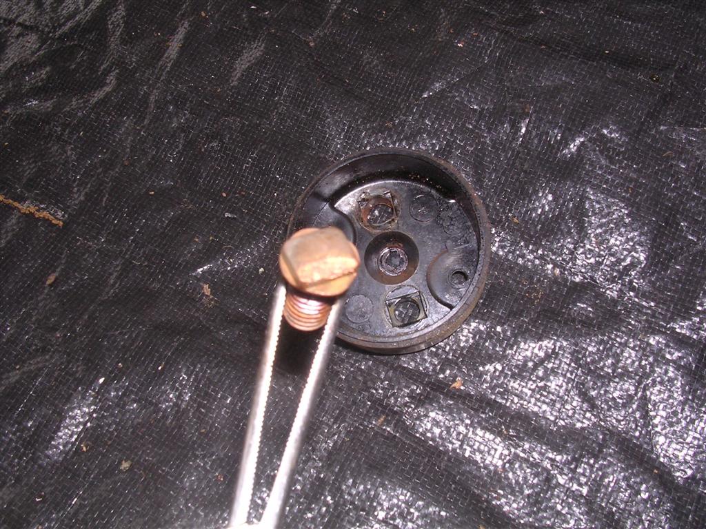

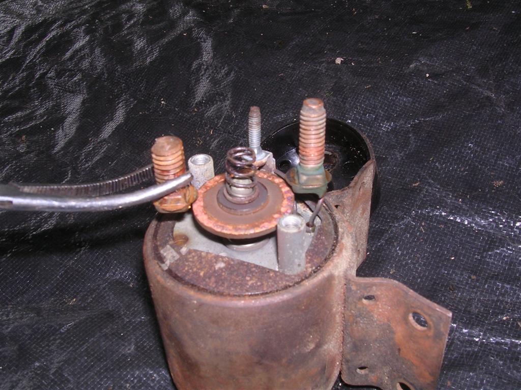

    It does come apart like a typical GM solenoid. This one does not have an I terminal for the coil, so it is not Olds, but the same otherwise.
    To take off the cover: Take off the S terminal lock nut and plastic washer. Do the same on the big post that goes to the field windings. Now take out the two mounting screws. Gently tap those two studs through the cover, as you lift off the cover.
    First pic shows the black cover off. You can see that when the piston gets slammed all the way, the copper disc makes contact with the main batt cable post terminal and the big post terminal that goes into the starter housing to the fields. That connection makes the starter turn.
    next pic shows the burnt up side of the main battery terminal post. You can rotate that 180 degeees in the black cover, to end up with an unused connection point.
    Last pic shows it is now flipped 180. The other copper post cannot be flipped 180 because there is a wire welded on one side; but that post face usually does not get burnt as much.
