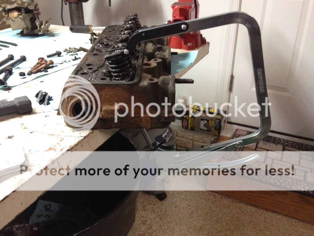

    Finally got to some time to work on this again.
    Trying to remove the valves from the heads, but no luck.
    Even got one of these fancy tools:
    It doesn't even move the springs a bit.
    Seems like all the force applied goes into bending the frame of the tool.
    Anything I can do to fix this?

  4. F&J
    Joined: Apr 5, 2007
    Posts: 13,291
    F&J
    Retainers stuck to keepers....normal.
    Hold a bit of tension on the tool, then tap down on the exposed edge of the valve spring retainer. A light tap should do it.
    Some guys are brutal and don't use that tool to take them apart.. They place a deep socket over the retainer and smack it hard with a BFH. The keepers spit out and you're done :) It sometimes nicks the sides of the stems from the keepers digging in.
  5. F&J
    Joined: Apr 5, 2007
    Posts: 13,291
    F&J
    huh? talking chevy sbc?
    anyways, the keepers are stuck, he does not need to buy a tool for a sbc. Just a tap from a hammer.
  6. Martin_F
    Joined: Mar 3, 2008
    Posts: 2,527
    Martin_F
    You are the man, Frank!

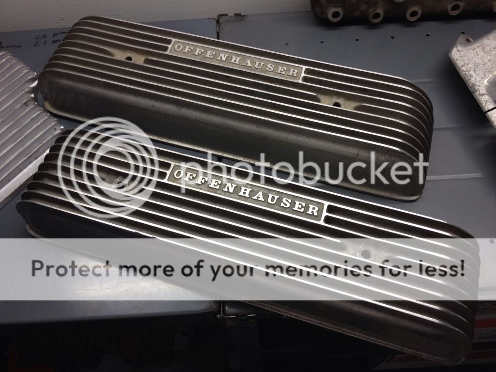

  23. F&J
    Joined: Apr 5, 2007
    Posts: 13,291
    F&J
    Geez, what's wrong with THAT set of Offy covers you have? Those are great.
    Hey, I looked at the ebay sellers ad and he also says this :
    What on earth is a 3 bolt trans? I looked at his "other items" but it is not there.
  24. Martin_F
    Joined: Mar 3, 2008
    Posts: 2,527
    Martin_F
    Nothing wrong with it Frank, but once I'd seen the set you're running, I was jealous ;)
    Not sure what he's talking about. Seems like he bought the parts a while back not knowing what they are (yeah, right) and now tries to sell them off. If he really wouldn't have a clue, the Edmunds valve covers would be $30. :D

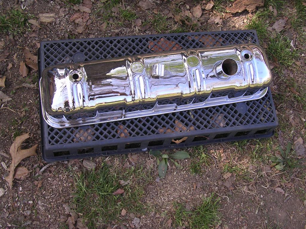

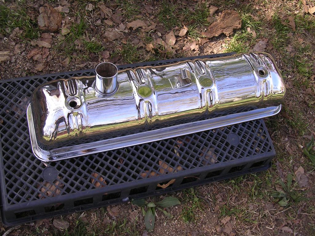

    F&J
    Speaking of Stude covers on an Olds...
    My friend just found these replated stock Stude covers, wrapped in early 70s newspapers,,,,at a YARD SALE Friday :)
    I had a set of Olds heads here, so we tried them, and unless I was in the wrong hole...I dropped a phillips screwdriver down though the bolt hole, and it lined up with the threaded hole in the head?
    The heads I had were #10's and I swear I saw dual threaded valve cover holes about 2" or so apart, on the head surface? I sold the heads on Sunday, so i can't say for sure. All I know is those Stude covers were a bolt on.
  29. Martin_F
    Joined: Mar 3, 2008
    Posts: 2,527
    Martin_F
    The mounting holes on these covers seem to be further apart than on the Olds, and also off center to the bottom?
    Or am I missing something?
  30. F&J
    Joined: Apr 5, 2007
    Posts: 13,291
    F&J
    No, you are correct. That's why I mentioned that I tried lining the holes up.
    My friend saw me line up the hole, so both of us can't be in a daze :)
    I keep waiting to hear from the buyer of my heads in Albany. He is supposed to call, looking for a trans gear, when he measures it. I will ask him to look at the head for a dual pattern. This is weird.
