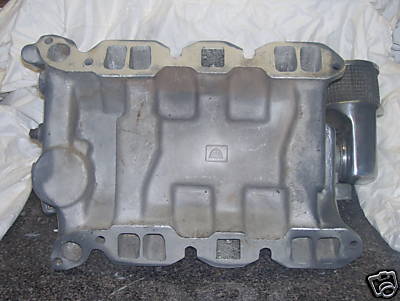

    Here are the tabs I discussed, no problems with bolt holes not lineing up, no trying to figure out spacer thickness, and only (1)one gasket to install, and as I stated, this is what Wiend did, I'm sorry, but I just don't understand why you would go to all the trouble of a spacer....and my apologies to F & J for misidentifing him as F & G...

    Thanks for the pics!
    I'll have to find out if there's somebody around that does aluminum welding.
    Any concerns about welding to the 60 year old intake?
    Like I said, I'll have to wait to get the heads and block back, to see how everything fits.

    No trouble for me at all.
    Back to why or why not? I'd say most people would not want the welded manifold. Not because there is something that won't last, it is just a fact, that almost nobody wants to see welds on a vintage intake. It kills the value, but if you are never planning to sell it, then who is to say.
    Here is a better question; Why are we using horribly mismatched manifolds? I am the worst offender on here, I'll bet. A 303 Edmunds intake on a 324, and a machined J2 371 intake on a 303. Duh.
    I should swap but, I want a tripower on the 40 that has the 303, and a 303 is a better fit in the 40 because of the right side exh manifold style....so I don't want to swap motors. And...I don't think the Edmunds backdrafts will look right on the 40.

    371 has the higher deck, so the heads are further apart. The Edmunds is just too narrow for welds. These plates were about .250" as I recall. Thick enough that they also can eliminate the rear water port cover plates.

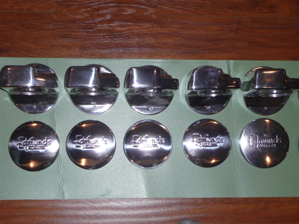

    Not sure who makes them, but I'm buying them from Tony at Ross Racing Engines.
