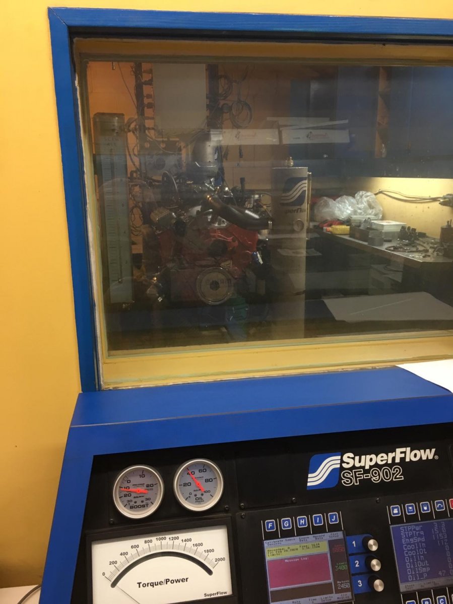

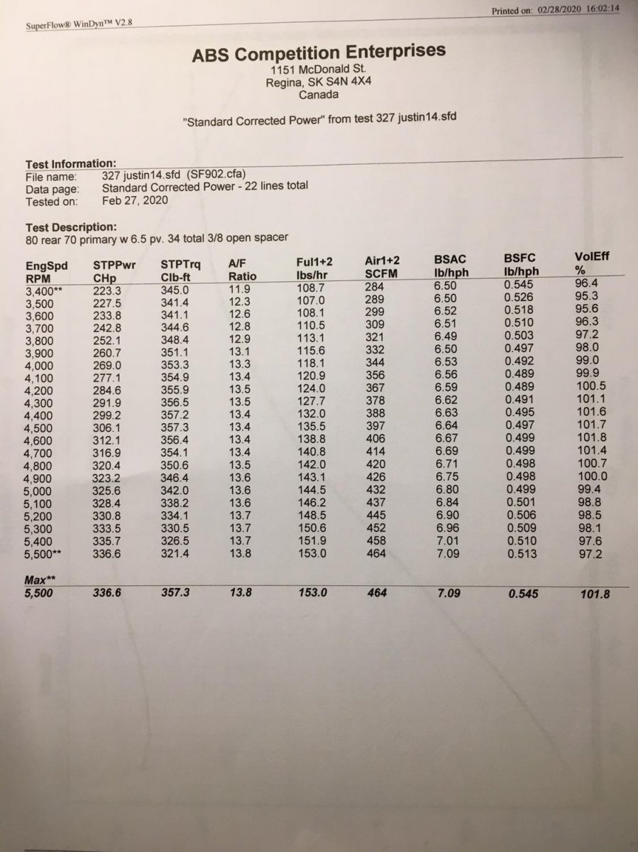

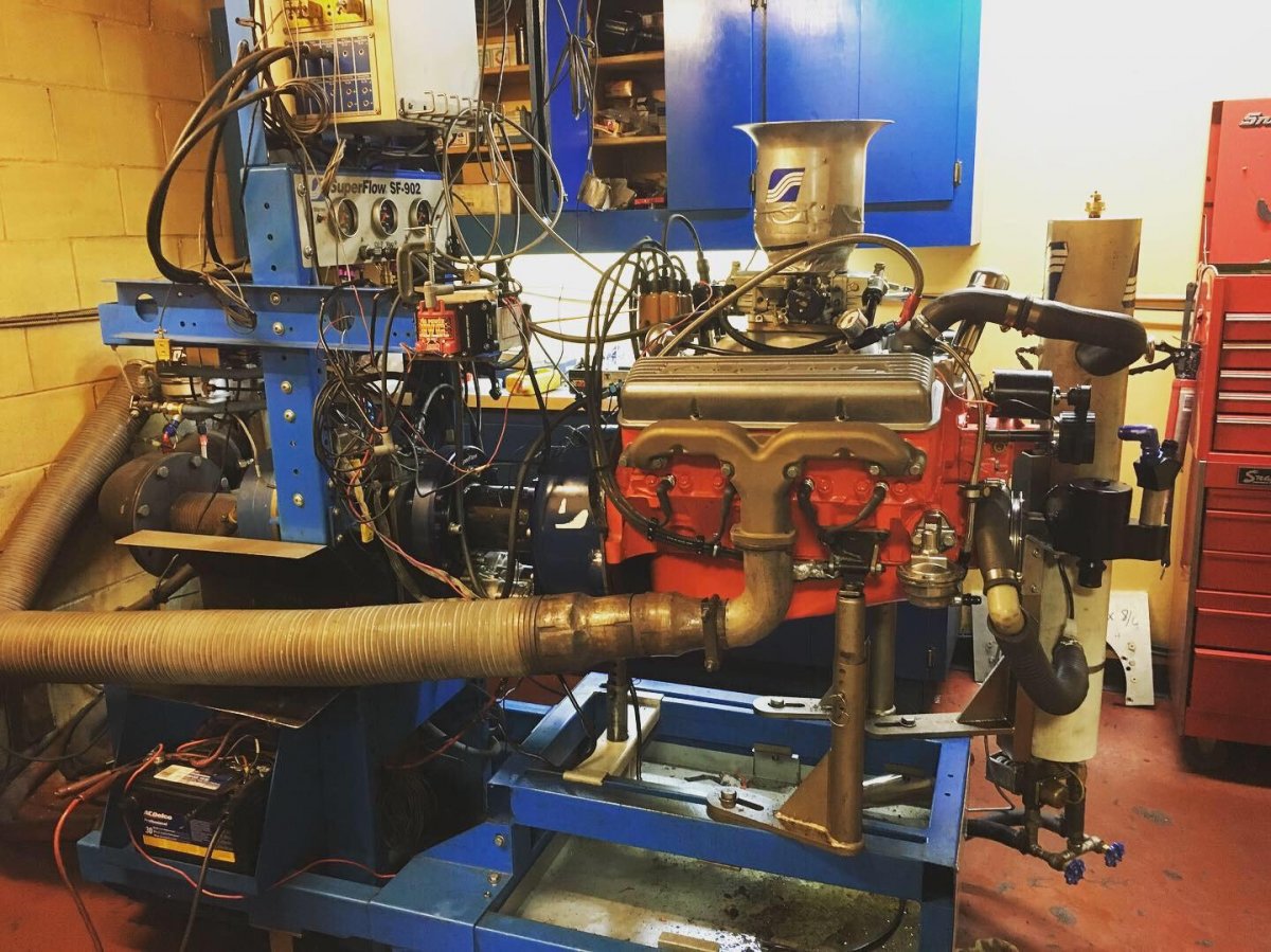

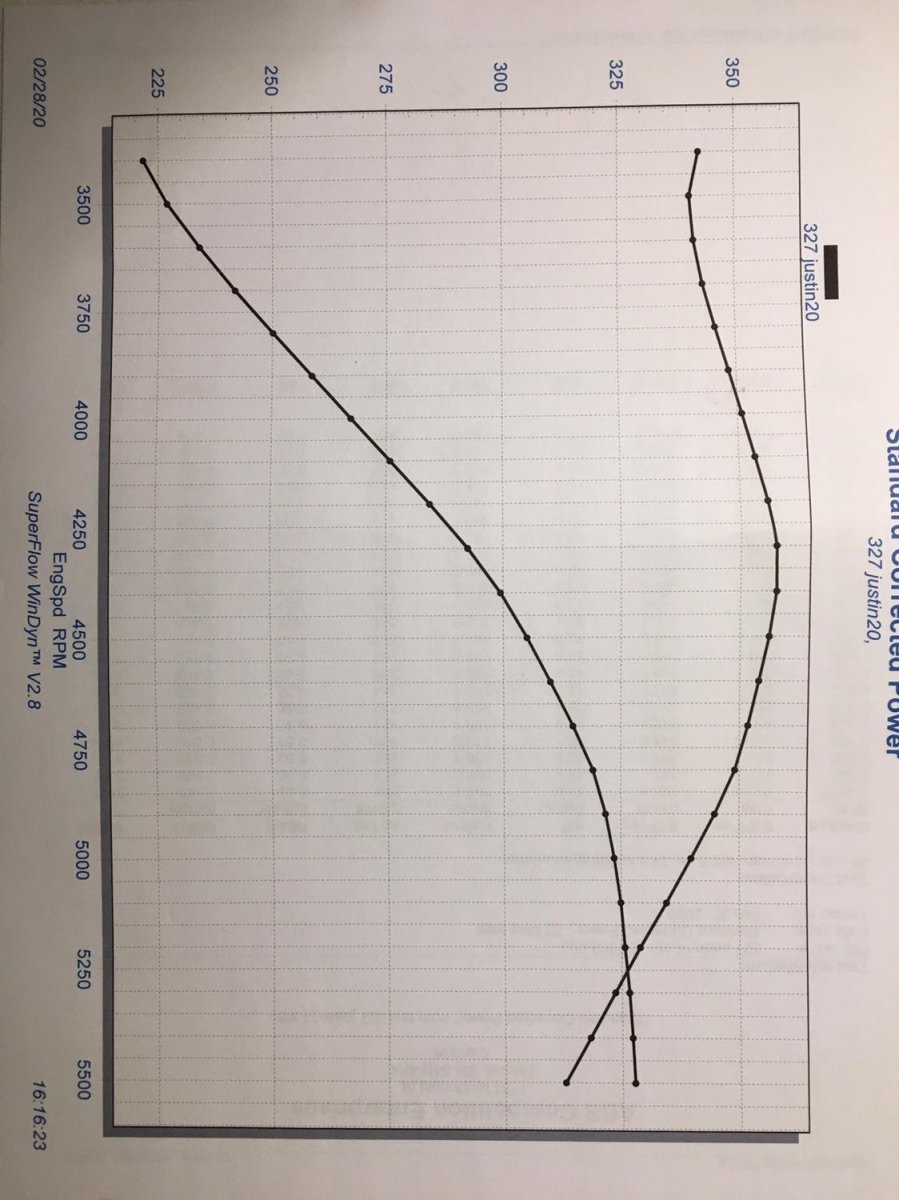

    I updated my build thread, but not this one. So I took the engine to a good shop that specializes in race engines.
    I told him to do what he wanted and pick the cam and go through it.
    He cleaned it up, machined the heads for screw in studs and cleaned them up for better flow.
    He thought the cam didn't look that bad, some wear but maybe a bit too much for such low miles.
    Also ended up with a distributor problem, the pertronix was acting up when setting the timing so that had to get fixed.
    He went with a comp 280H, everything else will be the same.
    The nice thing about the shop is they have a dyno and broke it in and tuned it for me.
    I'm happy with the results considering the small old heads. (1 hp per CI with the .040" over bore).
    I have re-geared the car to 3.89s from the 3.00s I originally went with, still should be tolerable on highway with the tall 7.50 tires. (60mph should be around 2500 RPM which was a comfortable cruising speed on my trip last year).
    Can't wait for the snow to be gone, 2500 lbs, 333hp/345ft/lbs, 3.89s rear and a 3.42 1st gear, should be a hard on the firestones 0a069245ce44d87c513d0ba2bd36aaba.jpg 50d7dfd32ac91d472d43513f9674a830.jpg 370e7ae09015e10d51f4e8d68dc963a0.jpg 60385c766743c6bf2e705e62bc3f2716.jpg . :)
