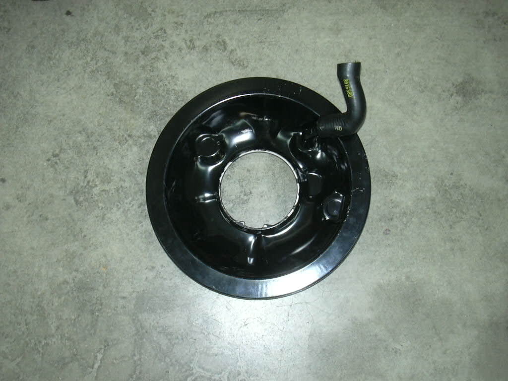

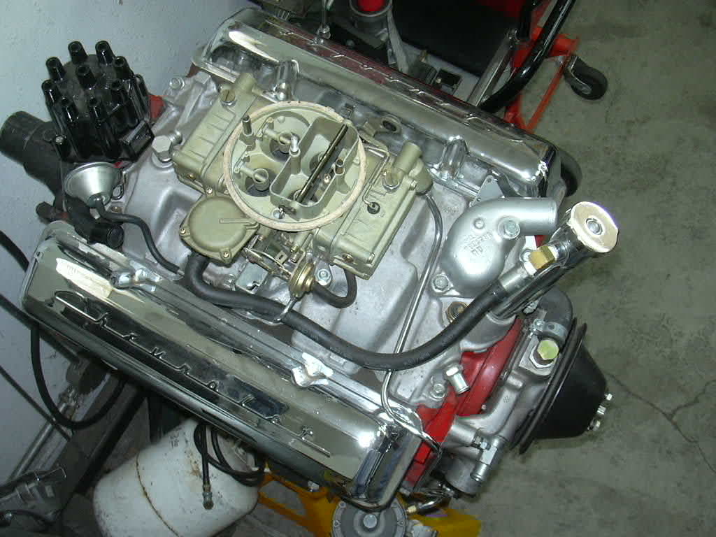

    My 327/350 hp has the exact carburetor that GM put on the L79's, a 585 cfm rated Holley.

    Where's the air inlet for your PCV system ?
    Doesn't have to be dp to be Mech secondary , like a list 9776
  14. DDDenny
    Posts: 23,001

    Those are tunnel ram carbs - no place on a single application - when you say double pumper most ***ume carbs like list 4779
