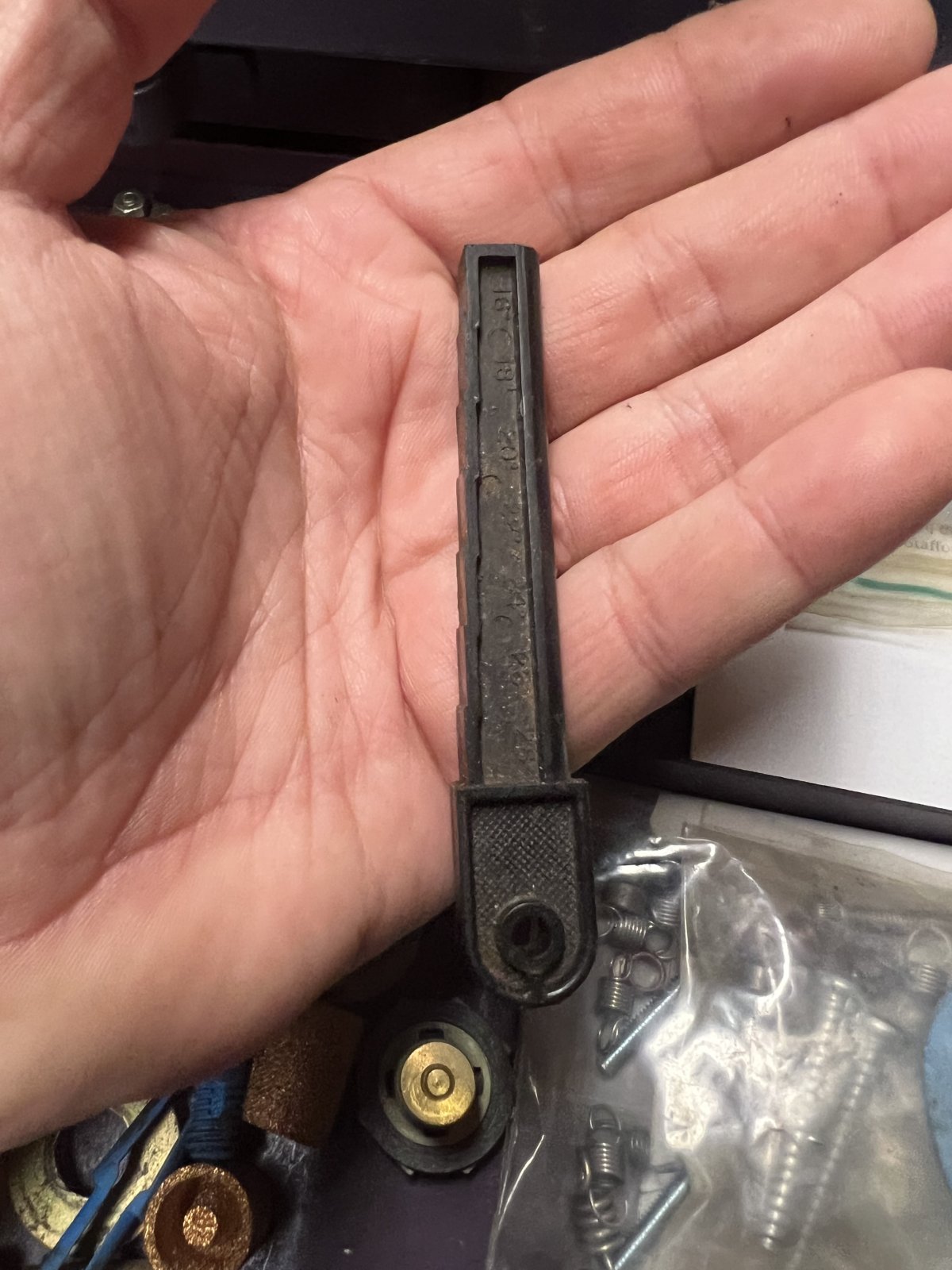

    And if you had a Mallory you need this little black key

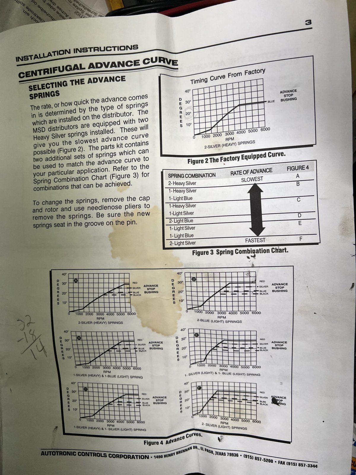

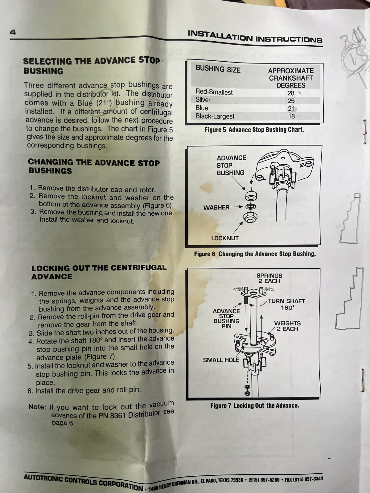

    The MSD distributors typically come stock with the heaviest springs (slow curve) on them.
    If it did, then ....
    This is the next move, crank in some more initial timing, maybe clear up to 18°.
    Low compression and low engine speeds means low air velocity into the engine, so you end up with a low density mix in the cylinder that you have to lead more when introducing the spark in order to get the peak push on the piston to happen at the right range of degrees after TDC.
    Put the spark in there earlier, you're not getting enough push on the piston at the right time to be efficient.
    If you didn't confirm you were at the end of the mechanical advance curve, then you need to proceed more cautiously to prevent running into higher rpm detonation due to the advance increasing at high rpm.
    Ultimately, you want to end up with a short curve on top of a lot of initial advance for the low compression engine.

    In summary,
    1. With vacuum gauge hooked up, vacuum advance hose removed and plugged, advanced timing to a point where the vacuum gauge shows happy.
    2. Adjust idle mixture screws to get the most happy reading on the vacuum gauge.
    3. Rev the engine up past 3000 RPM until advancing stops in an attempt to determine where the mechanical advance ends.
    4. Swap out springs to make step 3 better suit actual driving conditions
    Does that sound like a good plan for this afternoon?

    What would be the maximum mechanical advance? You would advise? What RPM would you want that to be at? I don't ever plan on cranking it over 5000

    Maximum is probably going to be in the 36-38° area, with initial in the 15-20° range. You'll have to experiment with how early you can get it all in, you want as early as it will take and not give you detonation, most likely somewhere between 2300 and 3000 rpm.

    The MSD distributor pro-billet vacuum advance distributor maxes out at 36 degrees in it's factory configuration. With the factory weights, bushings and springs, I get the full 35 degrees at 3800-4000.
    Here's where I landed after trying many combinations over the weekend:
    The engine likes 8 degrees initial (vac advance plugged) - this is a median between not heating-up while idling and good power in low and mid-range. I get around 18 vacuum with that setup. fires right up when you first bump the throttle, even hot.
    IF I set initial at 12, it's much more snappy off the line (big burnouts), but runs hot (hasn't over heated, but was pingy and seemed headed for a boil-over)...vacuum is at around 14. I tried fattening the idle mixture to get the temp down but that didn't effect much. Also was getting hard to hot start with 12 degrees initial.
    I am going to try and change the accelerator pump "curve" by playing with the linkage positions - also may put a larger squirter in it (have a pack of those on my bench) and see if that helps off-the-line response.
