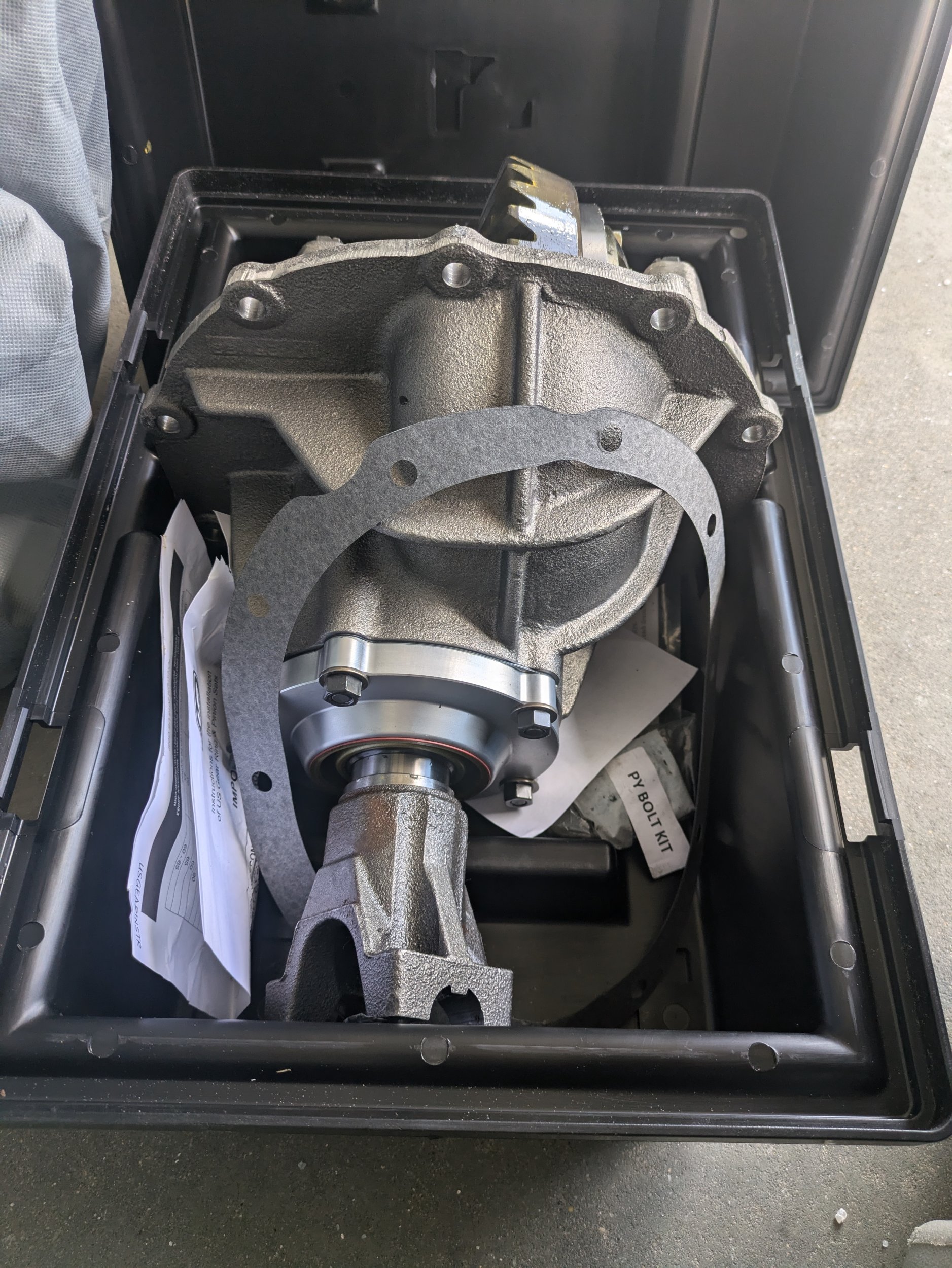

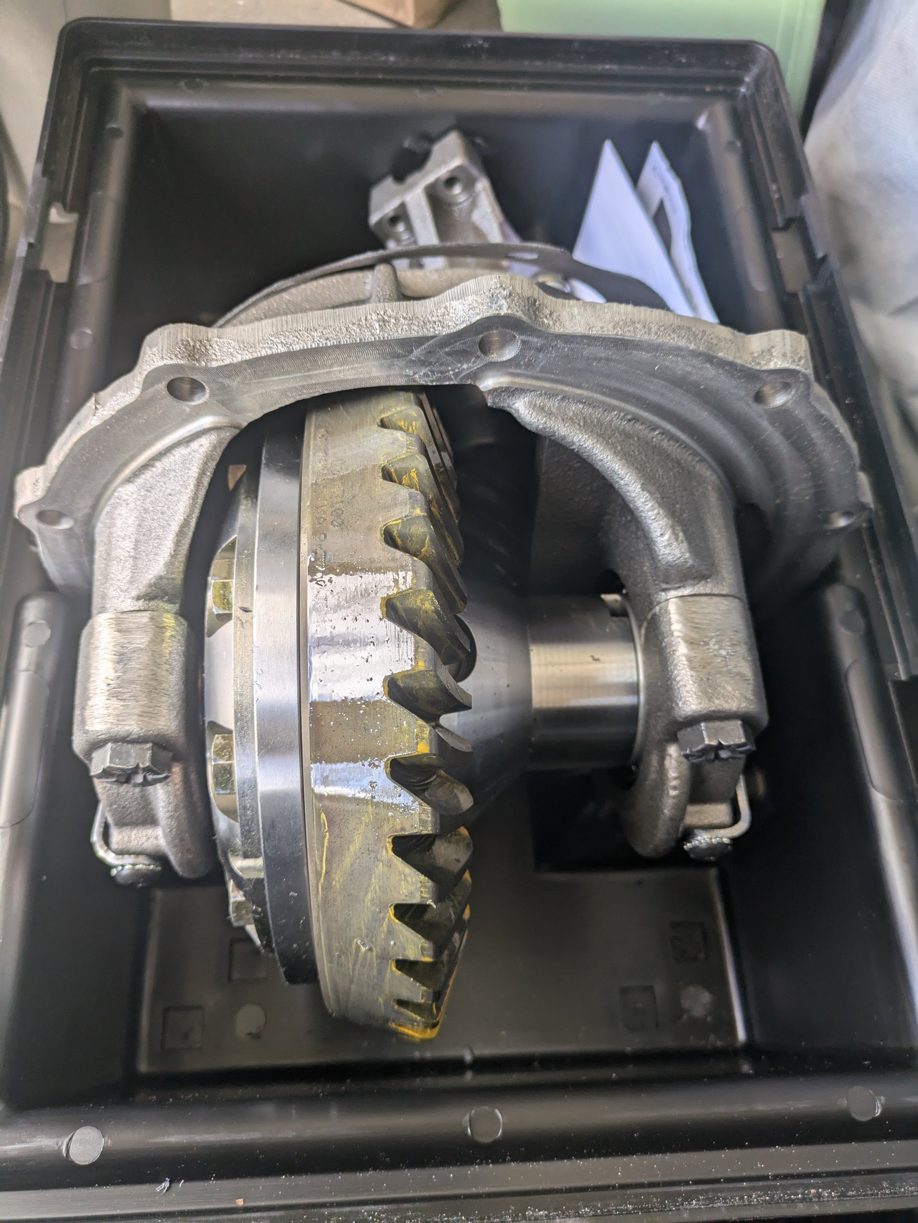

    I've not changed out a 9" pumpkin while the rear end is in the car (only after taking the rear end out).
    I can get clear access to knock the lower five bolts into the housing, but not necessarily the ones on top... Anyone ever been able to get a pumpkin off without knocking all the bolts in?
  25. 19Eddy30
    Joined: Mar 27, 2011
    Posts: 4,400
    19Eddy30
    from VA
    Yes , You should , some times take & let rear drop down slide chunk out,
    If just using a Jack , remover cup on jack & make a Fixture to mount to & 2 pion bolts to help hold chunk . So you can roll jack
    Back & Forwards .

    Good idea to hold pumpkin while remove/install...I'm using a HF trans jack, which scissors and has a strap - should work.
    I'm having difficulty getting the pumpkin to part ways with the housing - it's stuck on there pretty good and I don't want to be at on the seam with something and risk bending the housing. I currently have the lower 5 T-bolts pounded into the housing.
  27. 19Eddy30
    Posts: 4,400
    19Eddy30
    from VA
    Some can be difficult ,
    On one's after not separating with
    Heave dead blow , work in between with heavy duty gasket ****per to get a gap ,
    wants started , step up to Prybar's ,
    2 with heels , walk it from housing.
    There times when you knock T studs threw ,
    Then when you go to install chunk the
    T studs push threw easy , then back to pulling chunk again until you tac
    T studs back in place ,

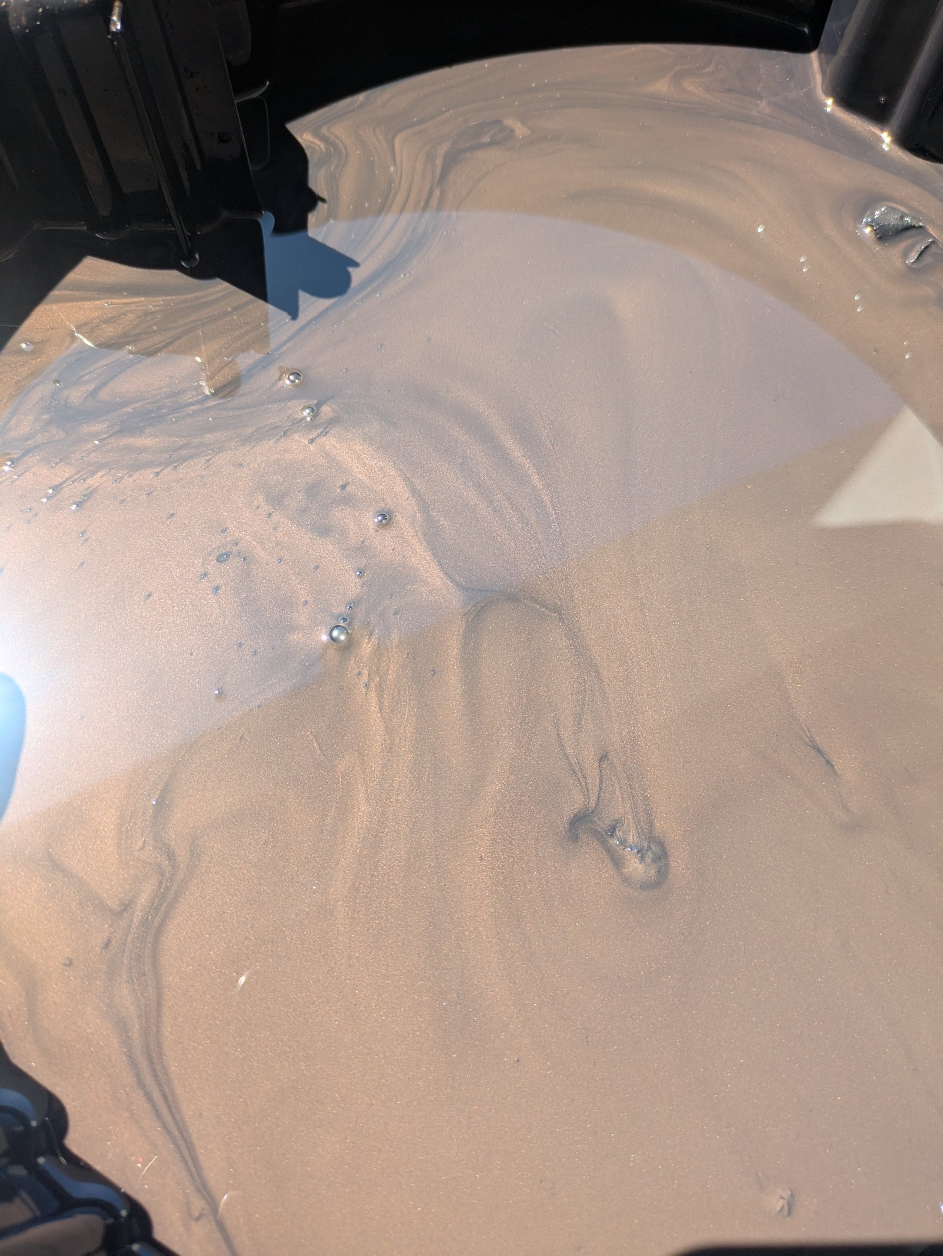

    So, the differential that came out of my rear end is a unit bought at a Ford dealership, with a trac-lock differential and 350 gears.
    I used Lucas gear oil which has the friction modifier built in. The differential was tight at first, but after I drove it a bit it loosened up and stopped chirping around corners. I put about 500 mi total on this unit- what do you think about the state of the gear oil I took out?

    Are those shiny bubbles or metal particles? The "milky" color of the lube is moisture? As the gears wear in the fluid usually turns darker.

    Bubbles...the gold metallic paint look of it surprised me. Clutch break-in ?
