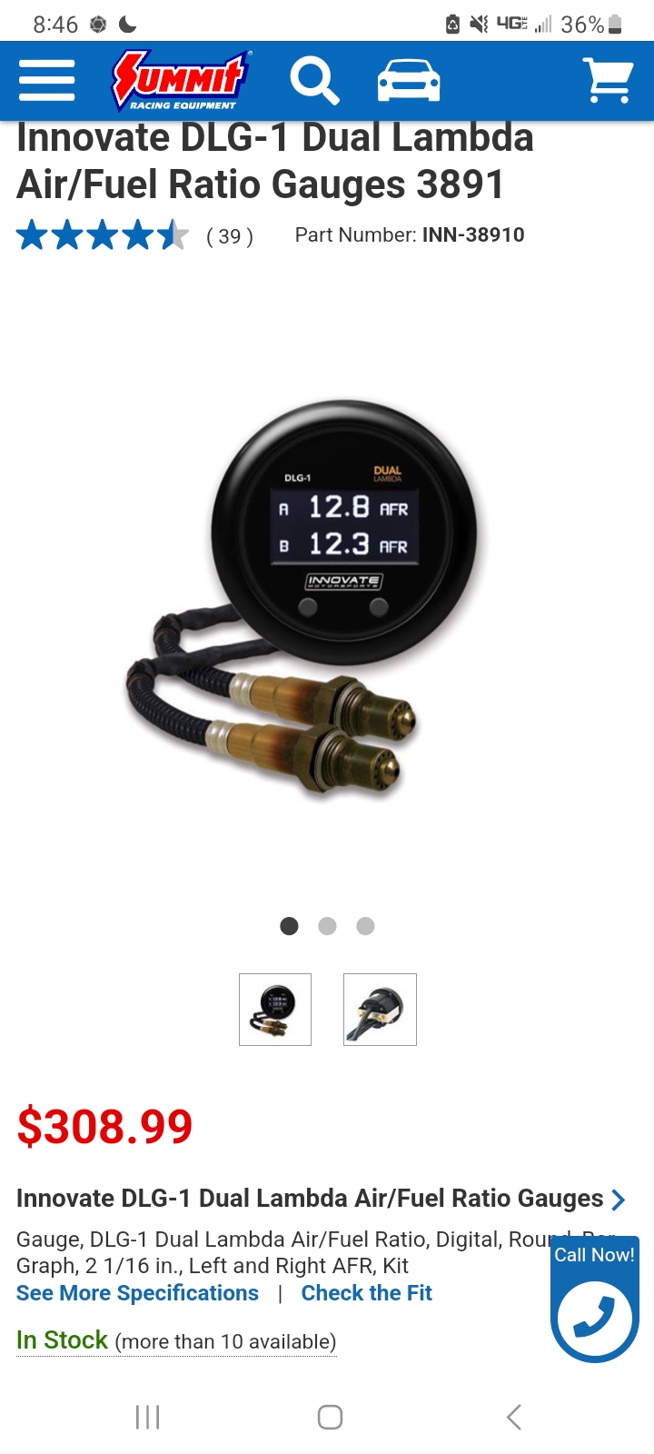

    Don't change too many things at once. Remember where the baseline is. AFR gauge might be a nice addition. Summit sells a dual Lambda...

    Do you have to install these things in your exhaust pipes close to the engine? Are there any of these out there that you can stick in the tailpipes and use temporarily?
    I really don't want to weld a bung into each exhaust pipe and have some Krazy digital gauge with a traditional hot rod
