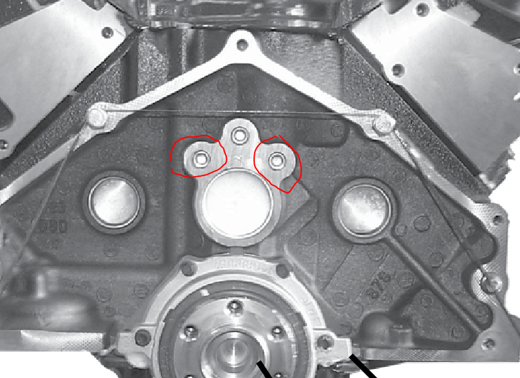

    No! They're behind the flywheel.
    If you pull the trans out about 3/4" [sliding on the bolts] you can shine a flashlight of inspection light down there and see if they are grub screws or anodized bolts [or bolt heads]
    The Factory used grub screws.

  4. I built a 327 once and had a similar problem. Turns out I forgot to put the 2 little plugs in behind the timing gear.

    I am really glad i asked! Thanks for the info everyone!.. I think i will check the plugs behind the timing chain cover. Then the ones on the back of the engine.

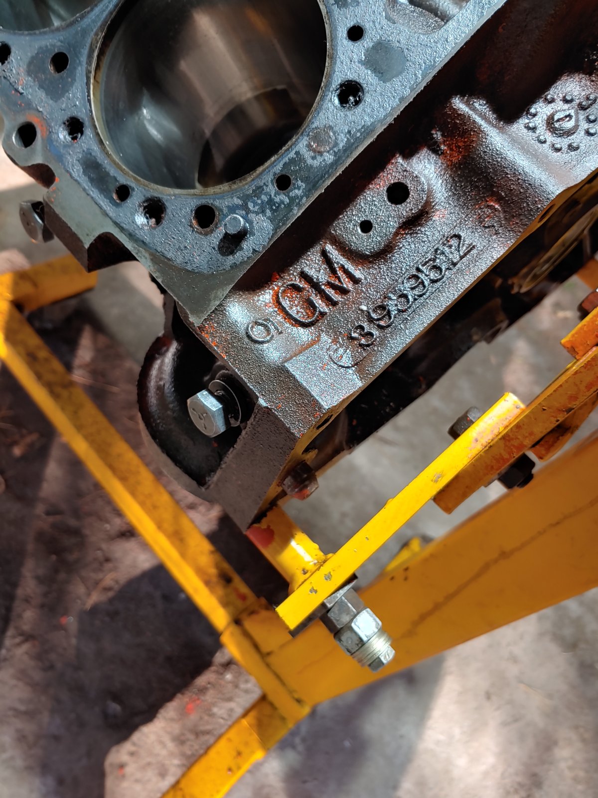

    I'm not sure.. I've read that, but looking at it. It doesnt seem to make sense. The only hole around the dizzy sleeve in the block is on the passenger side lifter galley... It looks like that would have to fill & Then! Go around dizzy... But maybe I'm wrong.

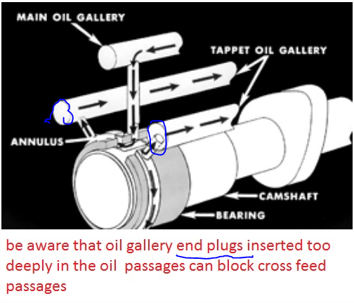

    You are correct -as others- the only thing i was thinking was that if a rear cam bearing has spun it may have blocked the two lifter galley holes with debris.
    And I saw where you have primed with the lifters removed & still no oil, so the plug missing in front the engine is not your problem.
    I'm pretty sure as are others that you will find your problem at the rear of the block.
    You can see that plug area by looking straight up between the flywheel & the rear of the block. If anything unusual it should be obvious!
    Good Luck!

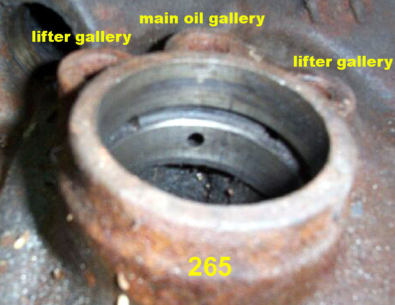

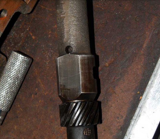

    This really only applies to 55-56 265 Chevy's! They had pulse oiling to the lifter gallerys [1957 went to constant flow]
    Here is a 265 block showing the main feed and the 2 lifter gallery feeds in the groove. [Compare this to the 327 block I showed earlier]
    The rear cam bearings have 2 holes, 1 hole is over the main oil feed and the other hole aligns with the groove.
    There is a notch in the rear cam journal that allows oil to go in 1 hole and out the other.
    The rotation of the cam makes the oil flow in pulses.
    It is very easy to convert a 265 block to constant flow and use late cam bearings [or earlier as well] and any post 1957 camshaft.
    That doesn't matter [The early dizzy is only on 55-56 265 Chevy's with pulse oiling]
    You can put a 57 and newer dizzy into a 265 because they are splash oiling.
    But if you put a 265 pressure feed dizzy into a 57 or newer engine [with constant feed] you will end up with oil in the dist cap
    The 265 dizzy needs to be clocked to allow for the drain back, if you get it 180 deg out you dont get oil pressure to the RH lifter gallery.

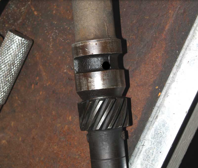

    This is the bottom of a 265 Dizzy. The hole is the pressure fed from the RH lifter gallery and the groove only goes slightly over 180 deg around the housing [enough for timing the engine]
    This is the drain-back side [with the oil drain hole above] The flat side must not go on the lifter gallery side or the RH gallery will have oil pressure issues
    This is a 57 or newer dizzy.
    The groove goes 360 deg around the base , there is no oil feed holes.
    The shaft and bushings are splash oiling. [reliable enough for 65 years]

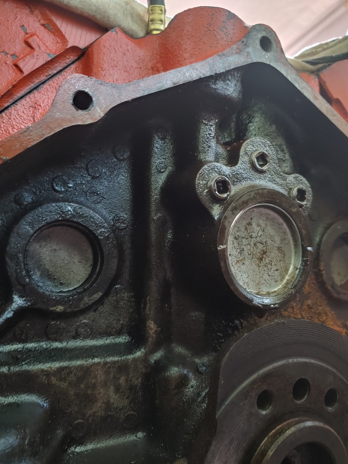

    Well i pulled the trans. I need to pick up a square head tool to turn those plugs out out. They look like they have been tampered with in the past but they dont look to far in, or maybe they are idk.. Maybe i can poke around & figure it out back here ... If not I'll pull the front apart & remove the cam, knock out that big center plug & check the bearing..... I guess.

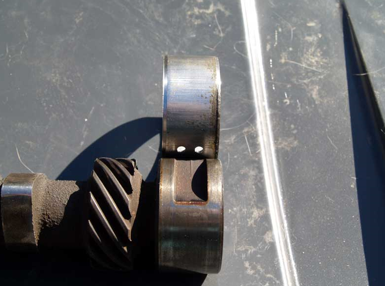

    I've seen the rear cam bearing not driven in far enough (driven from the front) and it left the oil groove 1/2 exposed. Massive internal leak that didn't oil the lifters, just sent oil out of that groove to behind the end of the cam, up against the rear cam plug, then out through the two relief holes drilled in the last cam journal and right back to the oil pan.
    The bearing was driven in flush to the front edge of the main bulkhead (like the #1-4 bearings are), leaving the rear of the bearing not covering the oil groove. Drove it back another 1/4" and everything was then fine.
    It's not going to be anything at the front of the cam/timing set area....because missing plugs there just lower the pressure, since they are missing right at the very end of the oil system.....everything else gets oil first before it gets to the front plugs. Leave those plugs out and everything still gets oil....just no or low pressure exists. Volume, but no pressure.

    Those gallery plugs do not look like they are screwed too far in.

    They look OK and also look Factory installed.

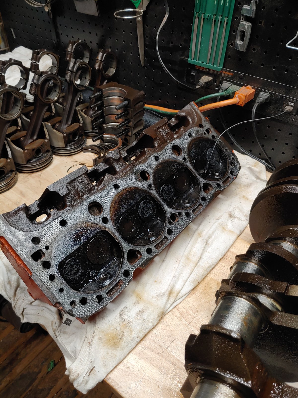

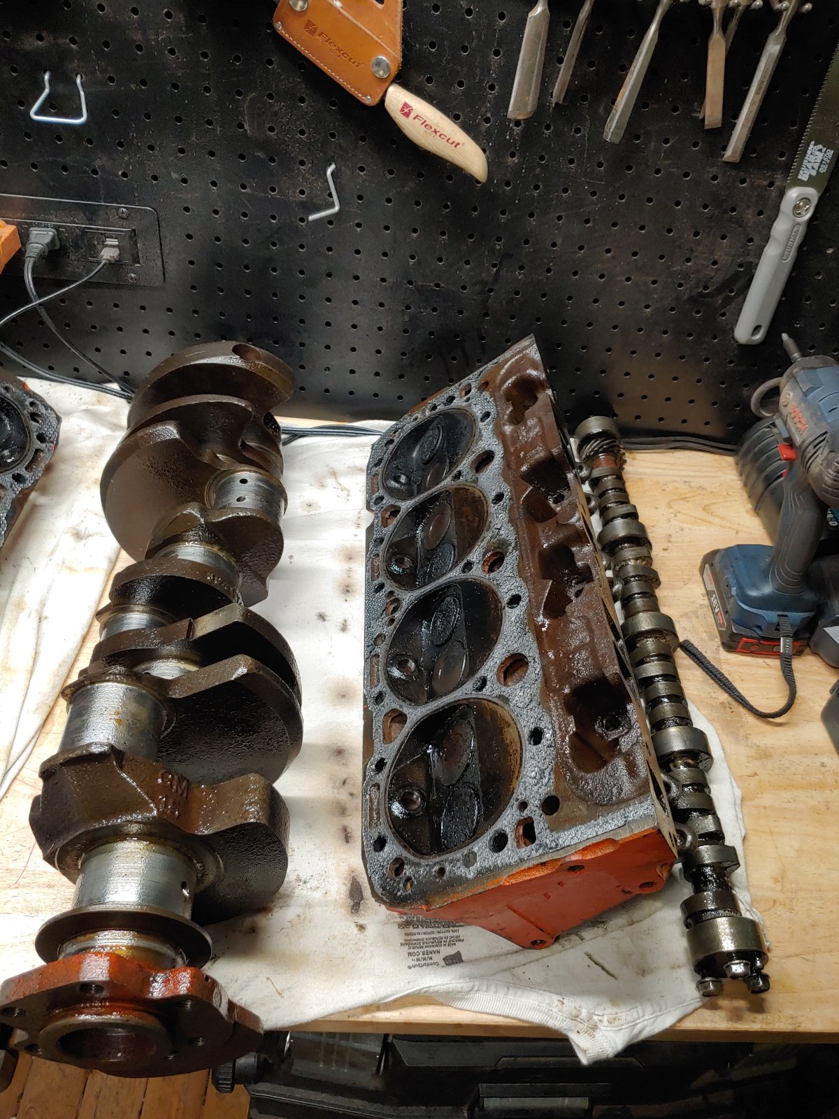

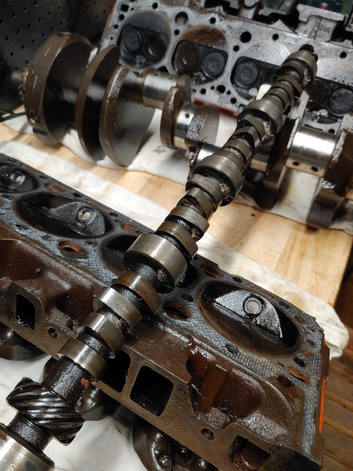

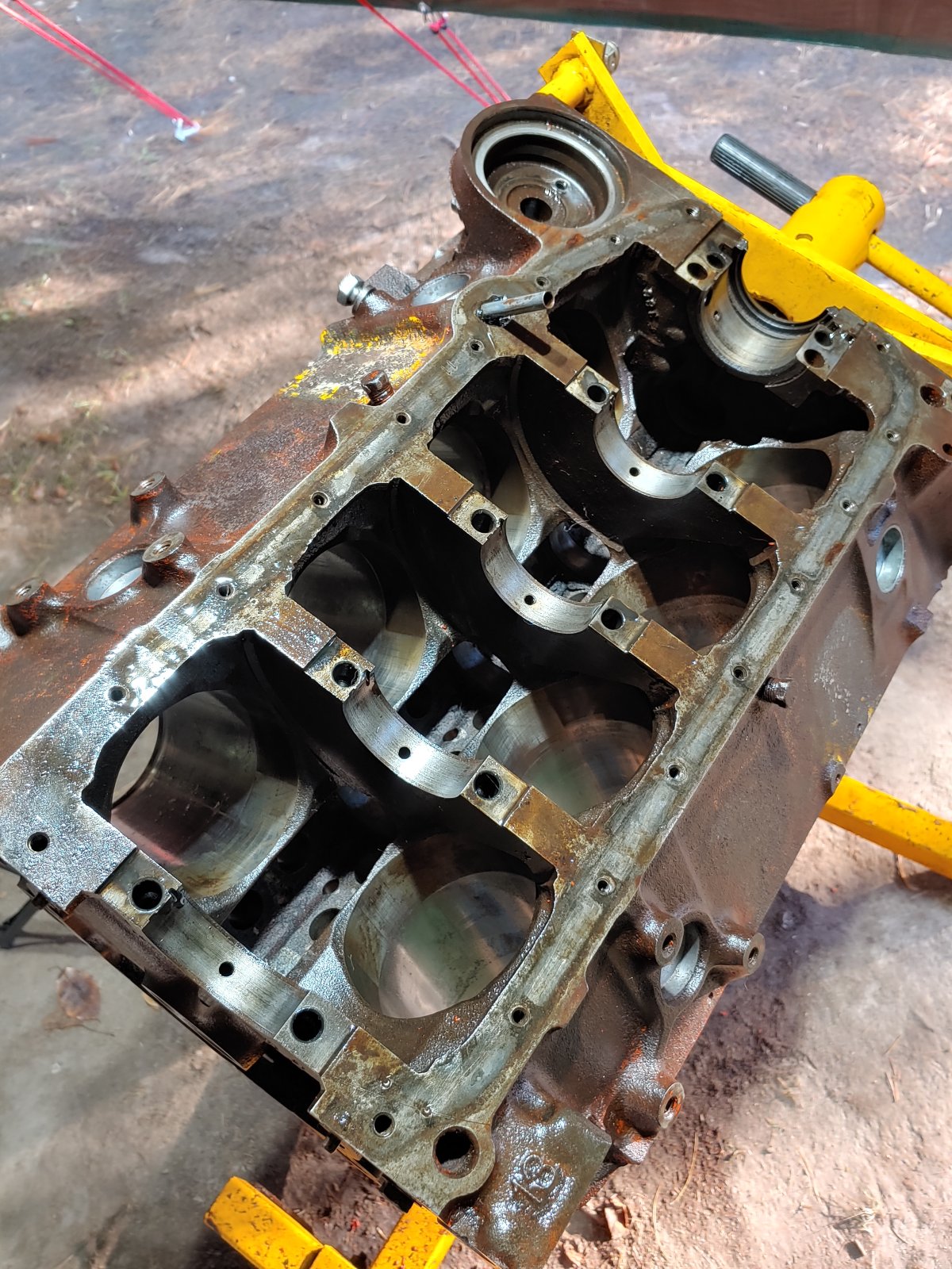

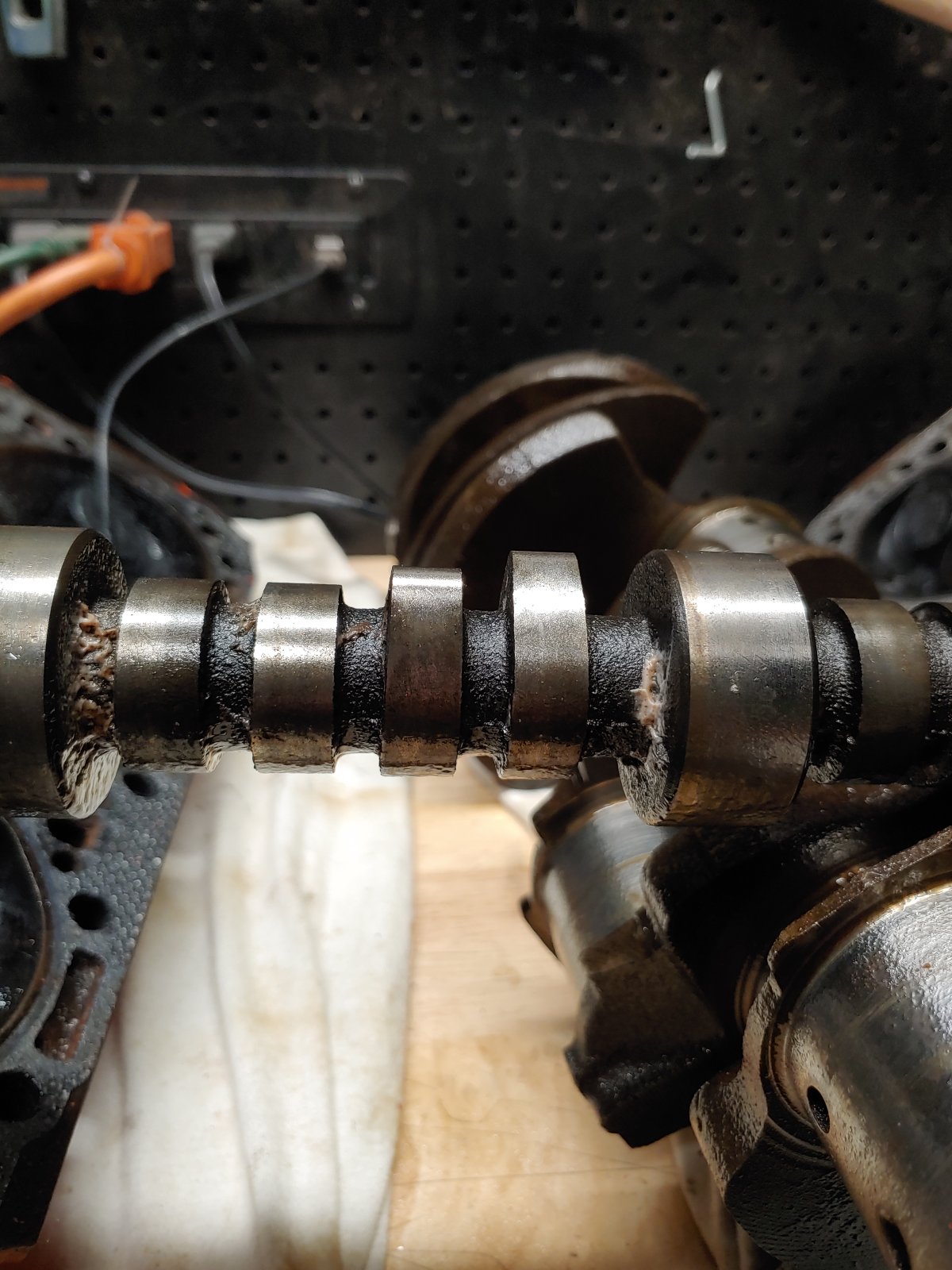

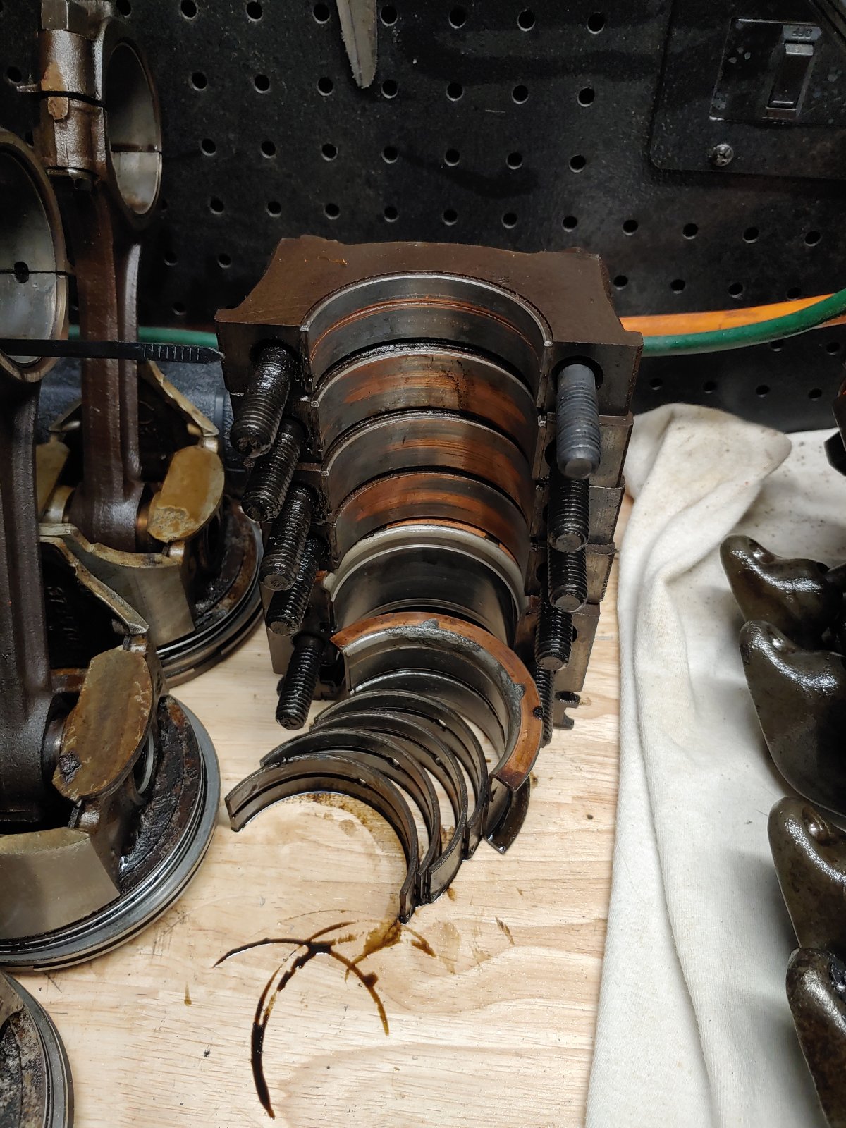

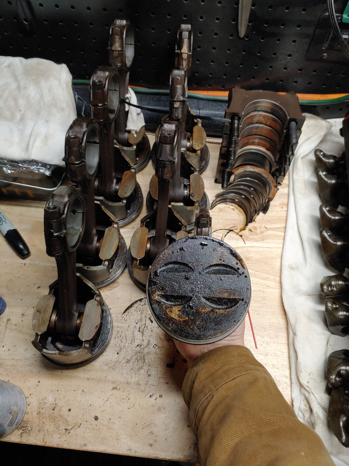

    Well she's all taken apart ( minus oil galley & freeze plugs and the cam bearings) this is my first engine build so any advice is appreciated. I'll post a few more pics & some issues i found.
    1Nimrod, Deuces and Blues4U like this.
  30. Beng87
    Joined: Oct 31, 2022
    Posts: 40
    Beng87
    So 7 pistons had messed up oil rings... Two of the rings just came out in pieces in my hand. One piston was cracked... That would explain the excessive smoke when i had it running i guess. I think the cam looks ok but I could be very wrong. I will post pics of the rear cam once i get that plug out. Assuming thats where i had the oiling issue. So I've got a ton of research to do to figure out what to replace. I'm going to have to write out a game plan
