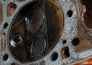

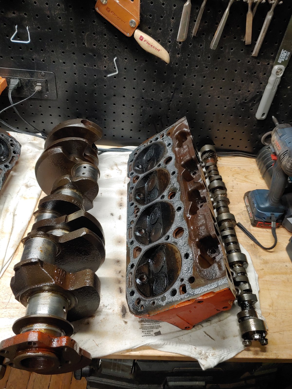

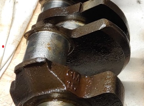

  1. This can't possibly be the finish on this crank. No way. This picture is lying. It almost looks like the entire crank has condensation on it. I don't believe it. How could it get this way and still be rust free? I do NOT know what I am looking at but I know what I see is NOT what it is ... it can't be ...
    Frozen condensation ... yep ... that is/must be what I am seeing.
    I do NOT think this engine is anywhere near as bad as the pictures seem to show. I wonder if the OP dropped his camera in a vat of Vaseline before taking these pics. There is NO WAY all the journals on that crank look like what we are seeing in the pictures ... not a chance. If this thing was close enough, I would love to see it in person.

    With the crank out of the engine, stand it on the flange end on the shop floor. Take a handy end wrench or ratchet handle and give it a quick rap on one of the counter weights and give it a listen. If it goes "diinnnngggg" like a bell it's forged. If it just goes "clank" or "thump" with no ringing sound, it's cast. Dropping a larger forged wrench on a concrete floor will give you a sample of the "diinnnggg" sound of a forging.
    Beng87 likes this.

    The crank pick looks like a blow up of a close up. The parting line looks like a ¼" patch vs a split. Number looks like 3996.

    Nothing was cast in Flint. Blocks were cast in Saginaw, Tonawanda and Defiance. This was Machined and ***embled in Flint. High possibility it was cast in Saginaw

    Without a doubt, that crank is cast.

    Same.

    1948 is correct, built, not cast. Hope bore's are stock or just.010" over, .030" could save it, .040" if need be, .060" over could get thin in spots and run on the hot side, both of my 337's required larger radiators.

    Not condensation! I sprayed EVERYTHING down with wd-40 ... Before i took the pics. This is my first time and i wasn't sure what would rust and how fast.. So i sprayed it all down...
  13. Now that makes some sense then.
    If the block truly has minimal ridge then I'd say it is usable. Before sinking any money into this unit though, you need to find out why the oil wasn't making it to the top ... I would say you need to focus on the position of the rear cam bearing.
    Once you determine why the lack of oil (***uming it is something obvious and not terminal), find yourself another piston, get some bearings and a gasket set and get this baby back together.
    Beng87 likes this.

    I didn't do any cleaning tho. Just took it apart and sprayed everything with wd-40.

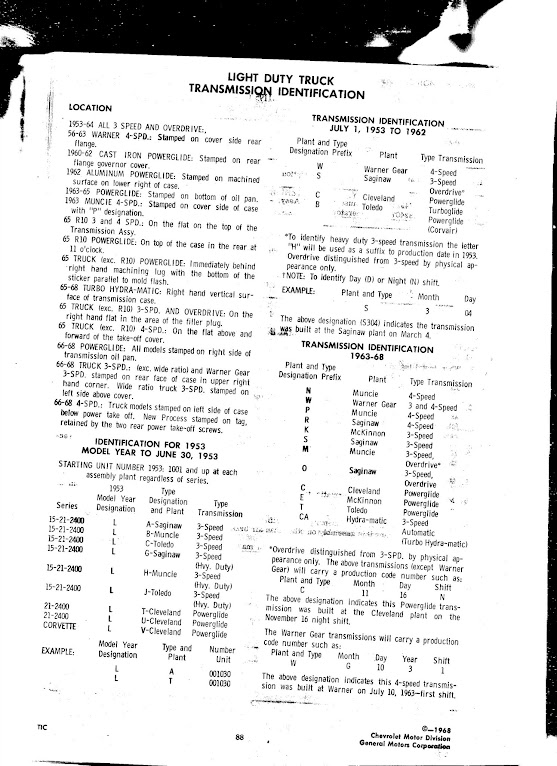

    I will check tomorrow on that number and let ya know. ..and i am not sure what you mean by powerglide A/T... The transmission im guessing? If so its a 3 speed manual. Still learning lol

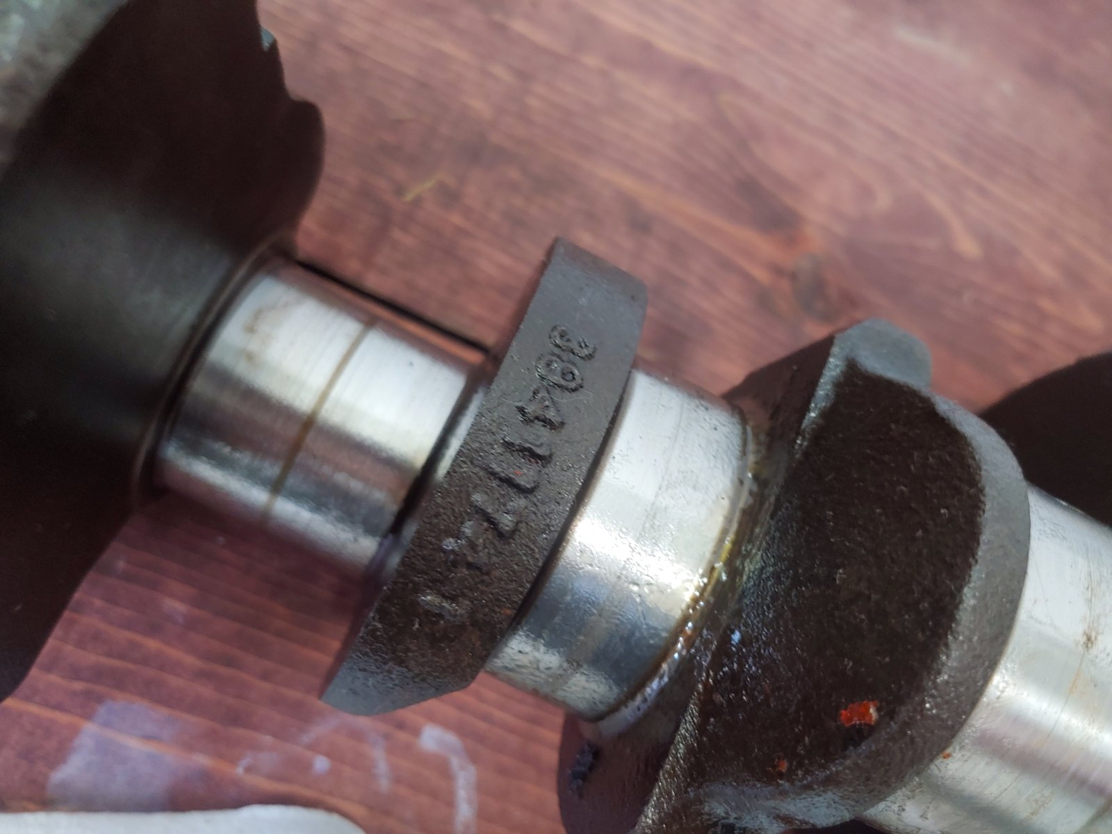

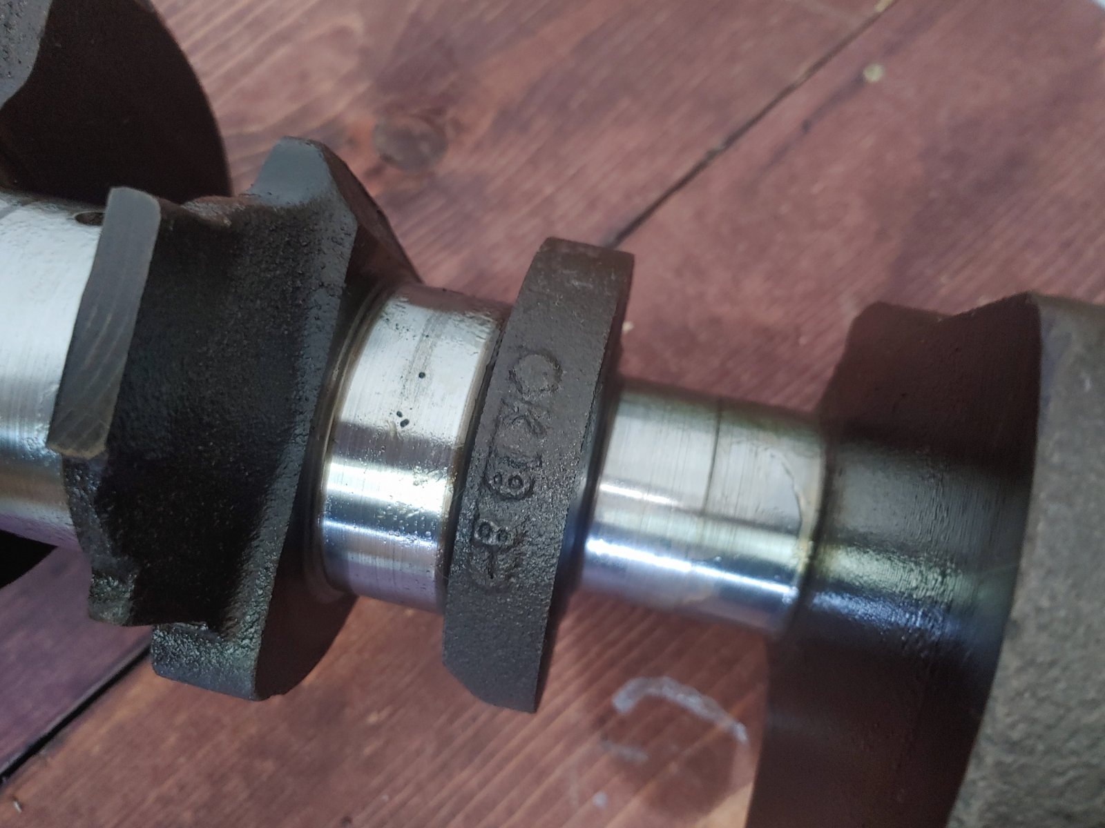

    I will get a pic of the crank casting number too.

    I bet it's 3941174

    Yes the Powerglide was a 2 speed automatic transmission

    1965-68 Turbo-Hydro Matic was first in 1965...

    But not the 350

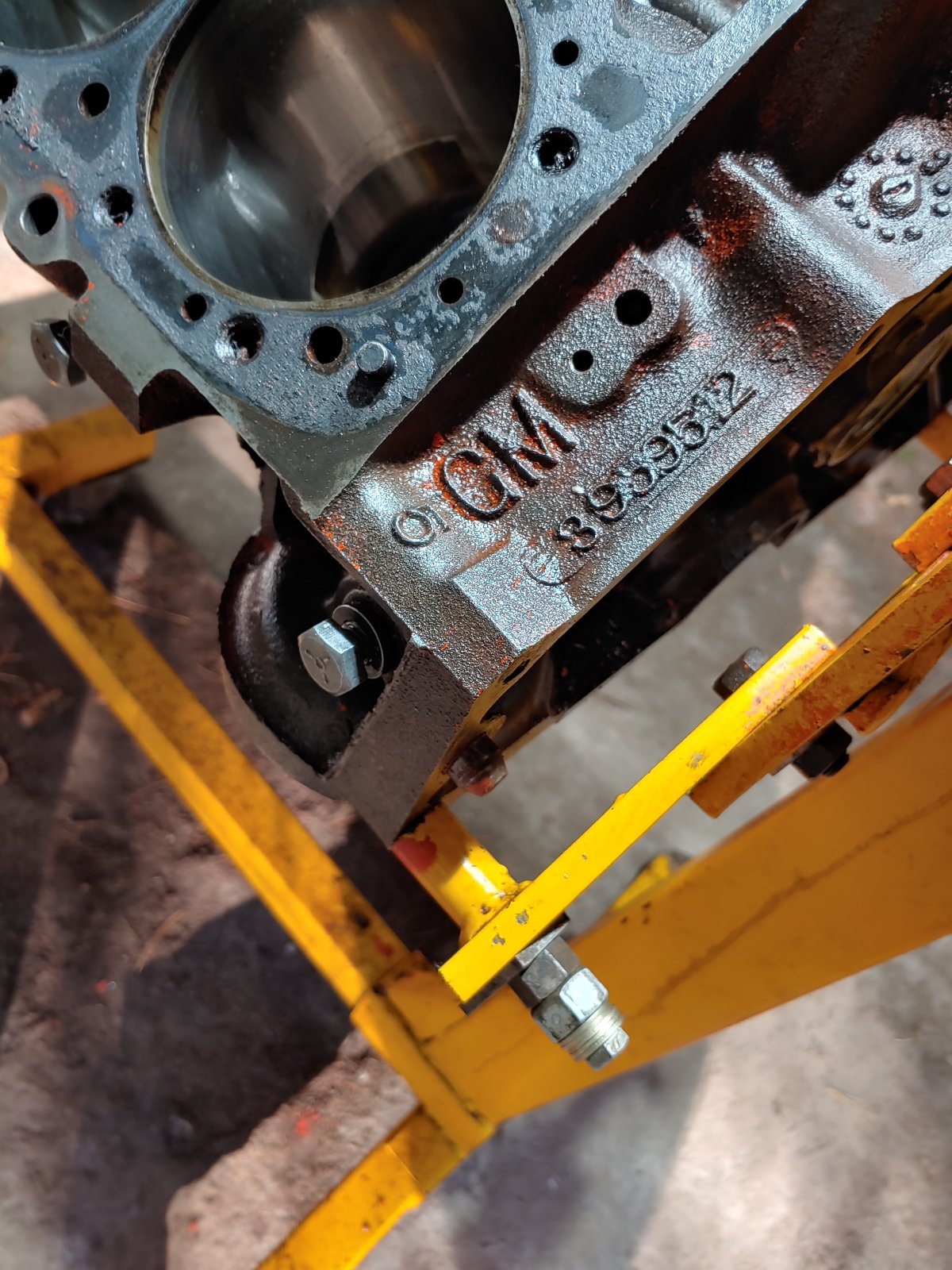

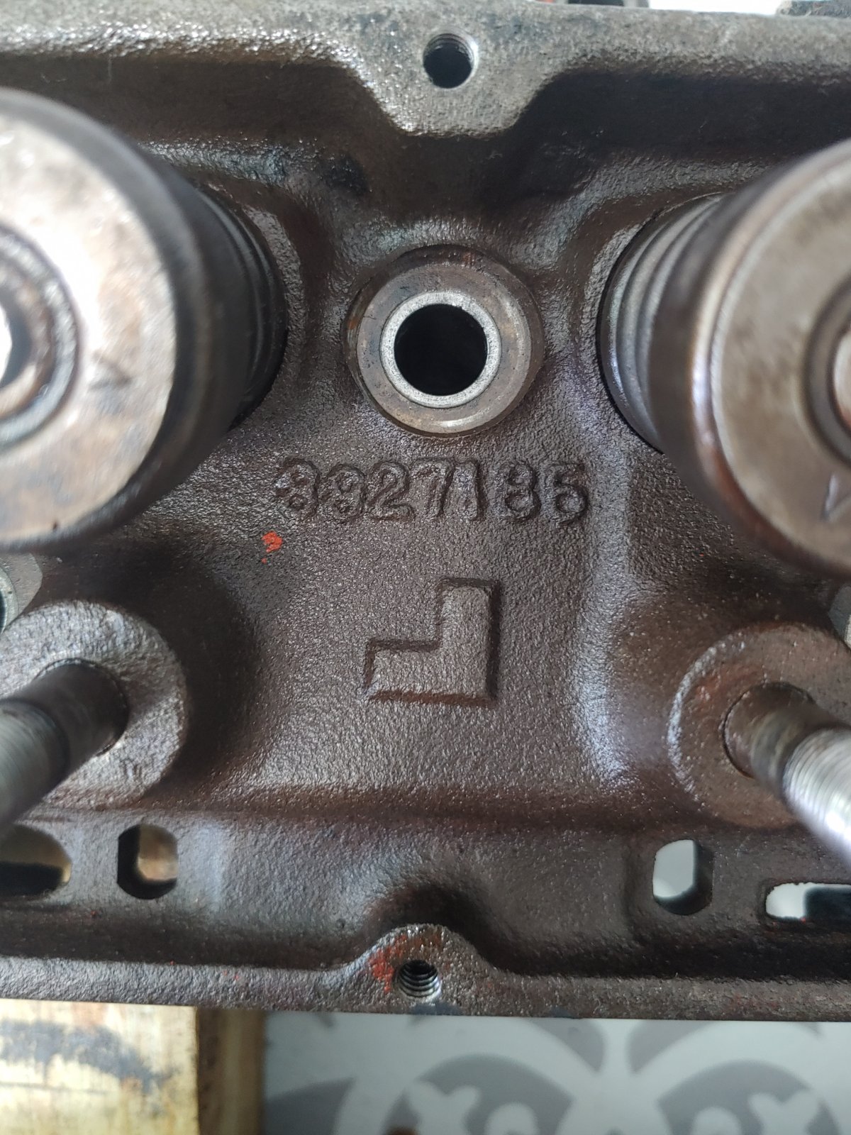

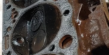

    Well i haven't gotten around to messing with the block again yet. But i got some pics of the head #'s and numbers off of the crank.
