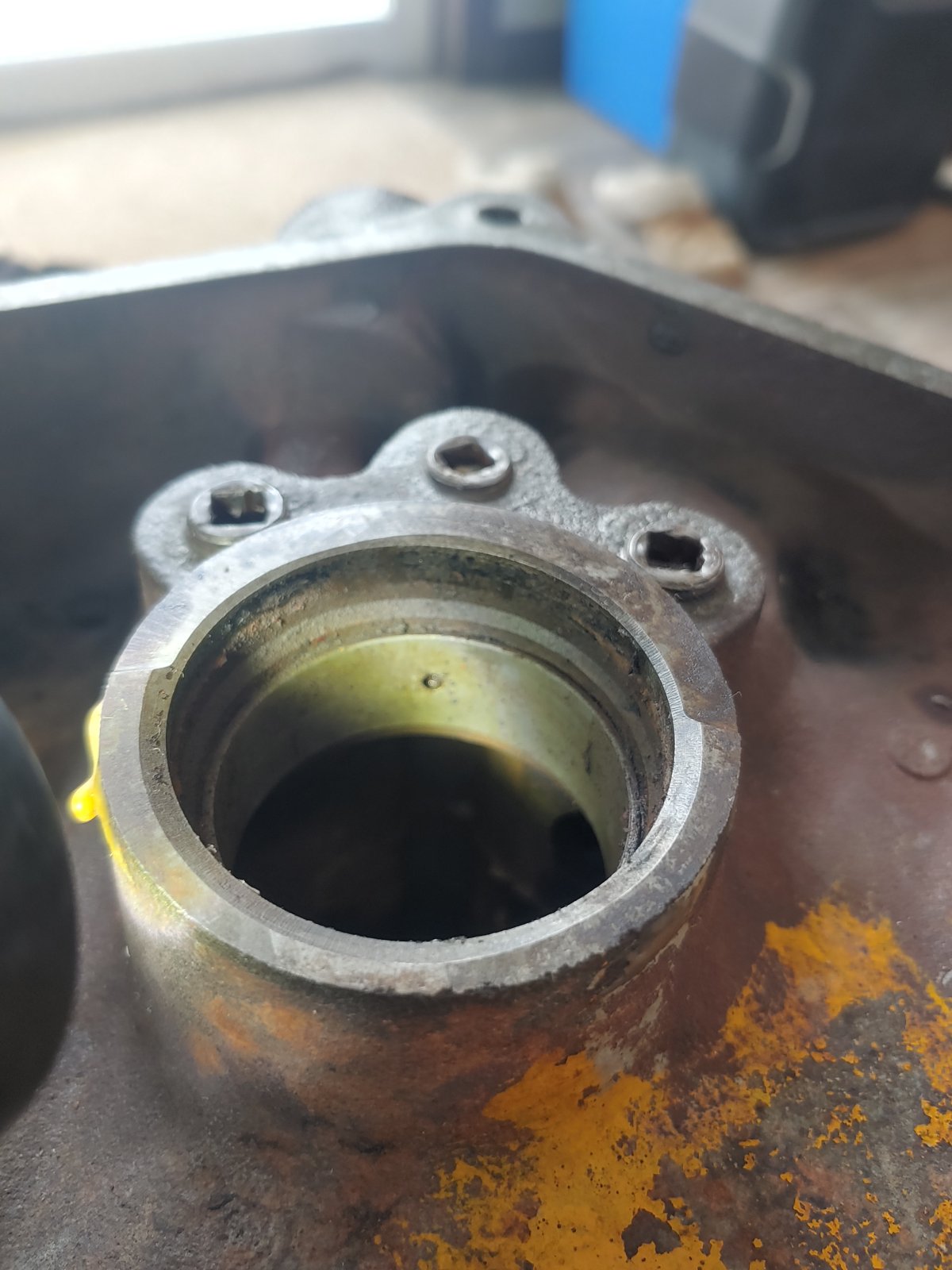

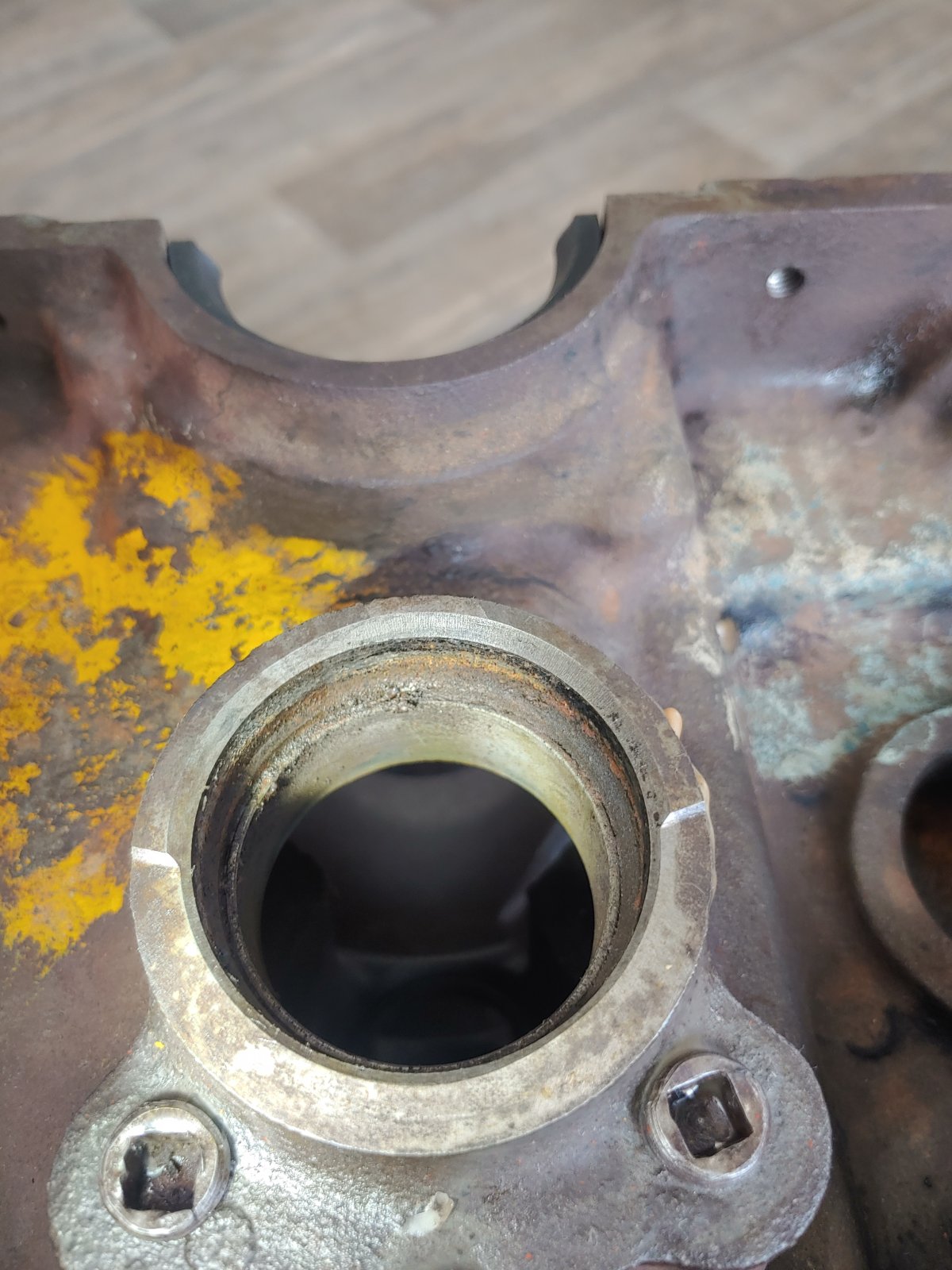

    20221116_131455_HDR.jpg 20221116_131455_HDR.jpg 20221116_131512.jpg well i got the plug out. Need to get the cam bearings yet. And those little threaded plugs. Which someone has definitely messed with before... Gonna have to torch those i would imagine.
  2. Why torch the rear plugs ?
    They usually come out fairly easy .

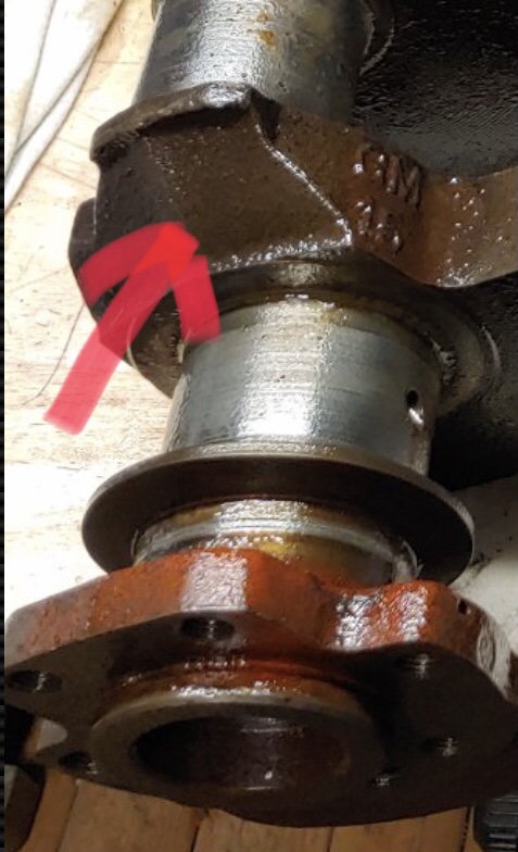

    Worn for sure I will show you tomorrow how to take measurements . Good pictures have a nice evening

    These wont budge. You'll turn that square hole round first I'm pretty sure.

  25. Beng ,
    What kind of tool are you using in that square hole ?
    The tool should break before you round off the corners,,,,,that’s why it’s square .
    The hole must be clean,,,,and the tool fully inserted before turning .

  30. Before you pull the cam bearings, make sure, or have machine shop check if you're unsure, that the rear cam bearing is positioned properly. That's one of the steps to determining your oil pressure to rocker issue. If it wasn't in the right place, you've figured out your internal oil leak. If you start taking those out, without checking, you'll never know.
