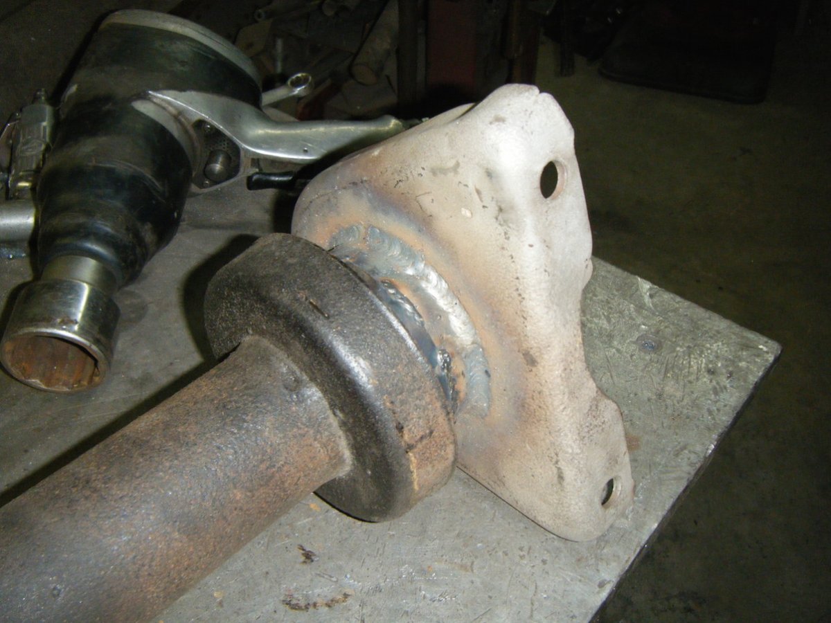

    it looks like they had to move the crossmember forward when they put the v8 in. they used a hurst stile mount in the front and the later v8 bell housing, this is what pulled the drive shaft forward. DSCF4663.JPG DSCF4664.JPG

    i cut off the tube that the rubber/bearing mounted to and made a new one with my slip roll and welded it in place. i then cut the backside off so the u bolts would not hit, like they did. this should work.
    new u-joints coming tomorrow.

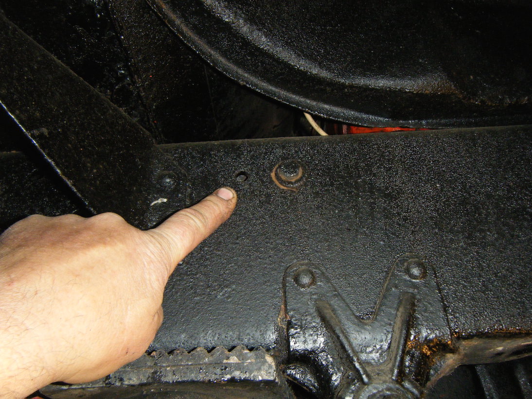

    another problem i found was the cross member only has one bolt in it. there are holes, but no other bolts. DSCF4665.JPG DSCF4666.JPG DSCF4667.JPG DSCF4668.JPG

    i am pointing to the original rivet hole and that bolt is in the new location.
