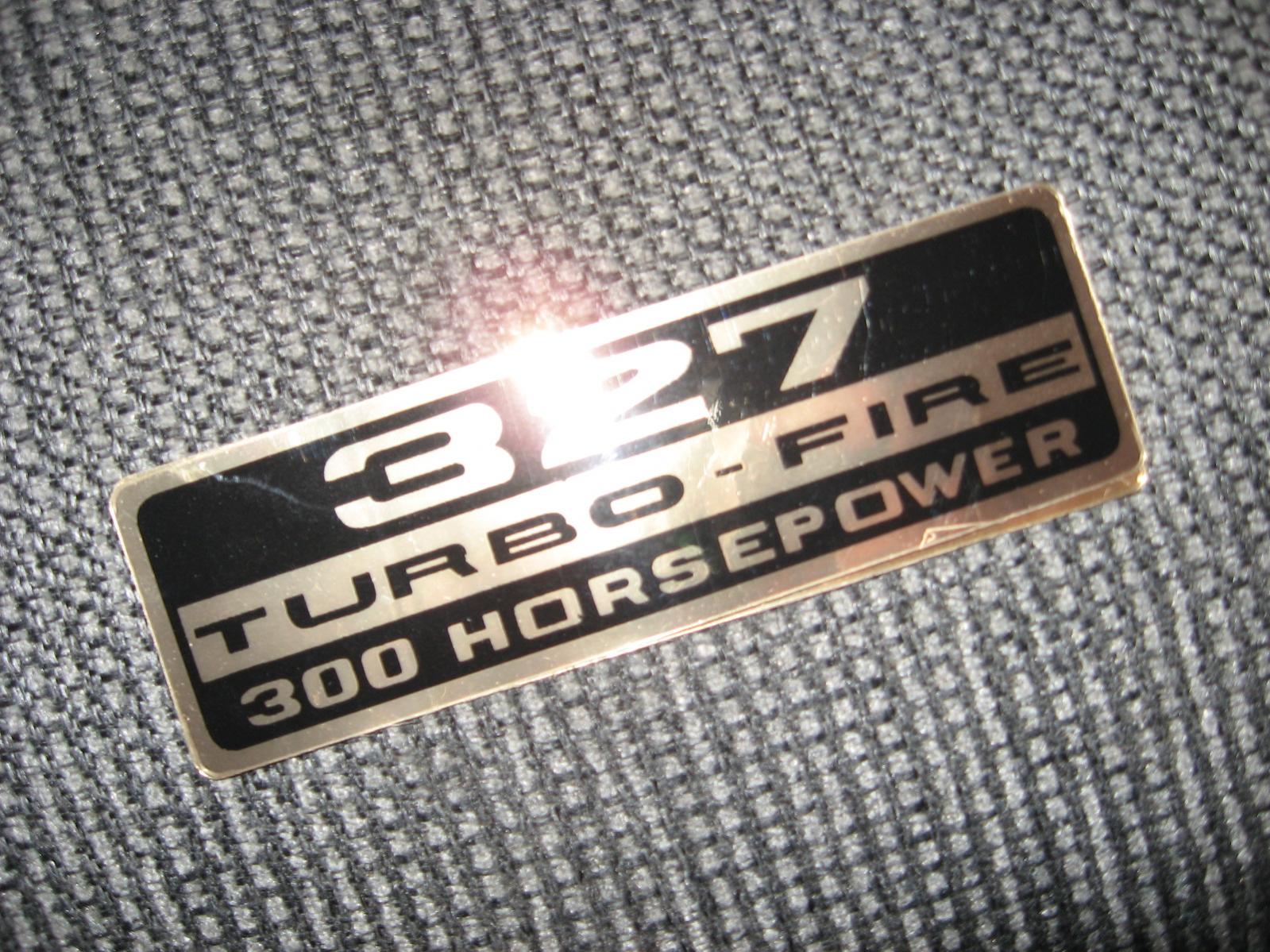

    from Troy, MI
    I think its a good choice. IMO though if you want a traditional car, make sure you pick the right dress up items, especially if the engine is exposed. I love the stock Chevy stuff myself, but there is an abundance of traditional aftermarket stuff out there too for SBC's.
    My 327 is built pretty much like a 300 HP '62 version with the 461 1.94" heads. The only difference is that it has the WCFB carb and intake on it instead of the AFB. This kinda makes it a cross between a 250 and 300 HP engine.
    If you build it like a '62 you can still run the generator and have it look right. I believe '63 is when the alternator came out.
    From a power standpoint its hard to beat a SBC for the great packaging (especially in a Model A engine compartment) and the relatively low weight it provides. I built my engine mild because of the rest of the driveline (old closed driveline Ford stuff). It still really scoots!!!
