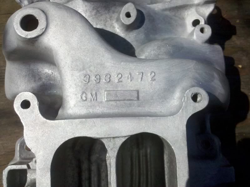

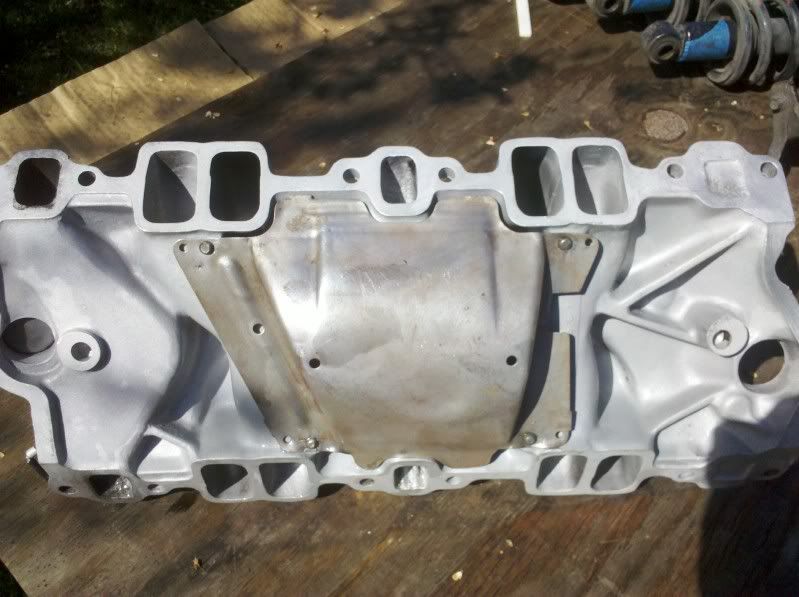

    Just so you are up to speed, the arrow in the attached photo is pointing at the plenum divider. It should appear as you see it in the photo. If it is cut down much more than 1/2" it may not be the best intake for your particular situation. If the divider is intact, the holes arent all stripped out, and the price is within reason, I would say snap it up.

  6. Nice intake. What's he want for it?

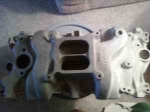

  12. Way too much unless you want it for a factory application. I see and buy C-3BX's and C-4B's regularly for $100 and under. As little as $25 for one needing a bunch of little detail work and heli coils. What's yours needed for?

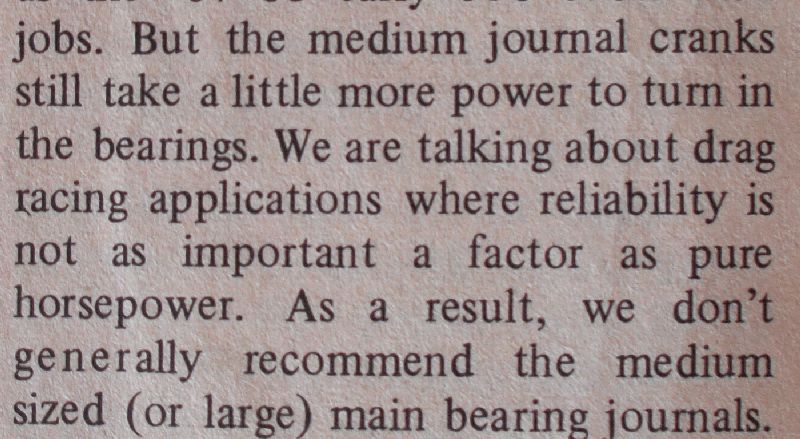

    I am so glad I joined the HAMB. Here all these years I have been believing this ******** in this article that Jenkins wrote back in the early '70s on block selection. Not to mention the thousands of NASCAR and Comp elim. engine builders that have been building small-blocks with honda rod journals for the last two decades.

    Made the guy an offer on the Z28 intake and after a few days, he bit. Gonna pick it up this weekend.

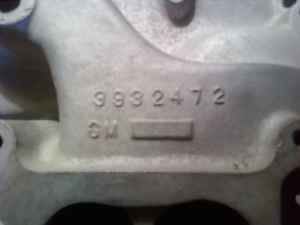

    So I'm going to pick up the 69' Z28 intake this Saturday. Anything special I should look for? Any special markings? I know to make sure there are no modifications to the plenum. Anything else?

    Got a casting number?
