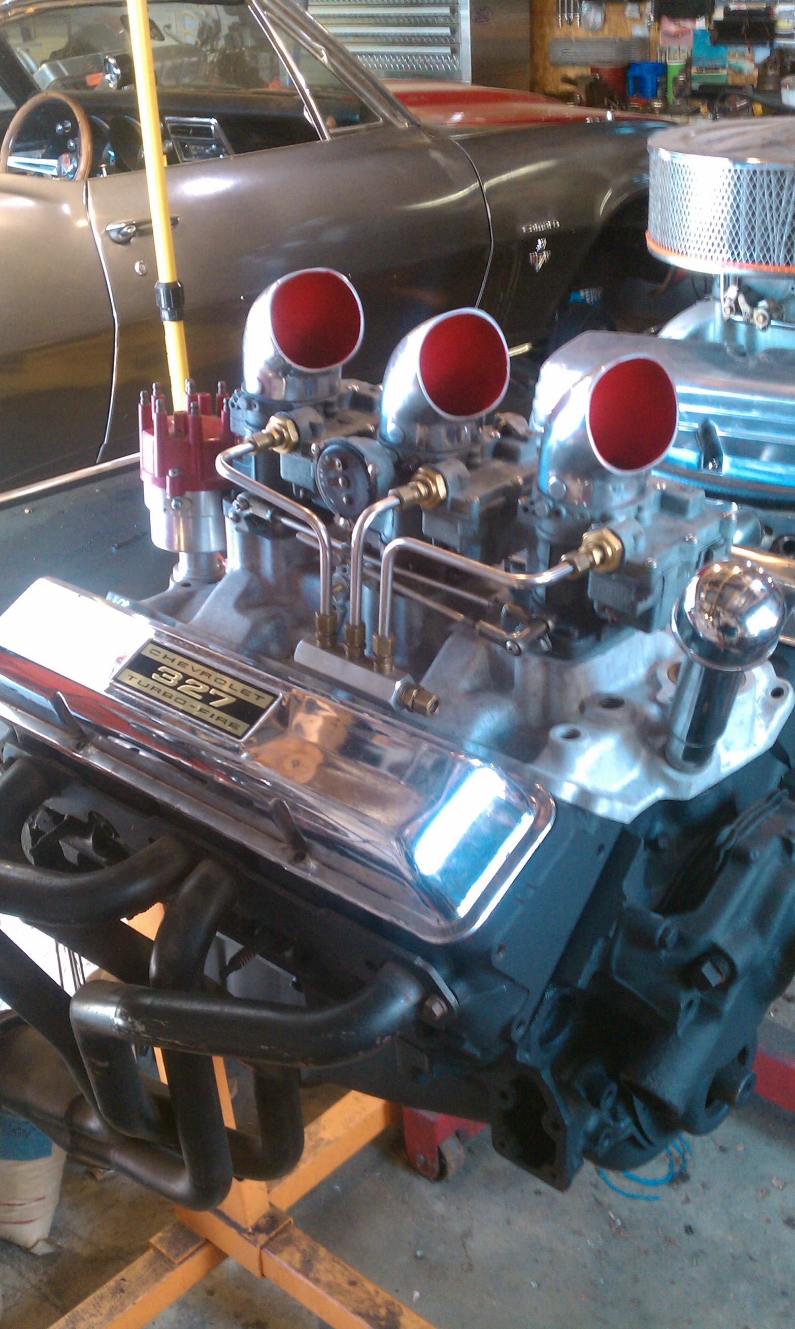

    this post is still going, I'll help, not a 327 but I love the valve covers!

    roaster, who built your tri power, looks a lot like the one I have on my '60

    I did, with a lot of help and "google", all I need to finish is six jets from walker products (55s-56s)
