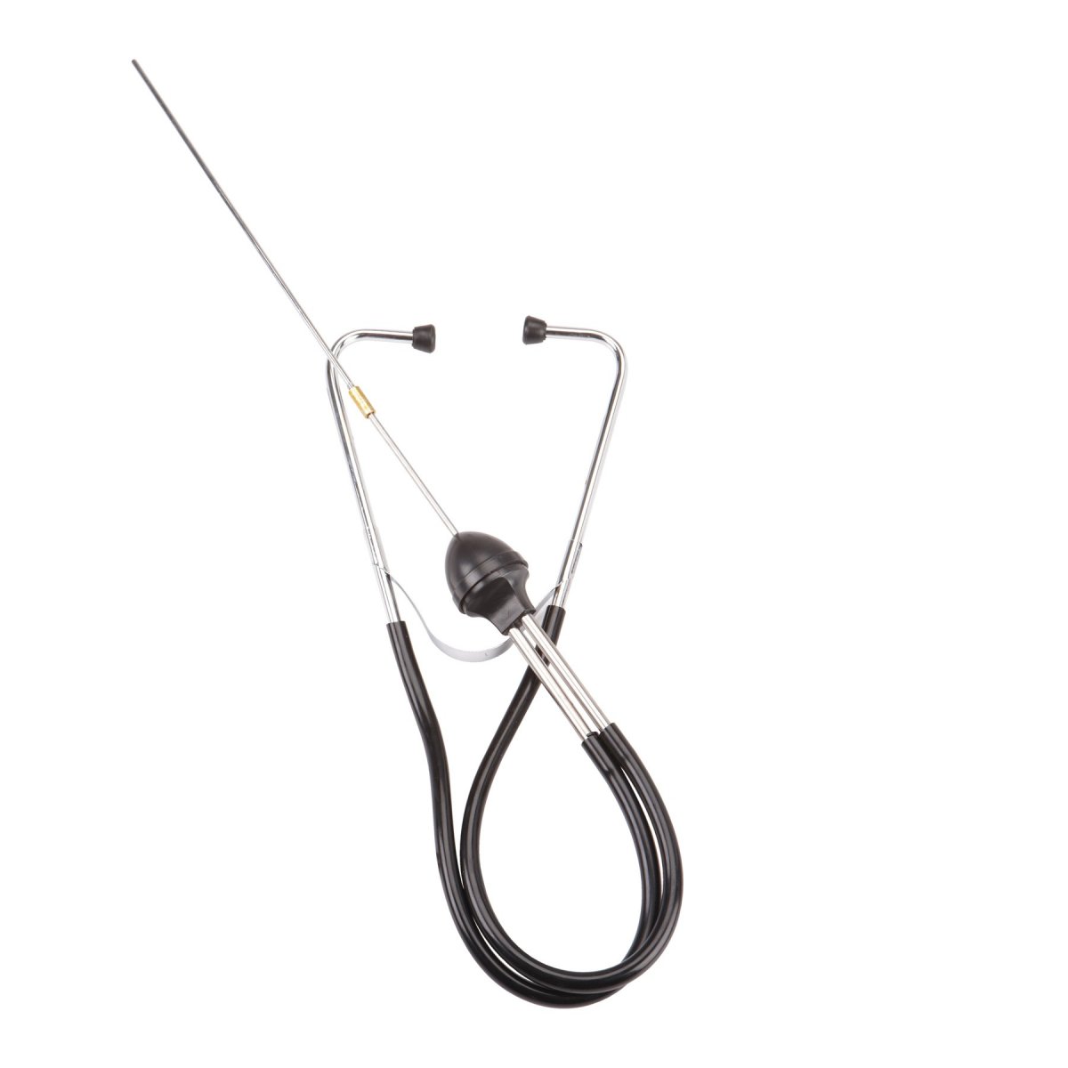

    Old mechanics trick. Take a hose and hold it up to your ear and start chasing the noise around. Keep your hands out of the fan!
    Early Ironman and els like this.
  12. Bad Eye Bill
    Joined: Sep 1, 2010
    Posts: 841
    Bad Eye Bill
    from NB Canada
    Yep, that'll work. I prefer these though, you can get them pretty cheap and if you happen to touch a moving part you won't get stabbed in the ear.

  17. Happydaze
    Joined: Aug 21, 2009
    Posts: 2,482
    Happydaze
    I got one of these a year or so ago. I can't recall whether there was a particular issue i was chasing down but I've used it many times since. Amazingly sensitive - totally different from a dowel or socket extension. You can really hear what's going on and it's interesting to just listen to things for the heck of it! It's surprising to find how quiet most things are - water pumps, rockers, superchargers - does kinda make you wonder where the noise comes from! That'll be the combustion / exhaust I guess. Excellent tool.
    Chris
    els and czuch like this.

  21. slowmotion
    Joined: Nov 21, 2011
    Posts: 3,914
    slowmotion
    Like mentioned, get these:
    With the mention of new parts installed, I'd also be suspect to a ****ty lifter. Taking into account the quality of some of these 'new' (read off-shore) parts.

    I would get the stethoscope and start listening....
