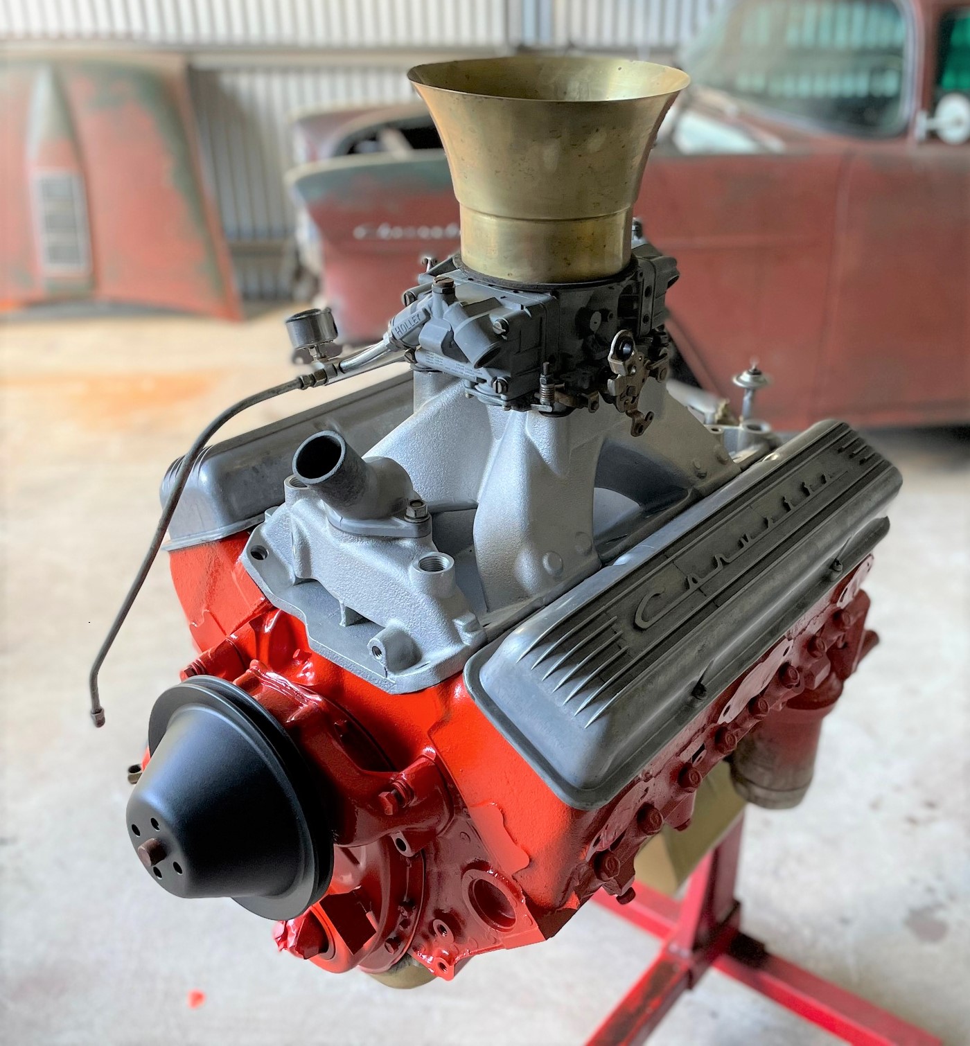

  1. jugheadjones
    Joined: Jun 6, 2011
    Posts: 182
    jugheadjones
    That is an option as I do have room. Is there any issues with the breather / filler tube to sitting low in the valley? As in, filler tube just high enough to fit a breather. Apart from it being a challenge to adding oil in.

  4. jugheadjones
    Joined: Jun 6, 2011
    Posts: 182
    jugheadjones
    And If I put the original road draft oil separator canister back on would I get away with not doing the PCV conversion? That way I’m simply adding a small tube / breather to the intake.

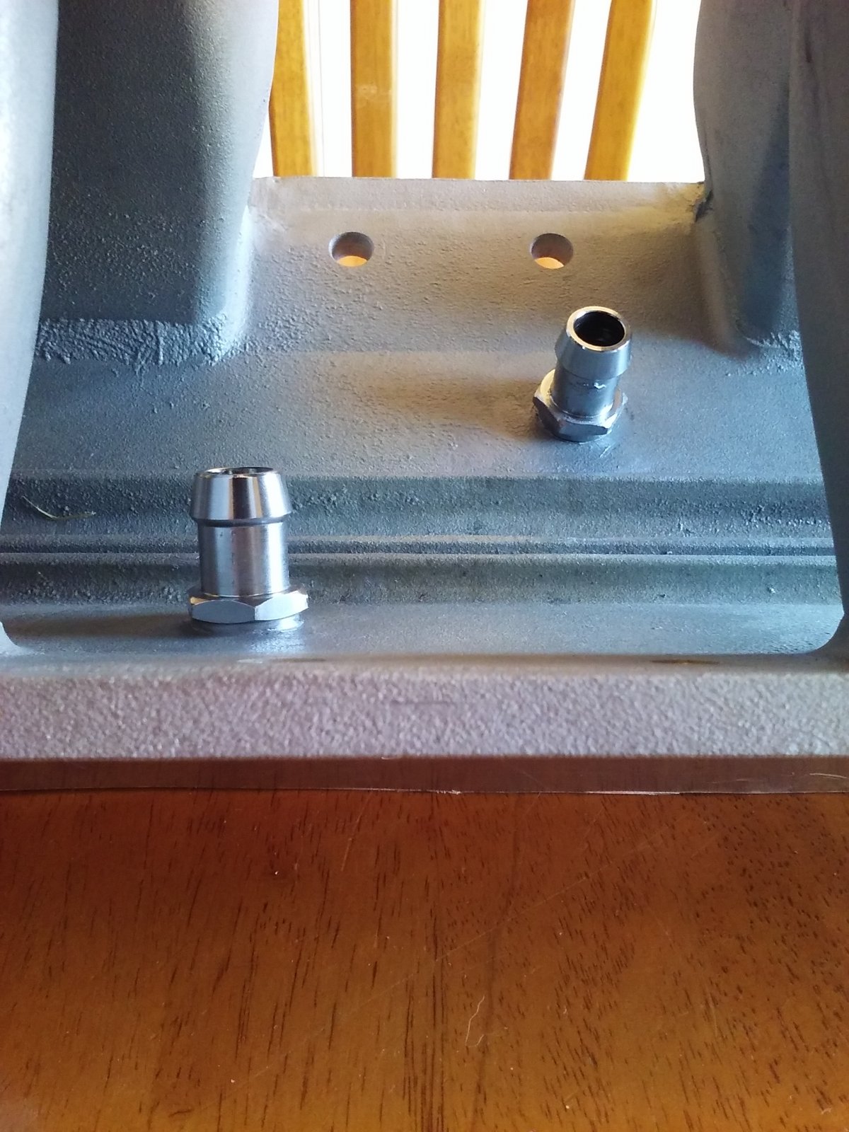

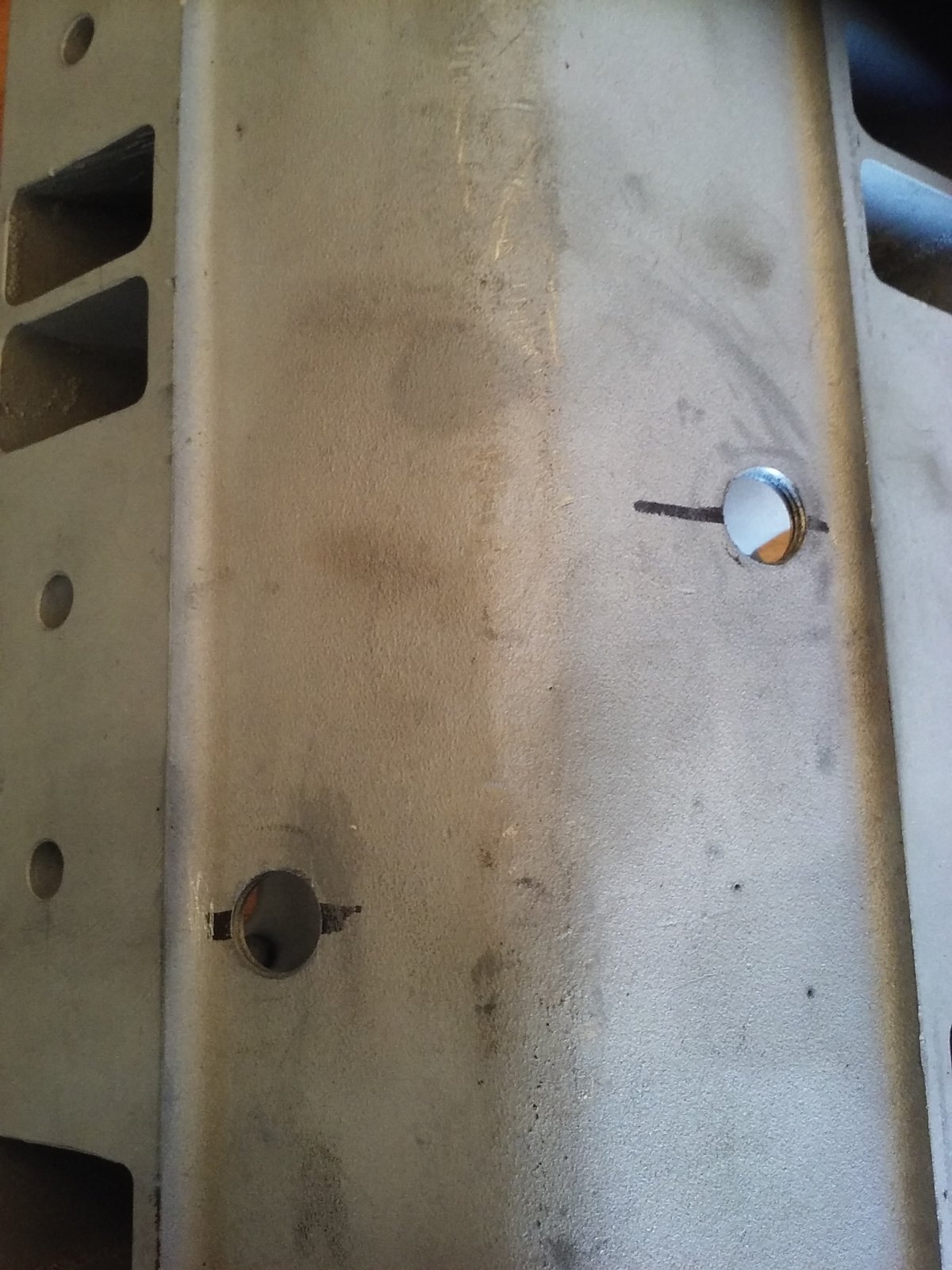

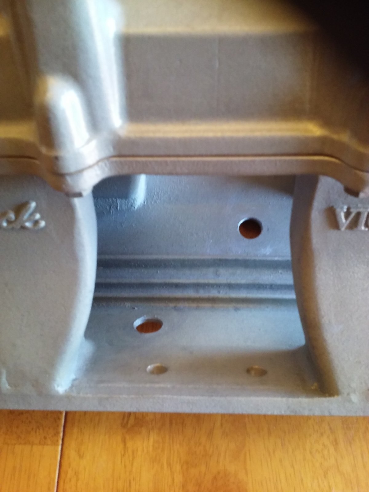

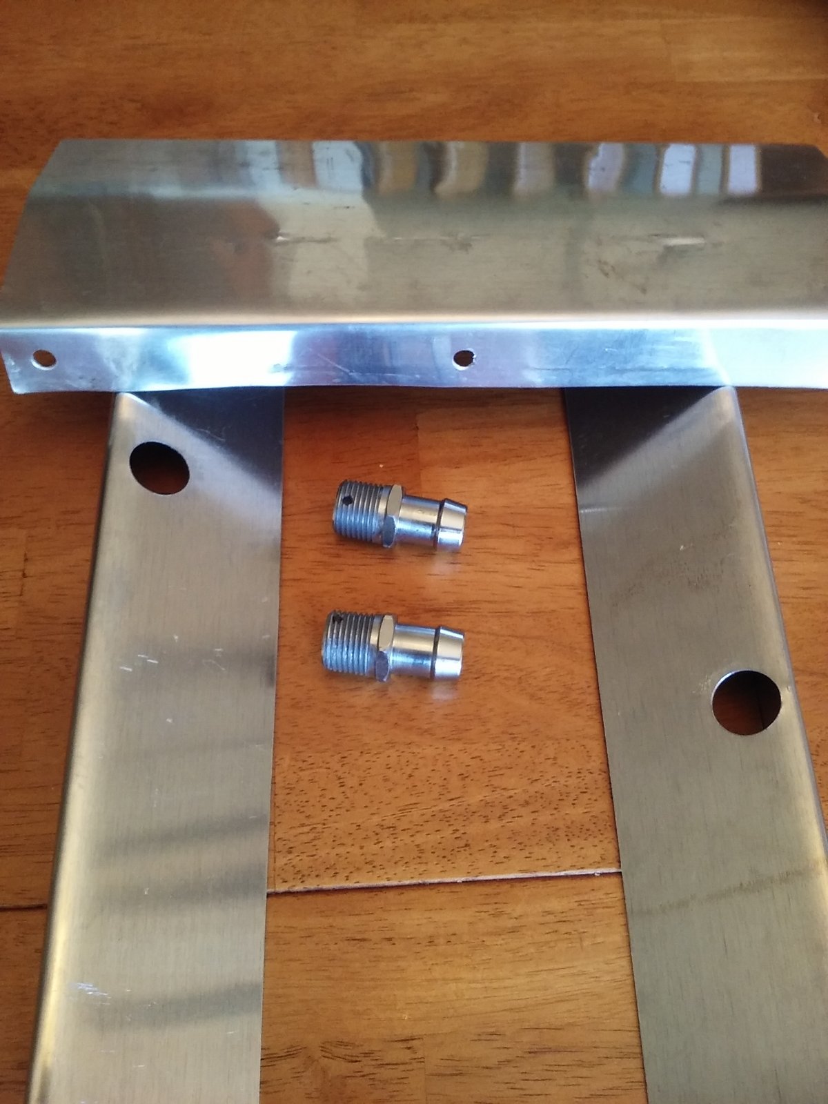

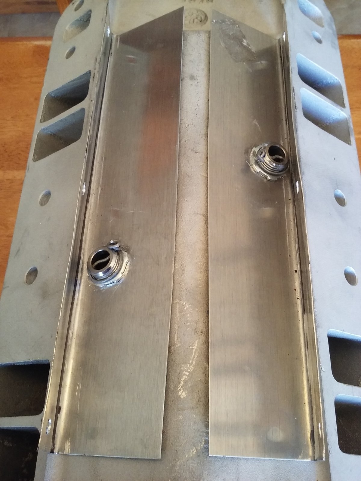

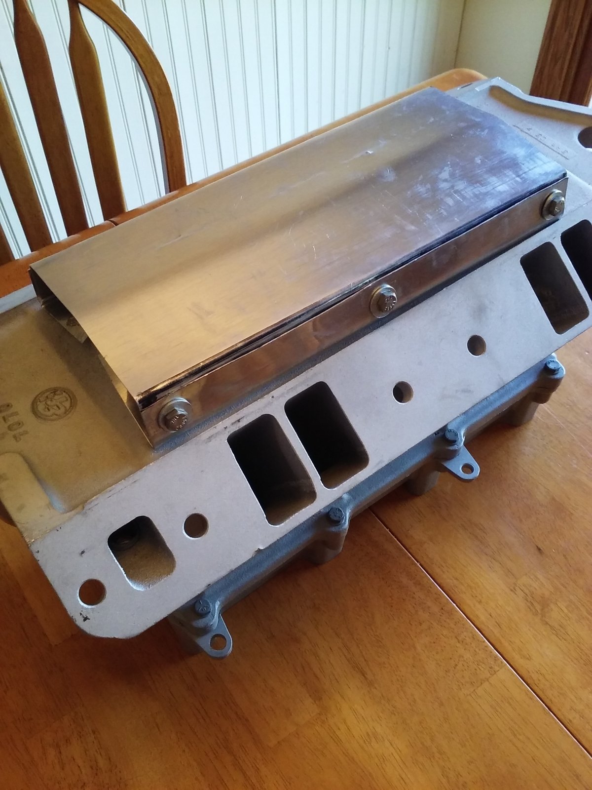

  10. Tickety Boo
    Joined: Feb 2, 2015
    Posts: 1,763
    Tickety Boo
    from Wisconsin
    Your most likely running headers for race use so check out a header crankcase evacuation system like #ALL34145, drill and tap your intake for water pump 5/8 hose nipples, you don't have to molest those valve covers.
    Install the supplied breathers or a oil seperator canister between the intake and the header.
    Got some pictures of how I drilled and tapped my tunnel ram intake along with making a baffle to keep oil from being sucked into the headers at high rpm. :oops:
    I also had success using a Moroso lifter valley baffle #25050 if you don't want to make your own.
    20170328_133156.jpg 20170328_133117.jpg 20170328_133428 (1).jpg 20170328_135617 (1).jpg 20170328_135517.jpg 20170328_151756 (1).jpg

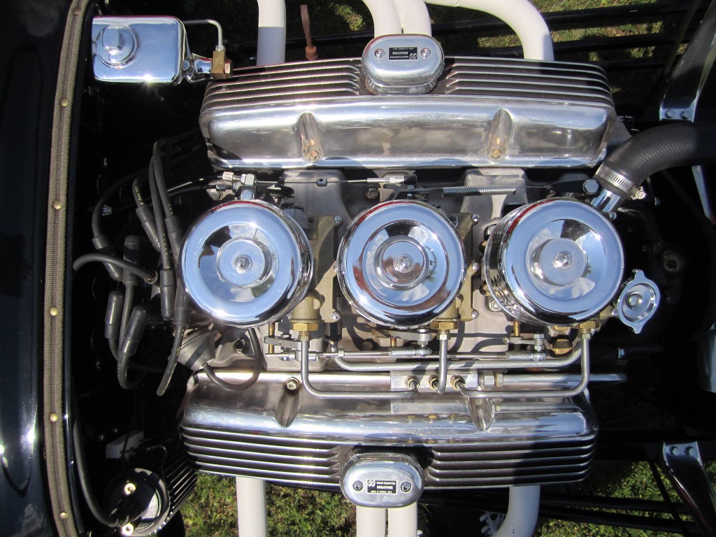

  29. I thought these Moon valve cover breathers looked OK; at least a bit better than the the quick & dirty hack job someone had done drilling holes for a PCV and push in breather right in the middle of the Edelbrock script. Little welding and some router "milling" brought them back to life. Anyway; the breathers let fresh air in and the Corvette style PCV in the sealed fill tube pulled it out.
    1Nimrod, clem, mvee33 and 4 others like this.
  30. looks great!
