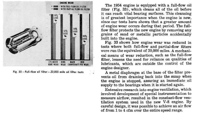

    I 1954 SAE Paper 540266 Ford discussed their new V8. The Y block.
    The attached image includes FORD's comments about the efforts they made on the crankcase ventilation system.
    I guess some might say they missed their mark because the Y Block had some sludge related issues (valve train?).
    But 60 years later manufacturers sometimes get it wrong even with much more effective Positive Crankcase Ventilation.

    Sometimes these old tech reports can make for some interesting reading. I was surprised to see that they found so much wear reduction at 20,000 miles or less with the full-flow oil filter.

    You need to remember they were coming from the flathead V8 to the new overhead and many engines had oil filters in external lines as byp*** systems. They also learned this with their overhead 6 a few years before. If Ford would have recommended and used detergent oil 99% of the p***ages to the rocker system would probably not occurred. All a moot point except for us who still use them today and have no need for outside oiling since we do.
    One other point the decal on my glove box door recommended 20 wt oil on new 55-56 Ford V8’s; I doubt that happened as many used heavier oil from their past vehicles and old habits die hard..

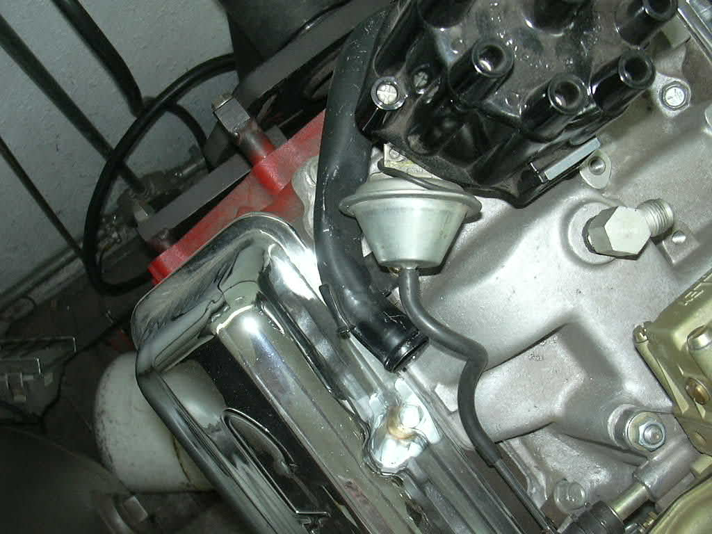

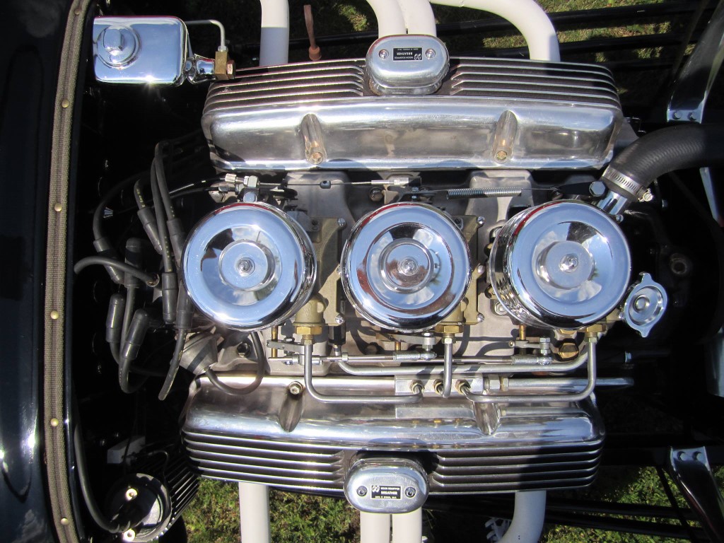

    This right here, you can vent it at this spot, just weld a tube and put a push in breather from a valve cover in the end.
    This is how I vented my corvette valve covers, indiscreet and let's the corvette still stand out without obstruction, same spot on both valve covers.
