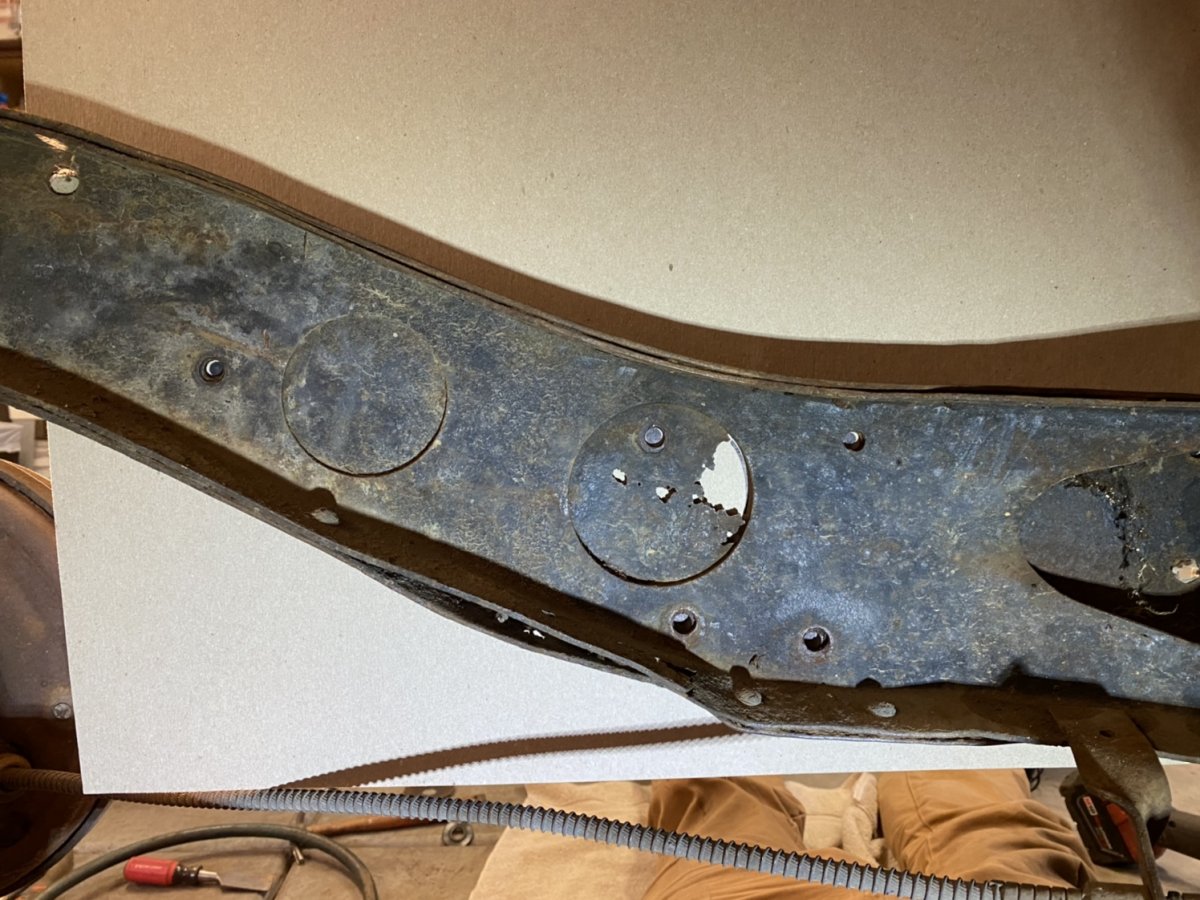

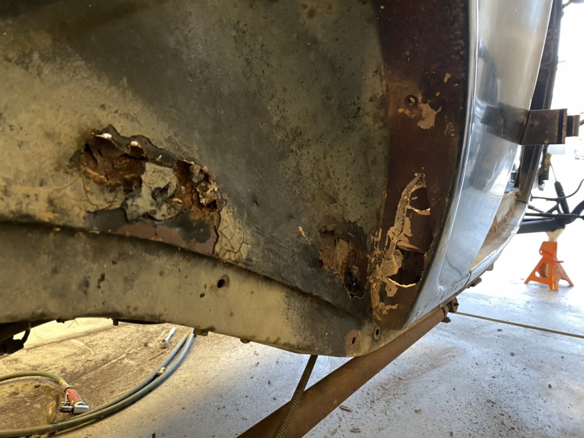

    Finally got some time to start on the Metal work! Took this week off to concentrate, and to “isolate” myself for a bit from all this
    TP-Corona-hoarding Insanity!
    I’m just hesitant, measure 4 times!
    Then cut! I’m a little nervous!
    This is a family car, not your average Hoopty! Wish me Luck!

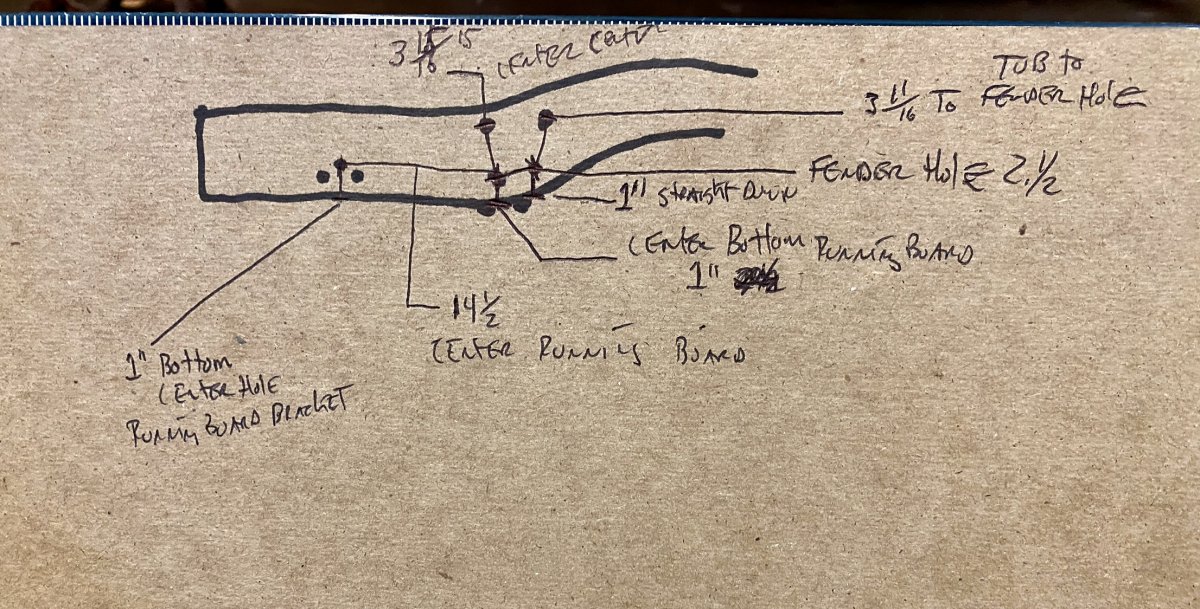

    This plus a template once body is out of way.... then cut the nasties! Adjustments.JPG

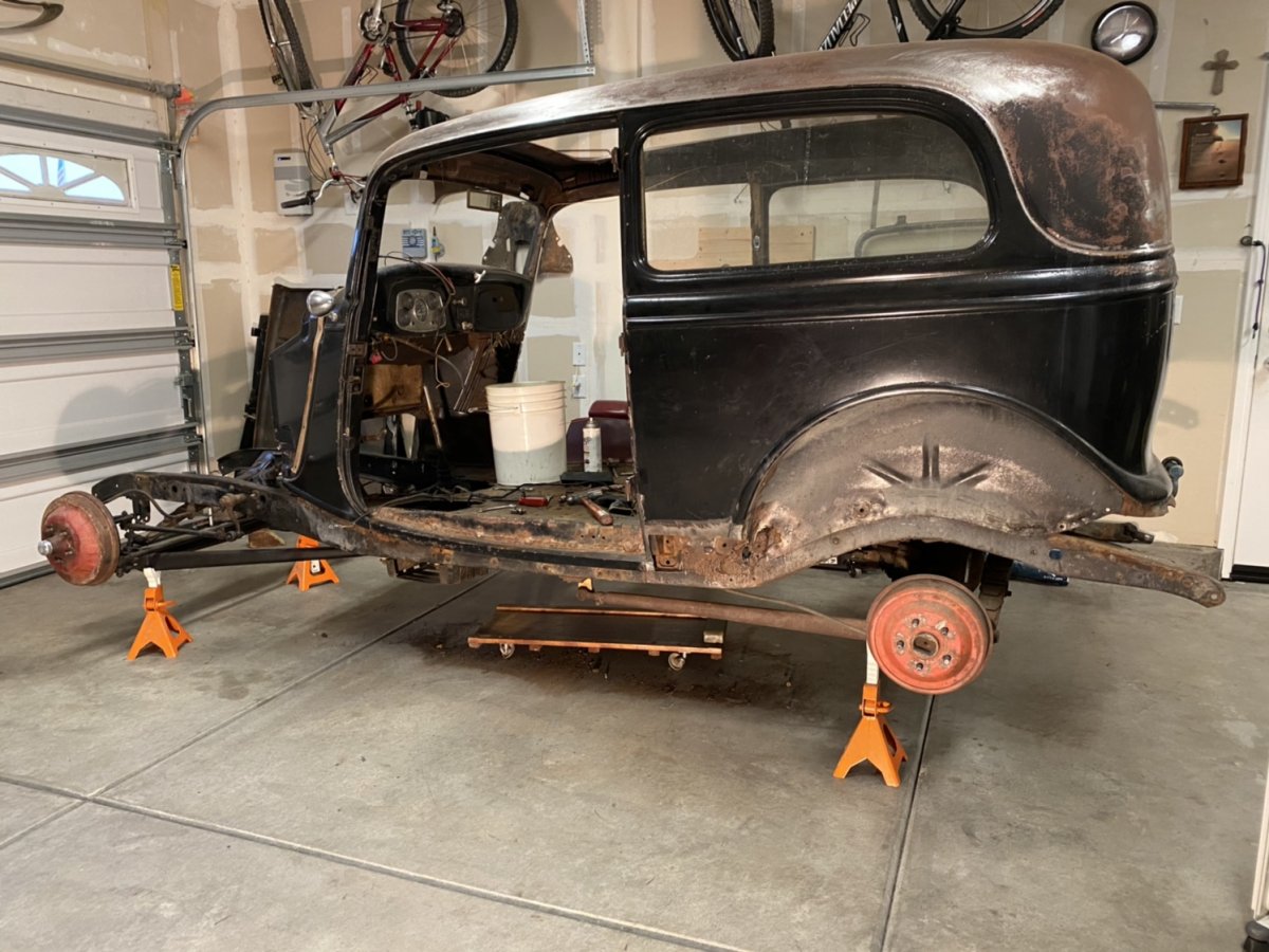

    Even though the p***enger is made of bondo, its pretty close to original. Gonna leave it until I build the other side! Ok, im gonna separate the frame and body!.....Gulp! No going back now! IMG_8833.JPG

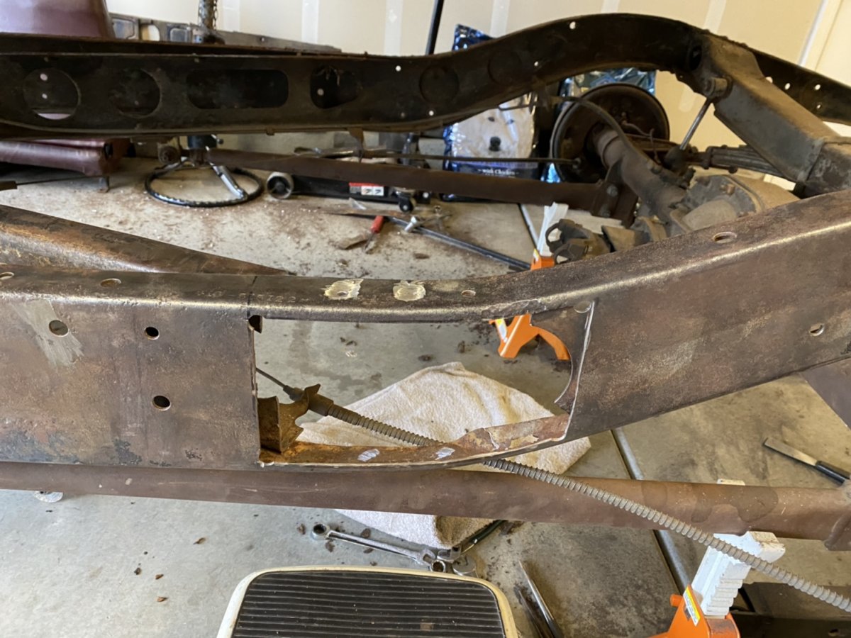

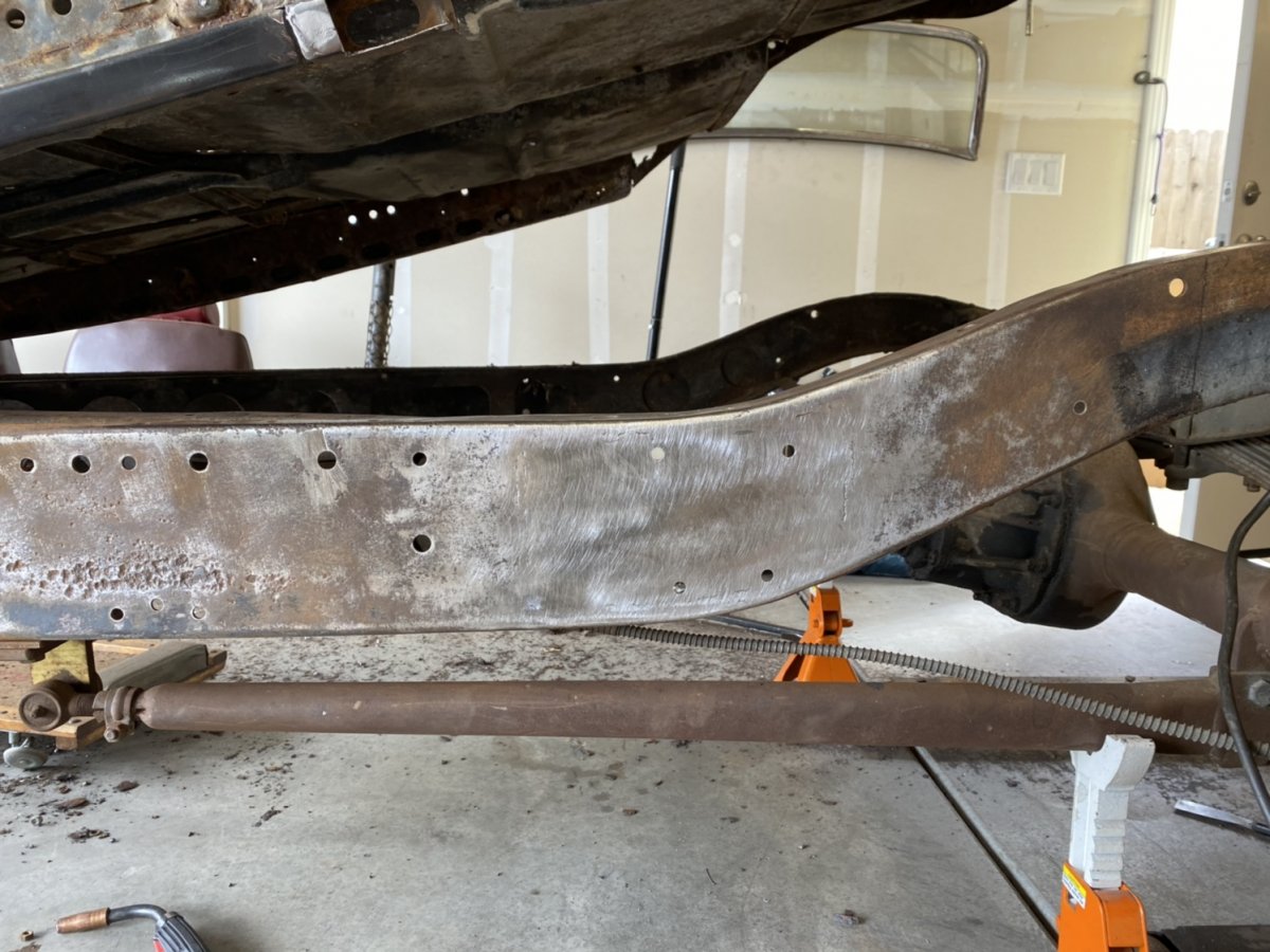

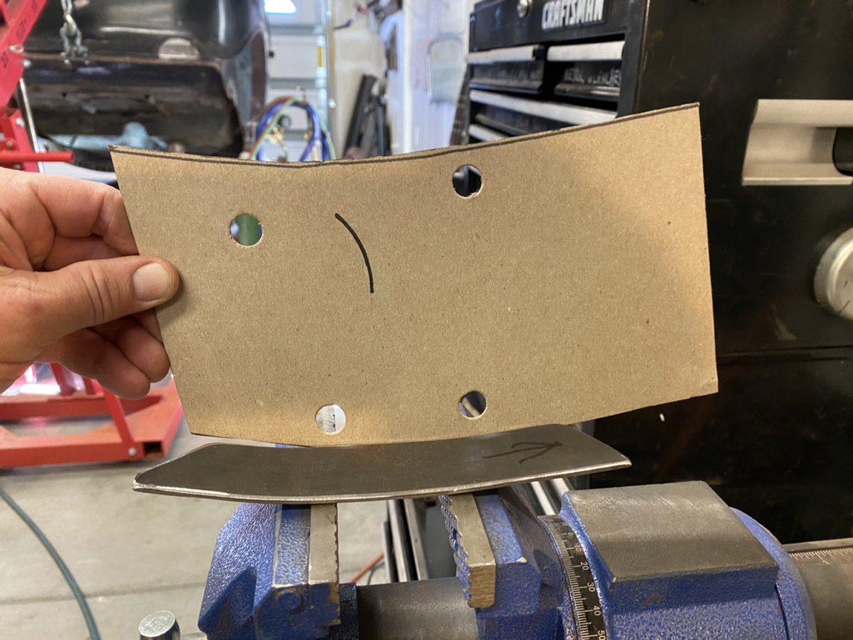

    Moving along quickly now! With the body up! Start with frame repair. Not that bad, just ugly!
    Made a template, and holes for reference. IMG_8848.JPG IMG_8851.JPG IMG_8853.JPG IMG_8854.JPG

    It is a lot less scary once you take the plunge. Looks like you have it pretty much figured out. Has that body ever been off the frame?
    -Abone.
    Stogy likes this.
  12. oj
    Joined: Jul 27, 2008
    Posts: 6,597
    oj
    Take a suggestion? Before I cut into the frame etc I would be making a substantial brace from a frame jig and bolting to some of the holes at the rear of the frame, they would be my witness points and hold things together. I see you don't have a frame jig but you can 'make do' with a substantial steel plate wider than the frame and weld some 2 x 2 uprights with a 'flag' that bolts into the frame. I'd also get rid of the rear end.
    As nice a car as that one is, its worth the effort and I can tell from your templates that you are going to do it right. I'd be making sure each of the frame horns are the same and make a jig to keep them that way before you cut.

  14. 33Doll
    Joined: Sep 27, 2019
    Posts: 1,571
    33Doll
    Moving along nicely!
    Had to cut the inner piece out too!
    Luckily the traction bars, and rearend mounts are bracing it. Only the curves, and top channel are really holding it.
    Any more, and it might collapse.
    Only way to get to the back side!
    Ill weld the patch, then replace the bottom curve flat section then weld back in the inner piece, it will work.
    Ill clamp angle iron later, when i line the x member inner piece back in.
    Yeah its the redneck way, oh well. Too late

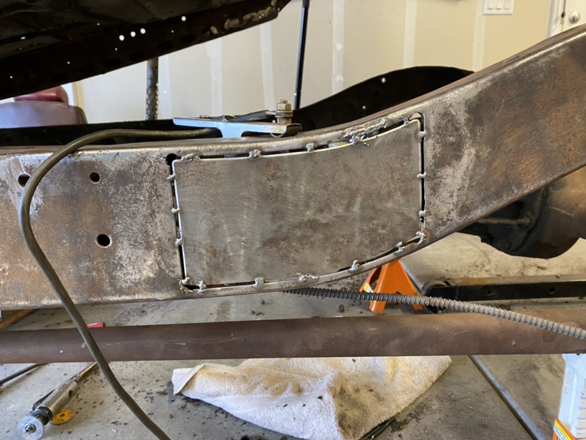

  15. 33Doll
    Posts: 1,571
    33Doll
    But got this far!
    Gap is a little bigger than I like,
    But Im pretty good at s***ching!
    More penetration, less warping that way. Have to move around doing it that way! Pretty good for one day though!
  16. Bandit Billy
    Joined: Sep 16, 2014
    Posts: 16,388
    Bandit Billy
    I'ts a little late now but a trick one the guys taught me is to weld in the inner rail piece first from the backside so there is less weld dressing and you can shoot some rust preventative on it begore covering it up with the face plate.
    Stogy, Hnstray, 33Doll and 1 other person like this.

  18. 33Doll
    Posts: 1,571
    33Doll
    Yeah, I can do that still in reverse.
    I haven’t welded the inner in yet, cause I wanted to weld both sides but with the gap I have, probably don’t need to now, but we’ll see. I got a bunch of rust conversion juice, to paint on everything and in between.

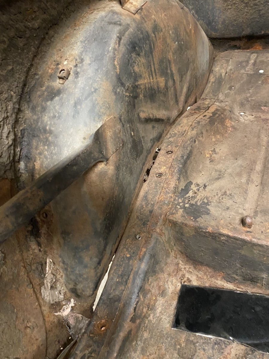

  22. 33Doll
    Posts: 1,571
    33Doll
    Good as it gets!
    Now to tackle the inside!

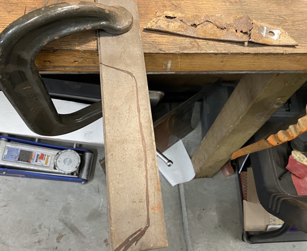

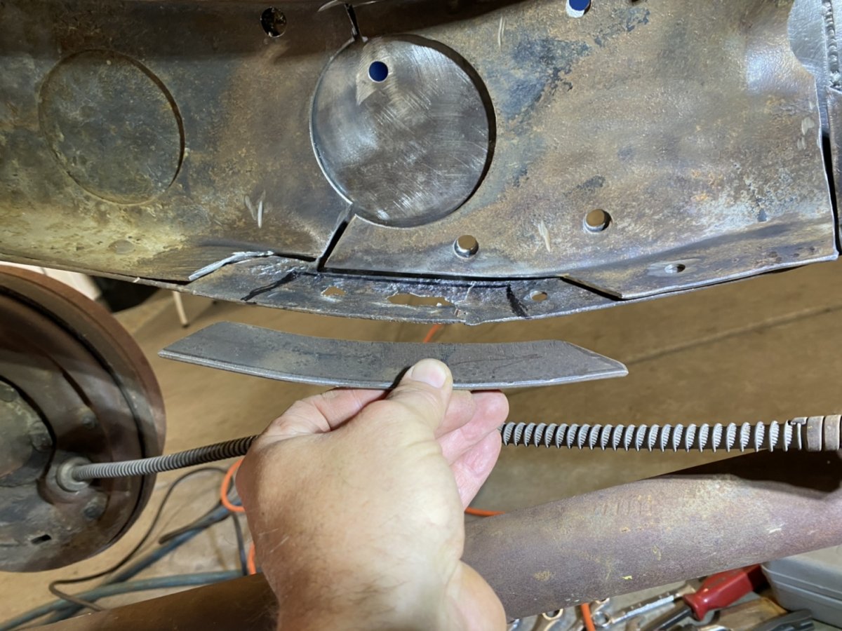

  24. 33Doll
    Posts: 1,571
    33Doll

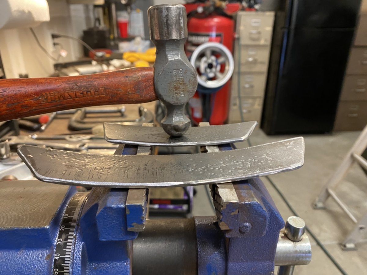

    Kicked **** Today!
    Formed some curved patches on a vice, and ball-peen hammer formed, it also hardened the **** out of it too!
    Hella strong!
    Adjustments.JPG IMG_8883.JPG Adjustments.JPG IMG_8879.JPG IMG_8889.JPG IMG_8892.JPG IMG_8893.JPG IMG_8894.JPG IMG_8898.JPG IMG_8900.JPG IMG_8904.JPG IMG_8906.JPG IMG_8911.JPG IMG_8912.JPG
    Just need to finish the bottom
    Tricky welding upside down!
    Wire wants to melt into the cup!
    Feeling Good So Far!
    Ef’ that Corona BS!

  26. LM14
    Joined: Dec 18, 2009
    Posts: 1,936
    LM14
    from Iowa
    When welding overhead turn your wire speed up a touch.
    SPark
    Stogy, kidcampbell71 and 33Doll like this.

  28. 33Doll
    Posts: 1,571
    33Doll

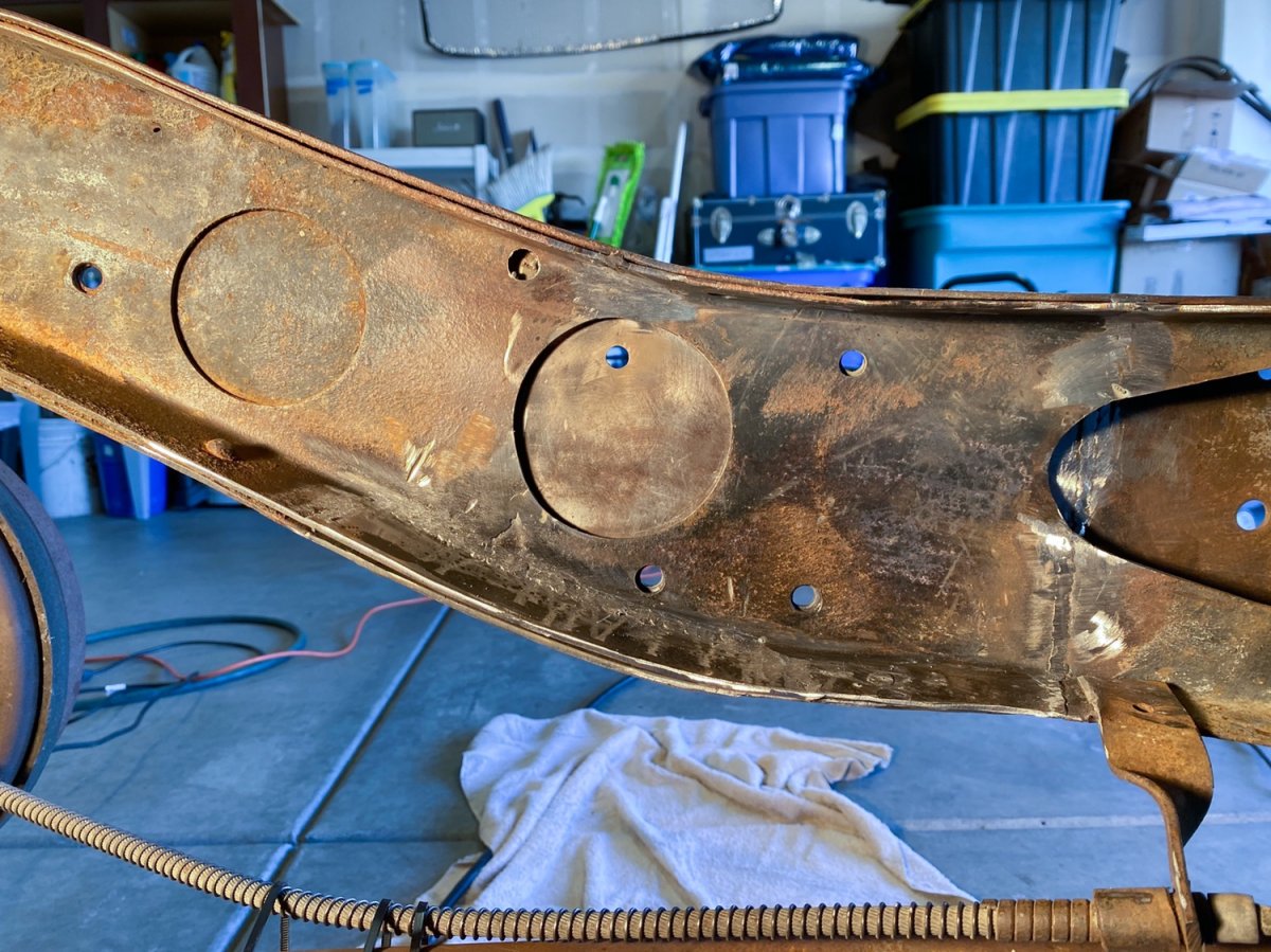

    Hard to see all what I did but here is a side by side of the inside rail, before and after:
