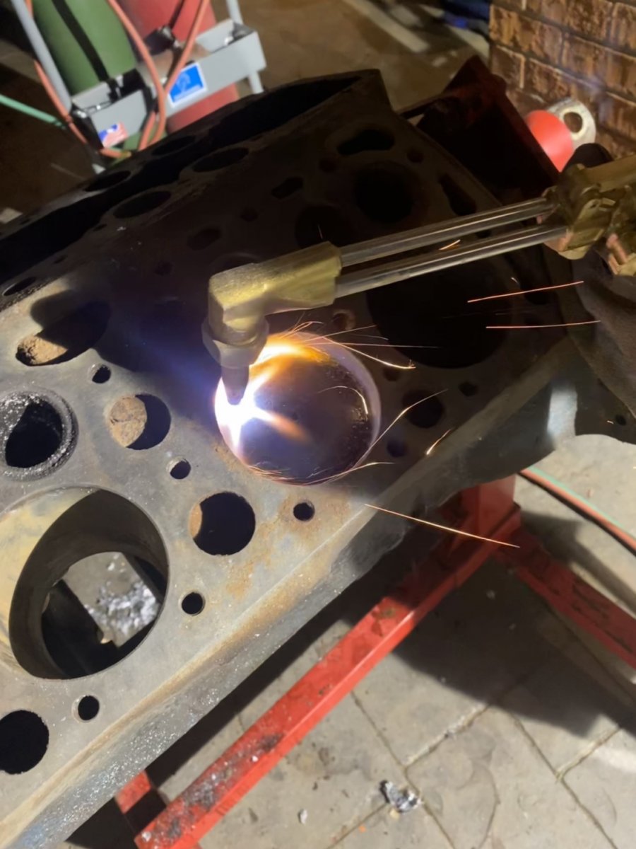

    Blue torch time...
  16. pennafxu
    Joined: Aug 20, 2010
    Posts: 2,263
    pennafxu
    from Kentucky
    Interesting colors...

  18. pennafxu
    Posts: 2,263
    pennafxu
    from Kentucky
    Tin foil...
    Br*** drift
    Finally the rings broke free...
    Nailhead A-V8 and loudbang like this.

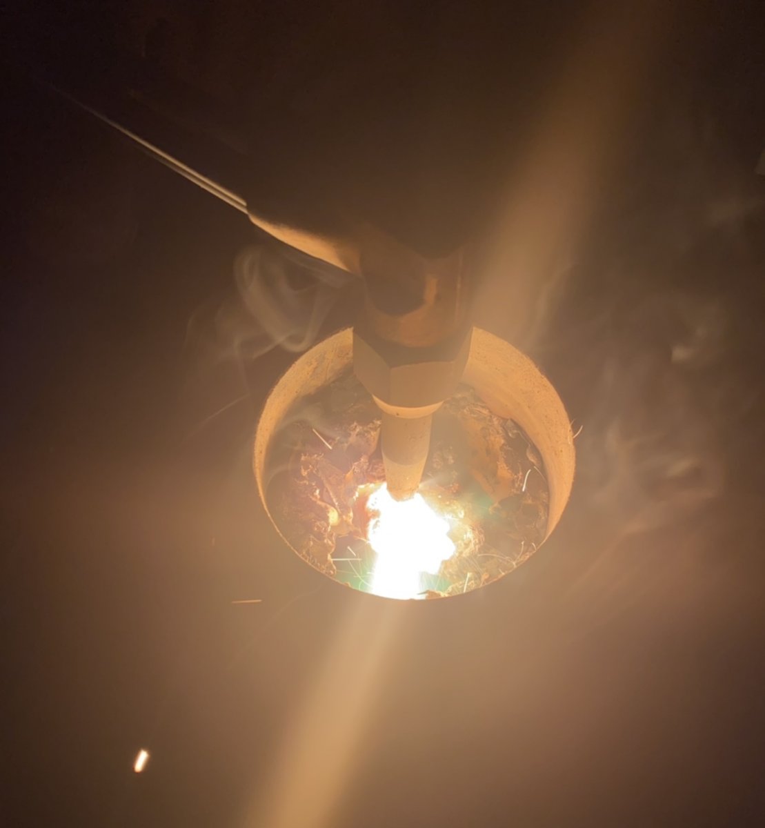

  19. pennafxu
    Posts: 2,263
    pennafxu
    from Kentucky
    Melting the rest of the con rod

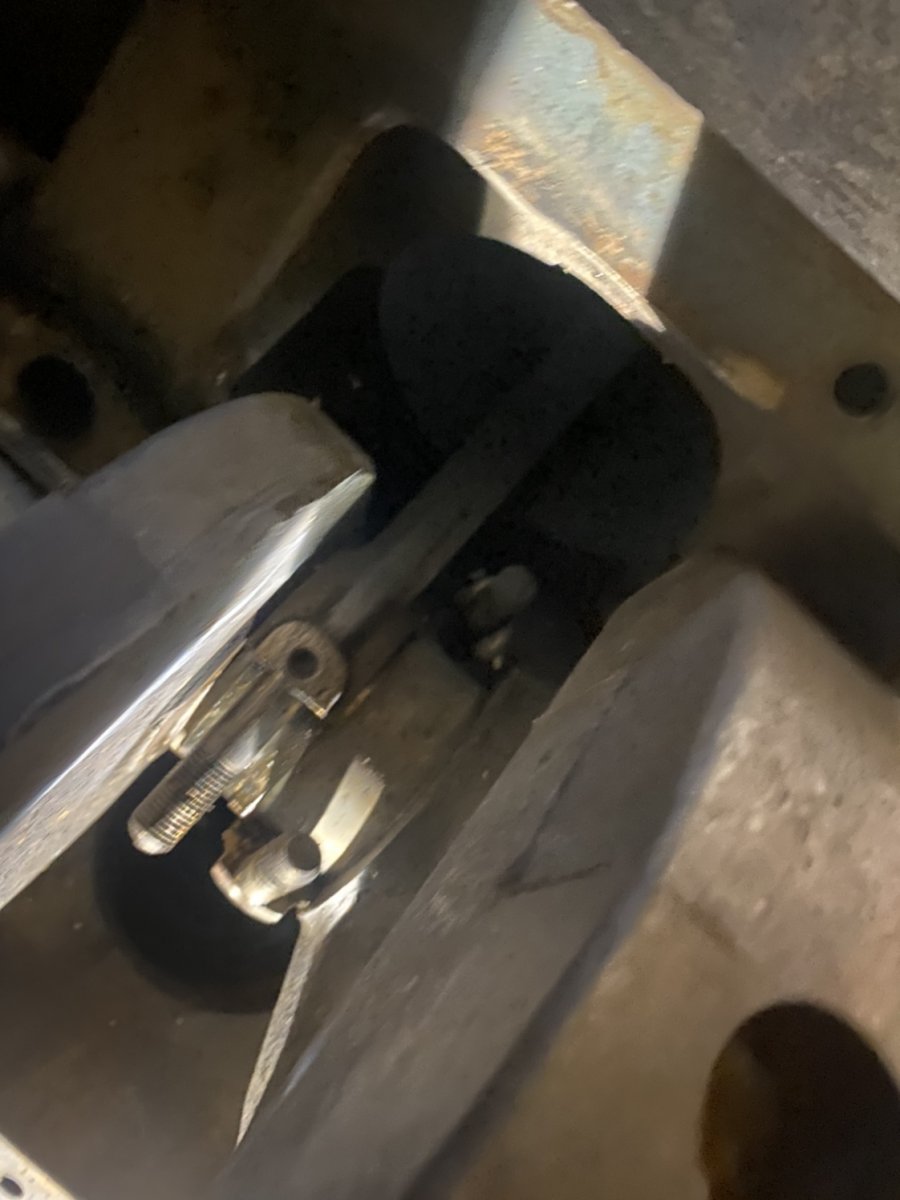

  20. pennafxu
    Posts: 2,263
    pennafxu
    from Kentucky

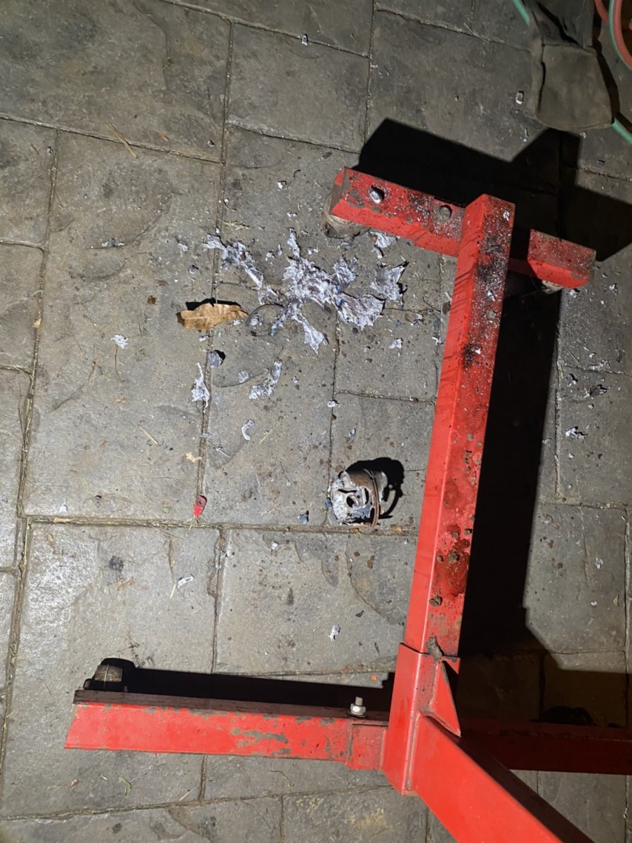

  21. pennafxu
    Posts: 2,263
    pennafxu
    from Kentucky
    I’ve got 99 problems but a piston ain’t one... on to the next one. IMG_1863.JPG IMG_1864.JPG . Started in the middle... IMG_1865.JPG IMG_1866.JPG flipped block to visualize the connecting rod IMG_1867.JPG
    I love my heat wrench [emoji373]
  22. pennafxu
    Posts: 2,263
    pennafxu
    from Kentucky
    Carefully avoiding block and crank IMG_1872.JPG This was the worst for space... IMG_1873.JPG
    I decided to go for the crank IMG_1874.JPG IMG_1875.JPG the last one was easy breezy IMG_1876.JPG IMG_1877.JPG

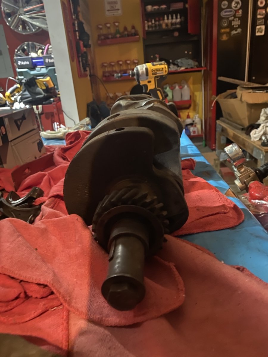

  23. pennafxu
    Posts: 2,263
    pennafxu
    from Kentucky
    Nailhead A-V8, patmanta and loudbang like this.
  24. pennafxu
    Posts: 2,263
    pennafxu
    from Kentucky
    Praise the good Lord!
    Outback, rusty valley and loudbang like this.
