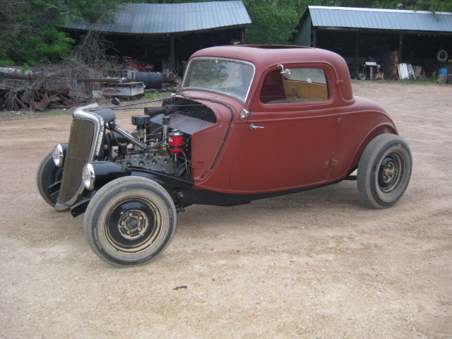

    Sorry, you will have to get opinions from some one else on "luxury "items like that. I believe H&H has a good rep though, search it here. Here's my jalopy, not perfect, not done, not fast...but i get a big grin every time i look at it. Fired it up just today for the first time since October. Too muddy here on the frozen plains for a drive, but a balmy 45 degrees so i had to hear the flathead run IMG_0656.JPG
