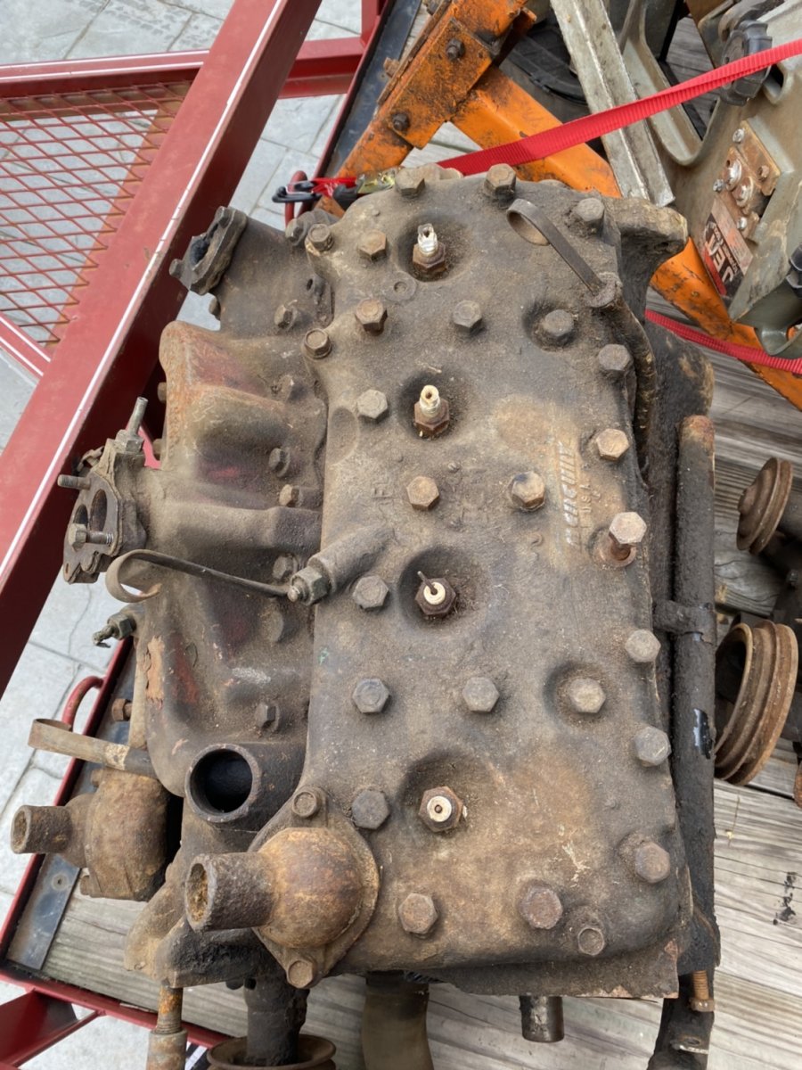

    Engine One

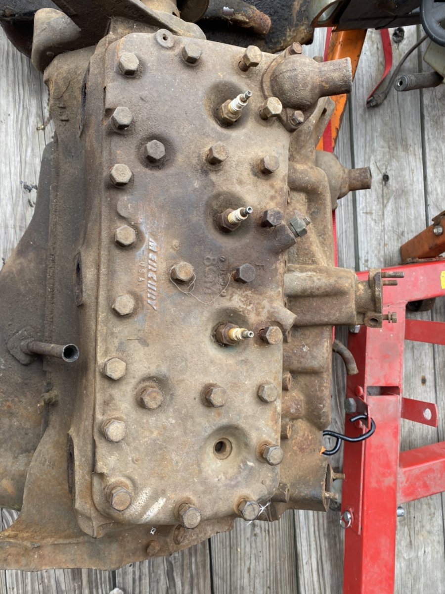

    Engine 2
    Need to dis***emble and get them to the machine shop! I’m gonna be racing my son on dis***embly. I have another couple engine stands but can’t find my locking bolts... [emoji20]

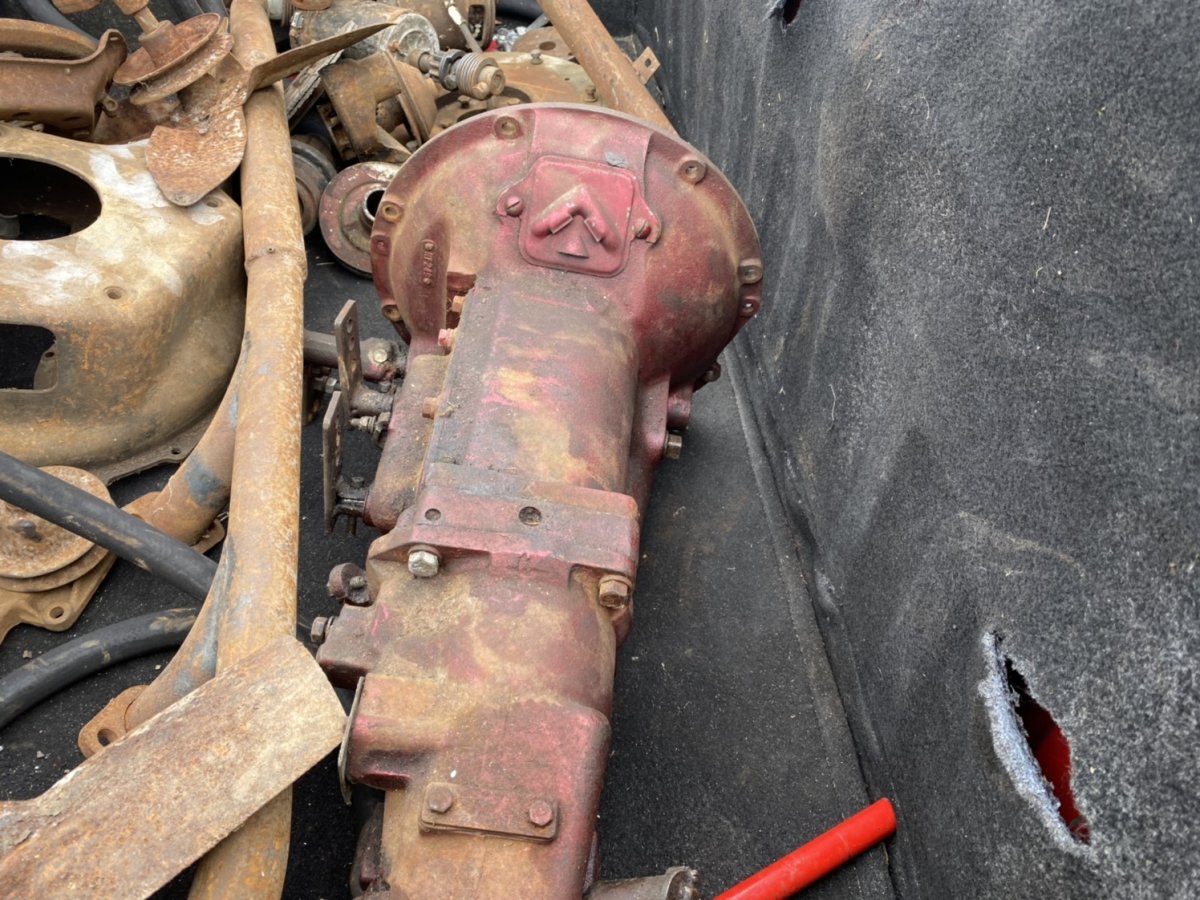

    This trans bolts directly to this block with the help of the bellhousing...

    the trans in the photo is an overdrive ******, (not the newyork kind), and it should require the 1/2 bell

    that bellhousing is for a trans with a flat front mount, more like modern stuff. your overdrive mounts on a 1/2 bell, similar looking to the rear of the earlier ford flathead blocks
    pennafxu likes this.

    The red transmission is a 3 speed, not a 4 speed.

    Not sure what "above" you mean? To bolt that transmission to the back of the late flathead block you will need a 1/2 bellhousing like they said. It's a ring about 4" thick that bolts to the block, then the trans bolts to it. They were made in stamped steel, or cast iron. Those two interchange just fine. When buying a cast iron one look them over closely as they are commonly cracked.
