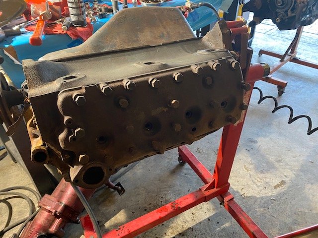

    I removed the cam and timing cover and all of the tappets and valves. Unfortunately the engine is seized. I have been working it with pb blaster for 3 days, and also shocked the pistons with a large iron pipe. Still no dice. Next up is the heat wrench for some hot cold cycles. I obviously don’t want to damage the block or the Merc crank...
    Careful extraction is necessary here, however, worst case scenario will be destruction of the pistons...
  22. alchemy
    Joined: Sep 27, 2002
    Posts: 23,465
    alchemy
    Sometimes you can sneak a few pistons out the top if they aren't all seized. Then you only have to worry about the couple that don't have clearance around the crank, and the seized ones.
    Check for a ridge at the top of the cylinder first and remove it with a cutter so you don't accidentally crack it pounding a piston upward out of the hole.
    chryslerfan55 and pennafxu like this.

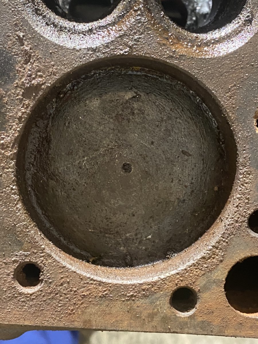

    So I followed your advice... I think it might be working! IMG_1457.JPG IMG_1456.JPG IMG_1458.JPG IMG_1459.JPG
    I poured a serious batch of witches brew down again... every damn grease I could find! Liquid wrench, gas, pb blaster, wd 40.... something’s gotta give.
  30. pennafxu
    Joined: Aug 20, 2010
    Posts: 2,263
    pennafxu
    from Kentucky
    I also leveled off the block and focused on one side. I purchased a cylinder fly cutter, as there is definitely a ridge! Thank you alchemy for saving my **** for the hundredth time... I will work the other side tomorrow. I figure having full coverage is better than some weird angled variant.
