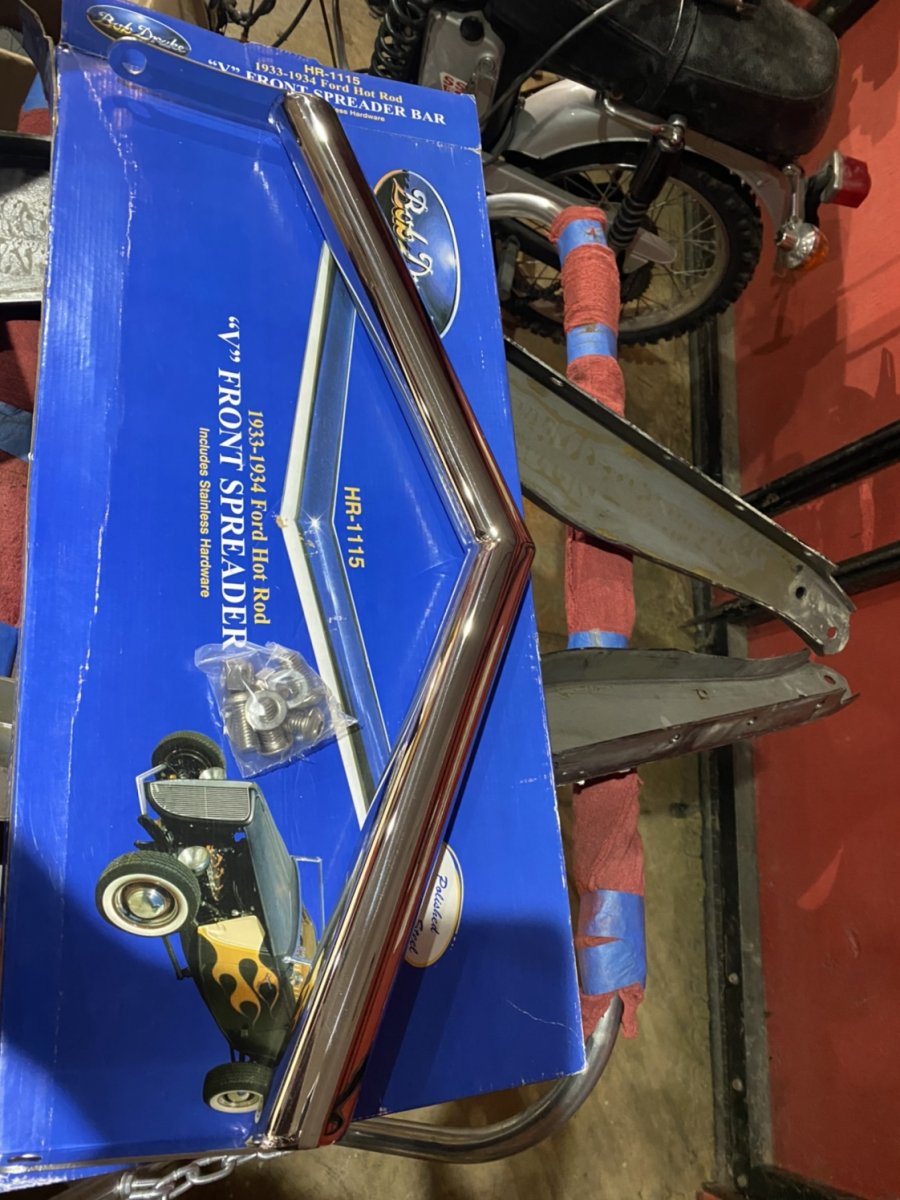

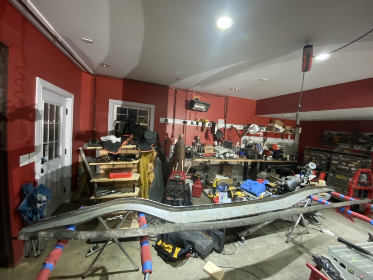

    Frame rails came in today...

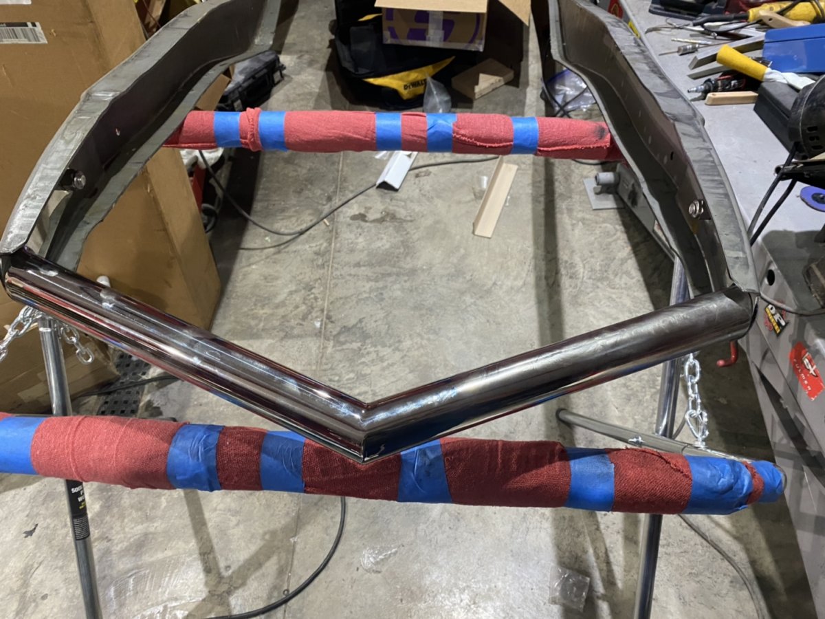

    Chrome vee bar to set up the dimensions of the frame. I have a rear chrome bar and suspension crossmember coming from Pete and jakes to finish out the perimeter dimensions. I can then start working on a sub floor ***embly to mount the “body” to, or at least start piecing it back together as I have very little reference points. I will also be ordering a tubular crossmember. I will be welding up the boxing plates this weekend.

    I am jealous of the new rails, i have always wanted to start with some clean new rails, maybe next time. Not a fan of those V shaped things, but, opinions are like ***holes, we all have one. I get it, they serve a purpose , protect the god awful expensive grill, my coupe may get some home made nerf bar configuration someday. Now, to the point, i'm not sure i would consider an aftermarket front and rear spreader bar the basis to use as the frame dementions. You're car being of the "much ***embly required" type, I would think a new complete floor ***embly and the numbers off the wescot sight would be how to set up a new frame

    I’m actually with you on the spreader bar... I just need something to get some form. I can always yank it... yes I agree on the westcott drawing. That’s my first post. I can start at the firewall and go backwards... thoughts?

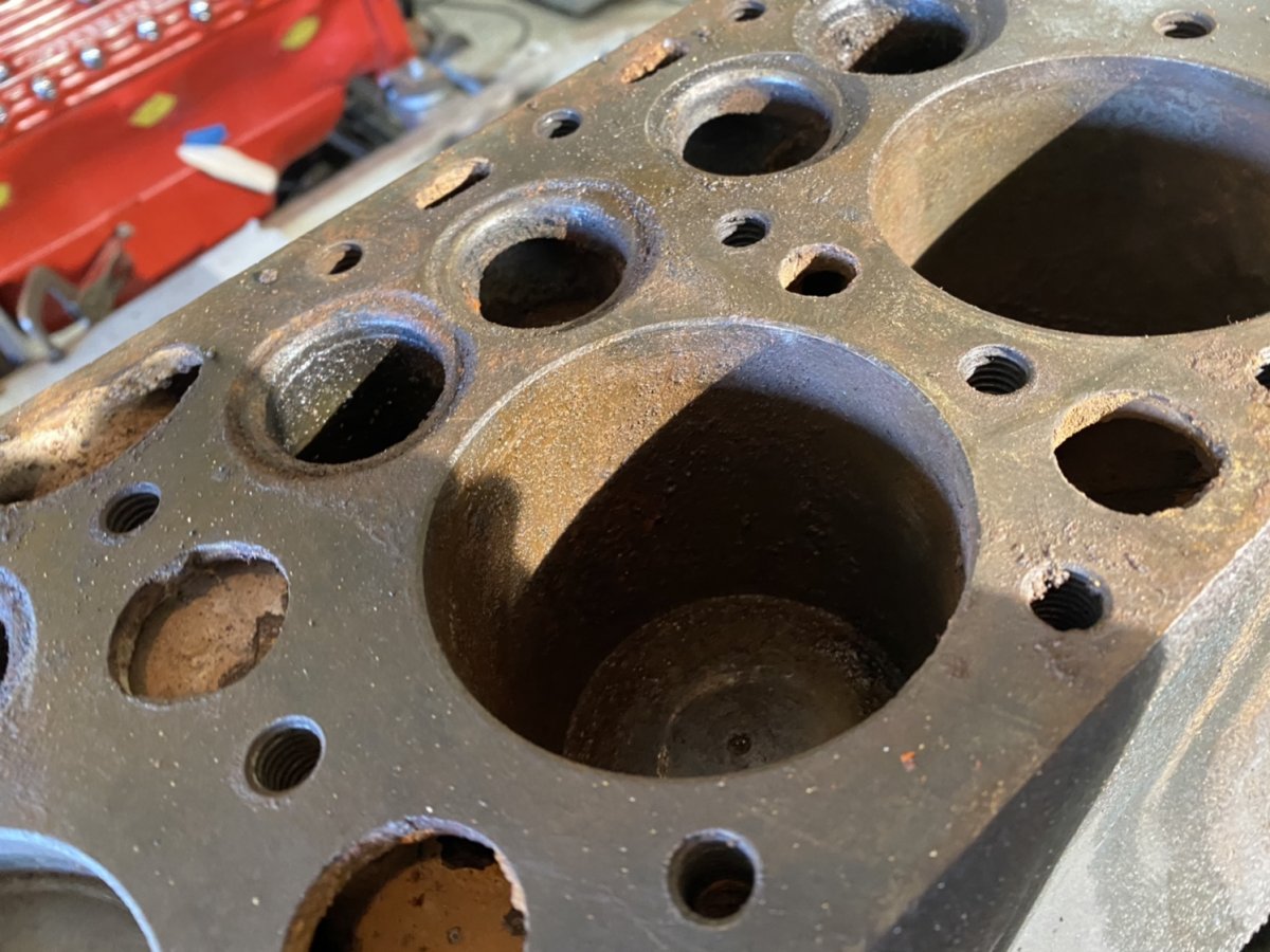

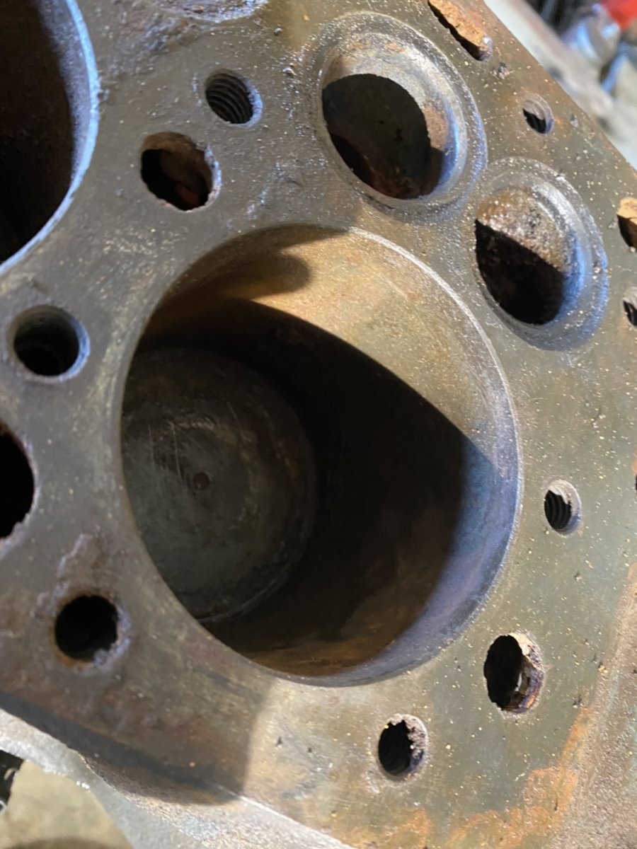

    Any advice on removing this rust? :(

    If you want to be careful, 220 wet and dry with wd40 by hand. More aggressive, softer wire wheel on a battery drill.
  11. If it was me, which it ain't, and my block, which it ain't, I'd strip it completely down, hit it all over with oven cleaner then pressure wash to degrease it (pressure wash all water p***ages while you're at it), then find a big enough vessel (poly garbage can?) to set it in. Fully cover it with acetic acid (vinegar) or citric acid, and let it set for a couple days. Pull it out and repeat the pressure wash in and out, repeat as needed.

    This is the result after 24 hours in citric acid. IMG_8607.JPG IMG_8609.JPG IMG_8606.jpeg IMG_8608.JPG

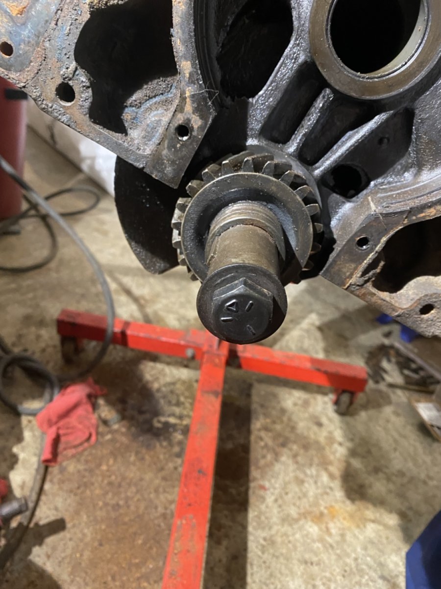

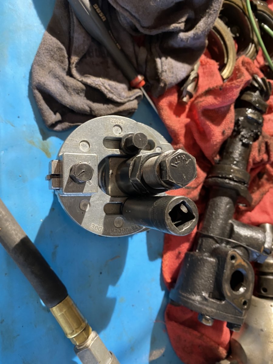

    Crank pulley bolts came in... hopefully will get some purchase today
    Outback and chryslerfan55 like this.

    Got the crank pulley bolt installed

    If you are using the crank bolt to try and turn the stuck motor, i would be worried it could break. takes a lot of violence to play with stuck motors. I like to have the Flywheel on, and use the ring gear teeth and a pry bar against a bolt in the block. how stuck were the 2 you got out?
