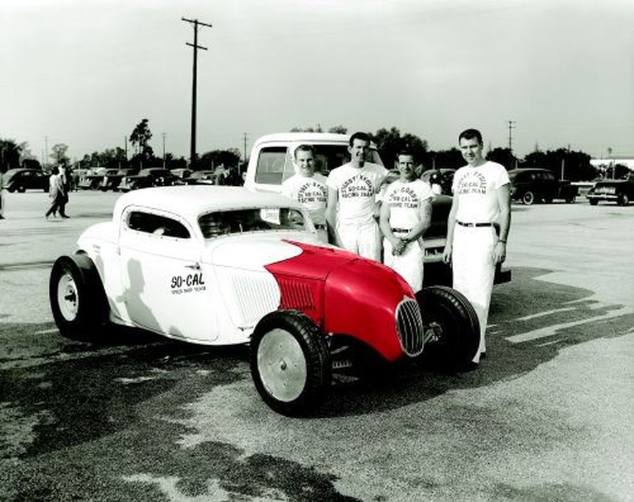

    The two pictures you posted of the So Cal coupe are two time frames of the coupe:One low chop with the Guys standing around it and UltraLow with Alex sitting in it.(look at the window on that shot...)Neat project.
