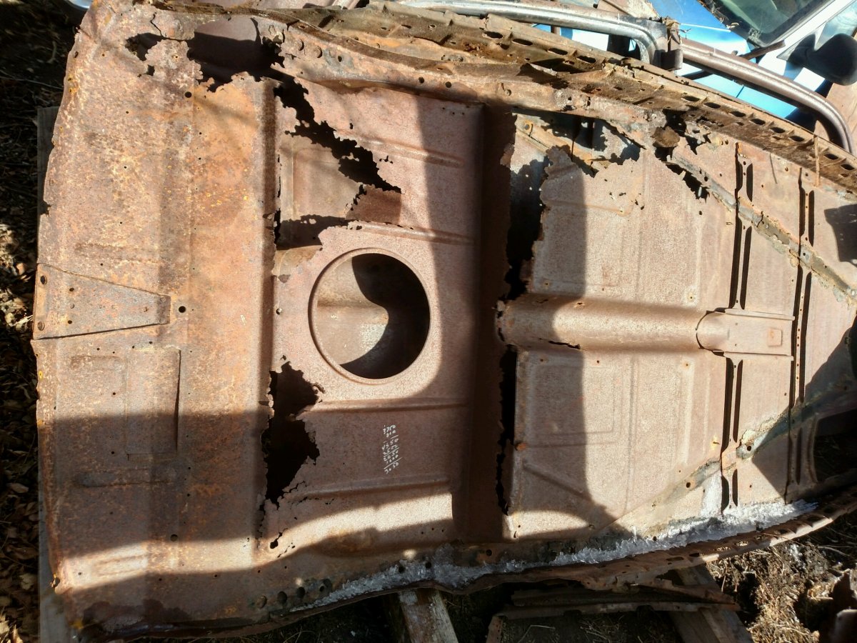

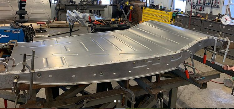

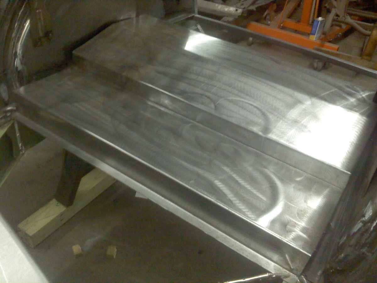

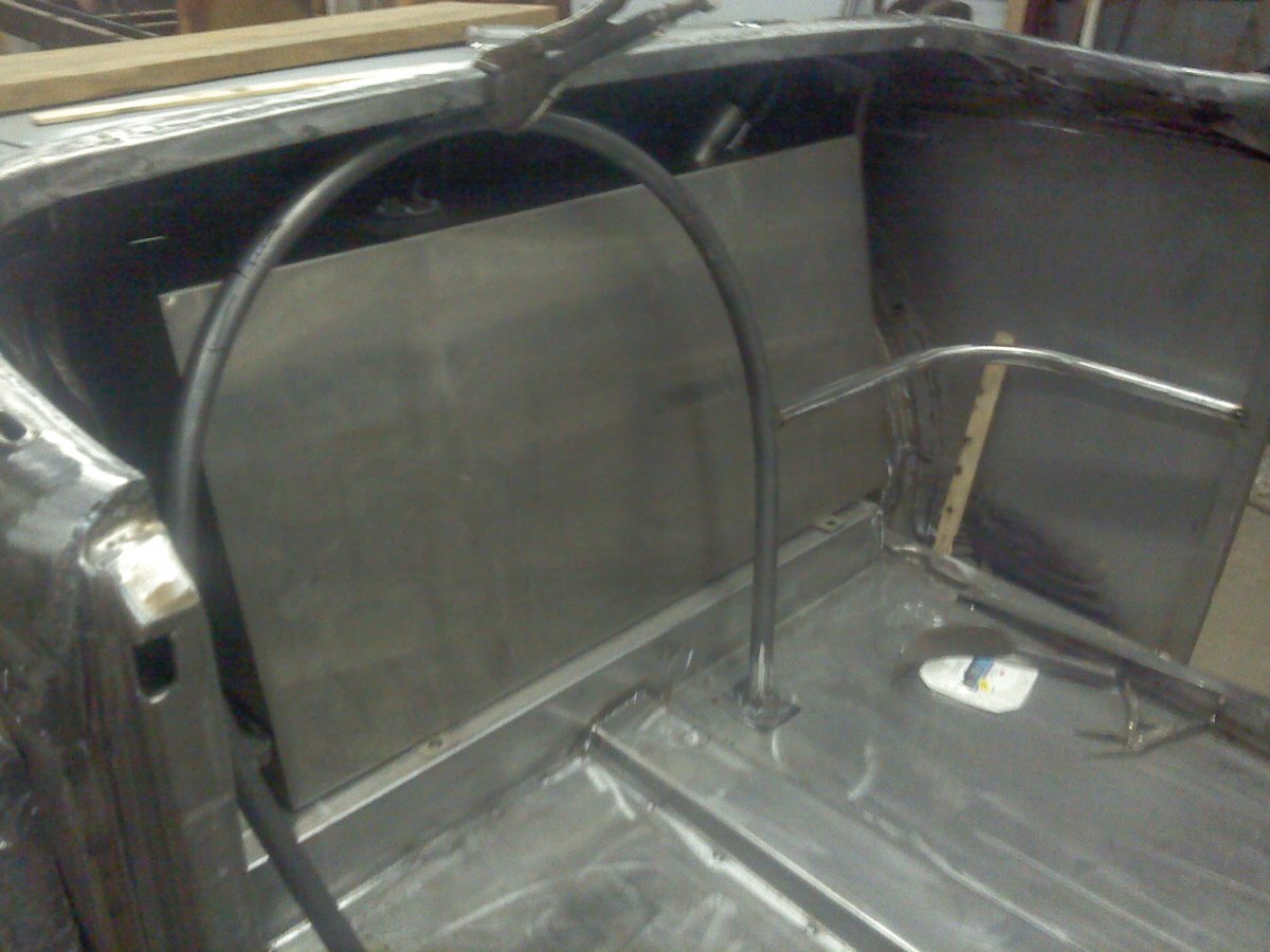

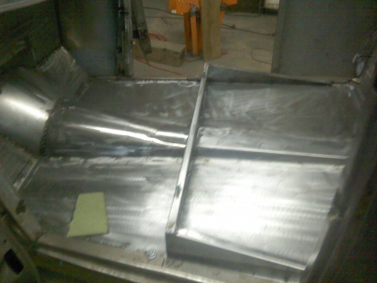

    At this point I would get your frame to the correct dimensions, then make and install your ex members Since you plan on channeling it I would build my own floor. Buy a sheet of 16 gauge cold rolled sheet metal ($100-150) and go to town. Here are pictures of the floor I made for my roadster. I raised it in the rear, built a shelf for my gas tank and built a tunnel for my drive shaft. 003.jpg 004.jpg 32 roadster- cabri 001.jpg 32 roadster- cabri 002.jpg 32 roadster- cabri 003.jpg ] 32 roadster- cabri 014.jpg

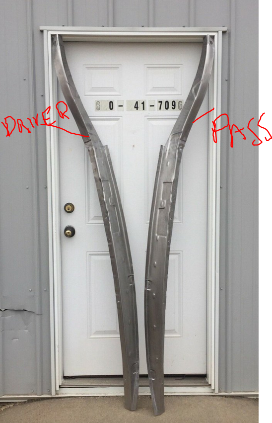

    Which side is which in this picture?
  21. Subrail on right is p***enger side. the long flange sits on top of the frame rail. The body sits on the small flange. if you are channeling the car, just cut the flange off and add material as needed.
    please excuse the chicken scratch
    Hot Rods Ta Hell likes this.

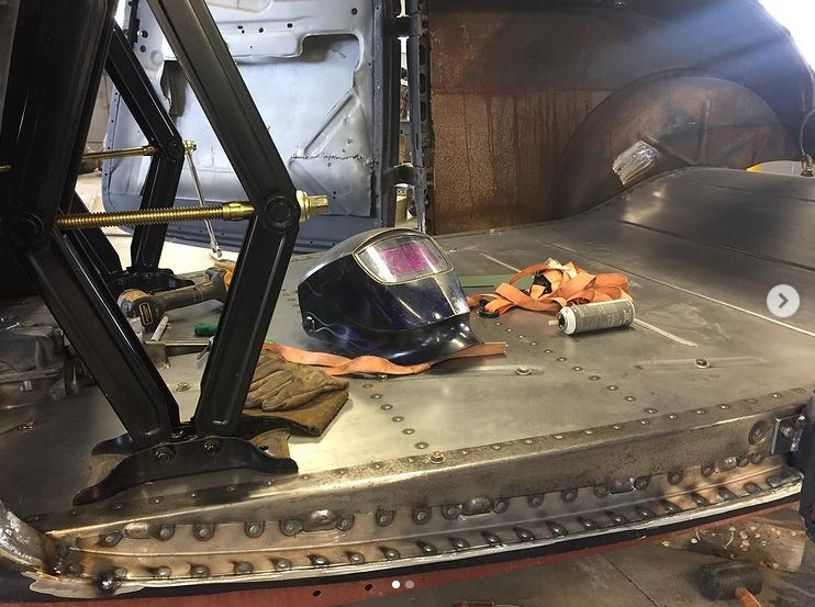

  22. Here is a picture of the floor pan with the sub-rails installed. The body sits on the small flange at the bottom of the sub-rails. Apparently he is making the sub-rails with a 2 inch channel already built into them, 2 in channel rails are shown in this picture
    picture with body on sub-rails
