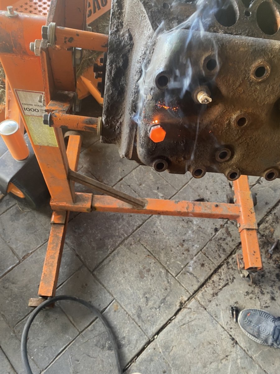

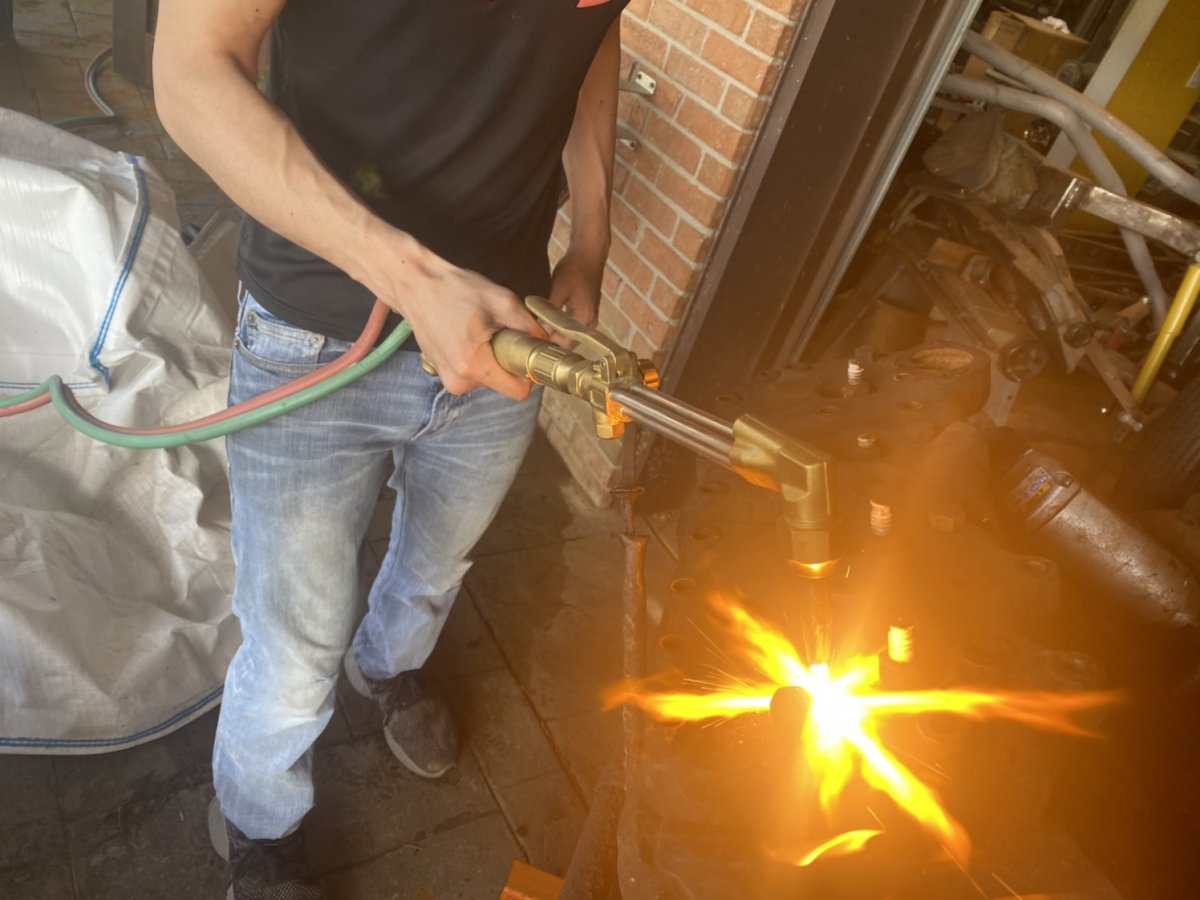

    Took the heads off...
    With some hot wrenching
    j hansen likes this.

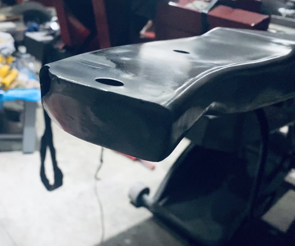

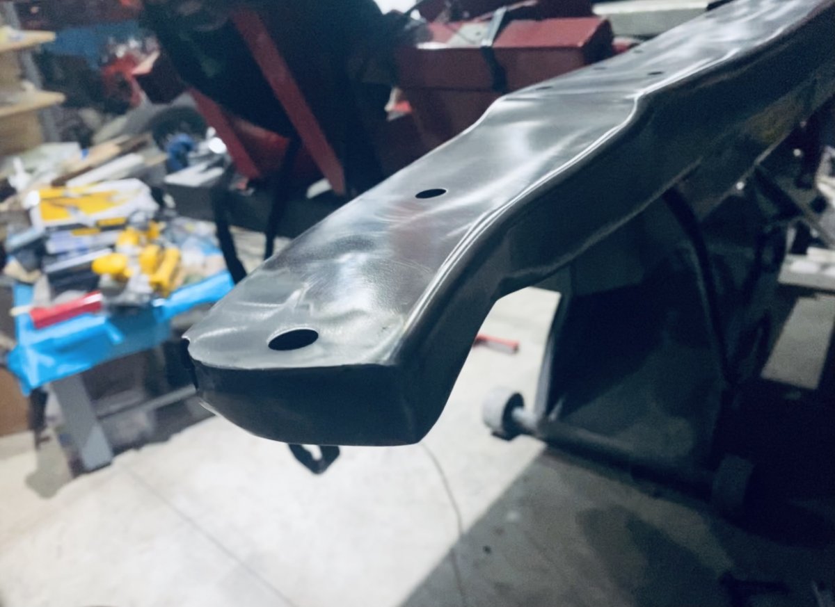

  14. pennafxu
    Joined: Aug 20, 2010
    Posts: 2,263
    pennafxu
    from Kentucky
    Before...
    After
    I TIG welded the opening down some... a little ways to go. I was going to use a small piece of steel but wanted to practice my weld building skills. It’s all about heat control, patience and good shielding. I used a flat ground tungsten also for a wider arc. It’s very difficult not to get rod impurities on the tungsten which causes an unstable arc...
    brEad likes this.
