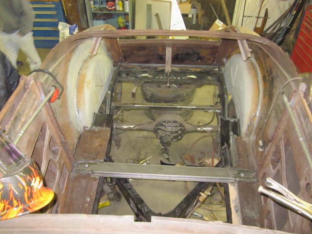

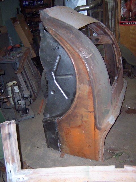

    Doing a 33 Plymouth with a friend and we ran into similar problems with lack of available patch panels.
    We used Ford wheel well panels. Easy to come by and with some modification they worked out very well for us.
    You can check out our build here:
    http://www.jalopyjournal.com/forum/showthread.php?t=680682&highlight=uncle+ricks+33
