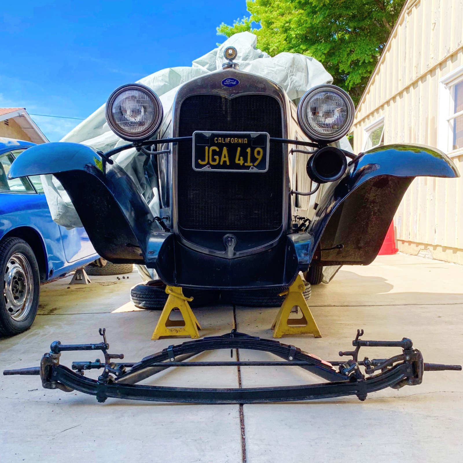

    E7892D07-1E5B-4207-AF29-F8074369ED6C.jpeg D4333D97-B151-4DE1-902B-676CFBBB4E55.jpeg 9862C28F-DA45-41CB-A10E-6D53A8548BB7.jpeg 33-36 axle
    32-34 spindles.
    32-34 perch pins bushed to accept model A shackle.
    1/4” spacer for wishbone at axle.
    Reverse eye spring. Remove leaves to taste.
    Use existing kingpins and brake bits.

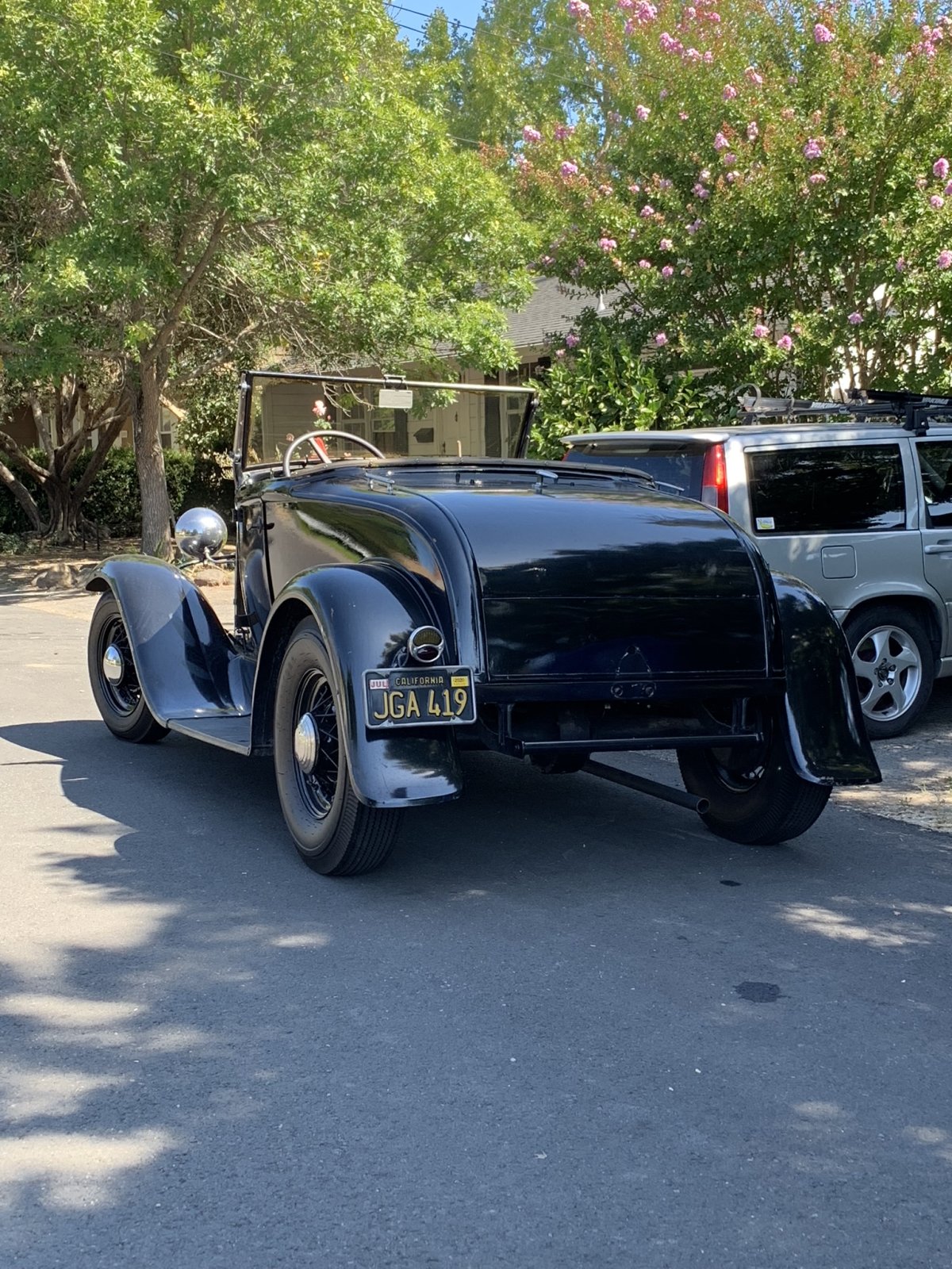

    Here is the car today with an AV8 makeover.

    DG Racing
    j ripper nice car
    what is your tire size ?
  14. j ripper
    Joined: Aug 2, 2006
    Posts: 864
    j ripper
    from napa ca.
    Thank you! 700 rear. 450/475 front.

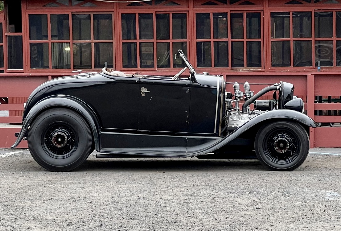

    My coupe has a reversed eye flattened spring, and a 33-36 axle, 32 spindles and brakes.
    The rear has a T spring.
    18" 32 rims, 475-18 front and 600/650-18 rears.
