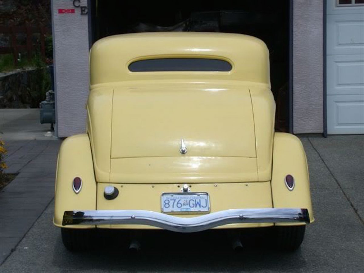

    Dan - this is a pic of the back of a 34 three window I built in the early 90's. Used a 57 Ford nine inch rear end with 15 x 7 inch wheels and 235/75/15 tires. Everything fit in the rear fenders just fine. The 57 Ford rear end is an inch or so narrower than the Mustang rear you are planning on using. oldcar_023.jpg

    Thanks again, now if the tires hit the fenders I can blame you all:)

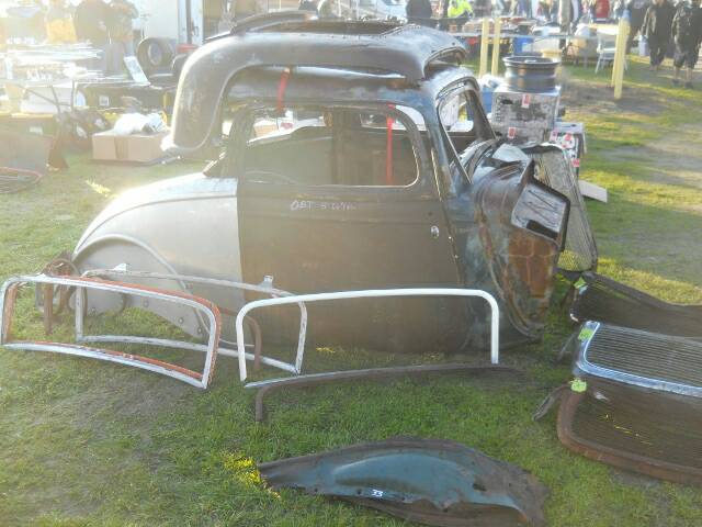

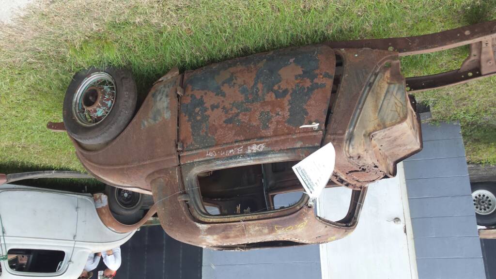

    34ford5w - flipped the pics for you - that is a very nice score! 20170219_170926_004.jpg 20170219_141946_001.jpg

    Thanks Yeah don't know what happened there lol! I've had these pieces for awhile. It was the parts car insurance got out of Florida auction couple years back. I've got a pretty good floor now from a Sedan and some 4dr b pillars I'm going to try and use as well as a 5" chop I'll post some more pics this weekend as I get farther along.

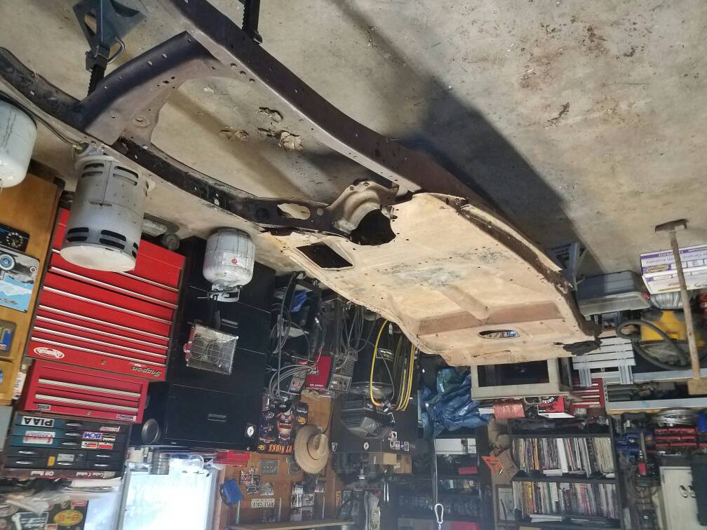

    Thanks guys got new phone and for some reason my pics keep downloading upside down??? Only on here though.

    Out in garage now trust me boys that car was not that great!!! No floor look at cowl close you can stick your fist through it! Kept garnish for my 3w I drive and cut roof off and kept doors. I got floor and braces in tonight and hanging new SAR quarters looking good. The car did have a pretty nice deluxe dash with its cats eye cigar lighter though yahoo!I'm not secretive I payed 6500 for car and 1750 to get it home. Plus 2200 for quarters and 500 for lower valence and a custom rear trunk back window piece from SAR 375 good floor 1000 you do the math oh yeah and a cowl 1000 and trunk channel 275 and braces top and corner 275 and 150. Geez anything else!! Little over 13k in my math.

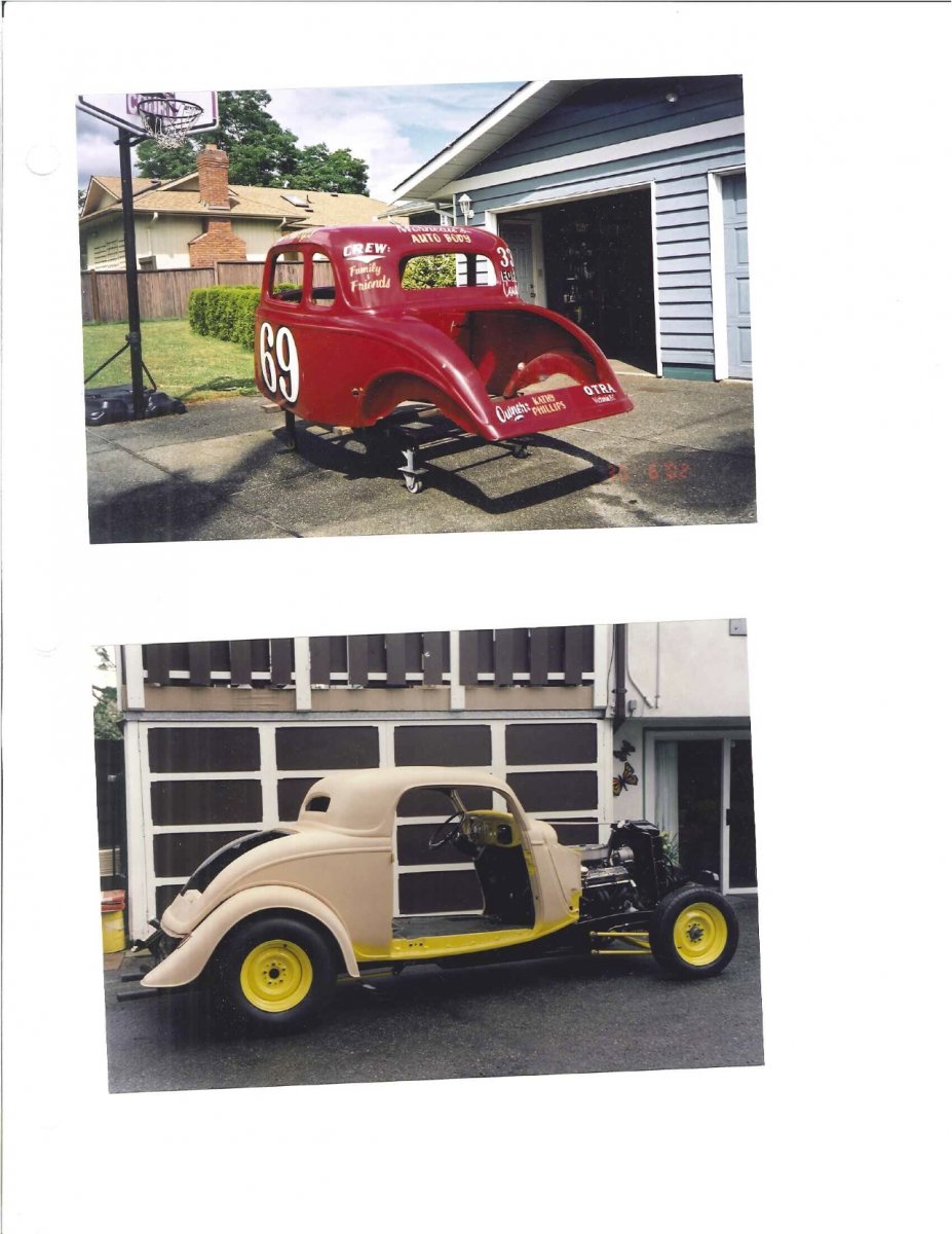

    Here are some old pics of the coupes shown in the first post of this thread. The three window went to a new owner three years ago, and the red one is now flat black and close to completion. 20130528163312.jpg

    It's amazing to me that in fairly recent history these coupes were cheap enough to build a nostalgia dirt track stock car out of.

    Damn tailgaters...:)

    That is my dream 33/34 right there
