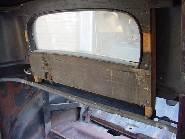

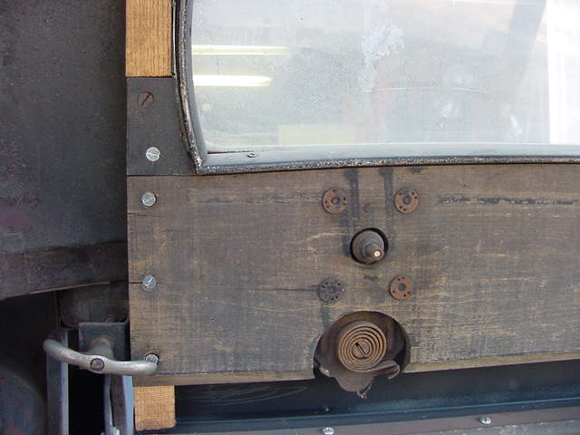

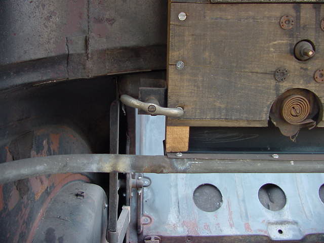

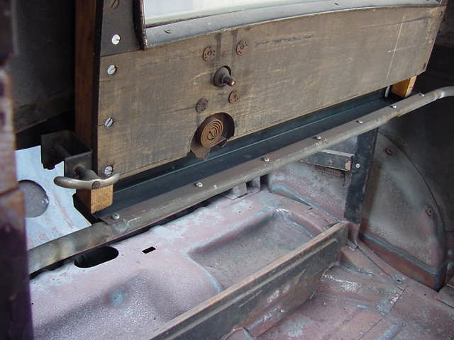

    1932 3W ... not a 33 - 34 :)
    The photos shows a 32 Murray 3W ... which would most likely be closer to a 33 - 34 than a Model A ...
    The wooden package tray has been removed ... so the could slide the seat back further ...
  7. Thanks guys! Deuce Roadster, thanks for the great pics. It looks like a wooden board held the regulator and not a metal panel! Great info! Is the window crank on the 33-34 on the p***enger side of the rear window like on the 32? Old Beet, I'll check with **** Spadaro for the regulator. Thanks again.

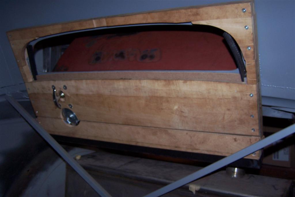

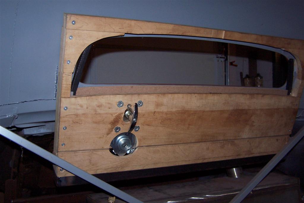

    I'm workin' on a 34 5window. I'll get some pics tonite or tomorrow.
    Yep Spadaro has the stuff. WoodArt is the wood that I used. It's cut down some to save trunk space and I'm not usin' the stock drain pan. The coupe is chopped. Have fun,Smokey
  13. 40Standard
    Joined: Jul 30, 2005
    Posts: 5,971
    40Standard
    from Indy
    I'd go with a power back window
  14. yekoms
    Joined: Jan 21, 2007
    Posts: 1,088
    yekoms
    I think that with all of the HAMB help you have it figured out.
    They aren' real good but,here's some pics of the window stuff in my coupe.
    There is a Masonite window pattern screwed onto the channel.
    like I said before the wood is cut down on the bottom. I only used the stock pan from the trunk hinges up to the window opening. Put a channel on the bottom of the wood with a drain hose down through the floor later.
    The repop regulator that I got is a Vintique Tiawan piece. I had to drill the rivets out of the crank mechanism and "clean it up" to make it work smooth. Have fun,Smokey
