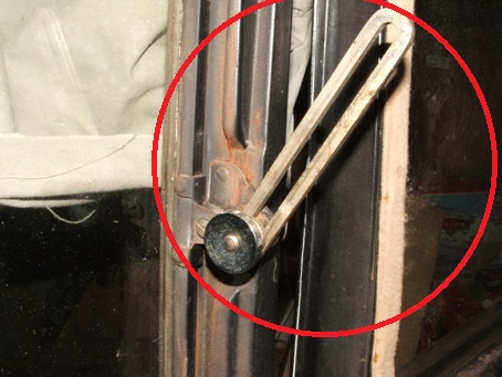

    Helping a friend work on his 35 pickup and these windshield frame parts besides being put together wrong, they don't really look like the correct parts on his. The picture is Model T, wasn't sure what they were called. Anyone have one that still has the stock parts they could take a picture of?

    Thanks mgtstumpy! Those look like the pieces on the truck now so they must just be in the wrong spot on the windshield frame.

    Probably have them in the bottom holes instead of the ones up higher.

    Thanks bobd1976, he did have them in the lower holes because the windshield didn't seem to open far enough with them in the uppers. I think we've narrowed that down to too long of bolts in the windshield hinges interfering with it opening all the way though.
