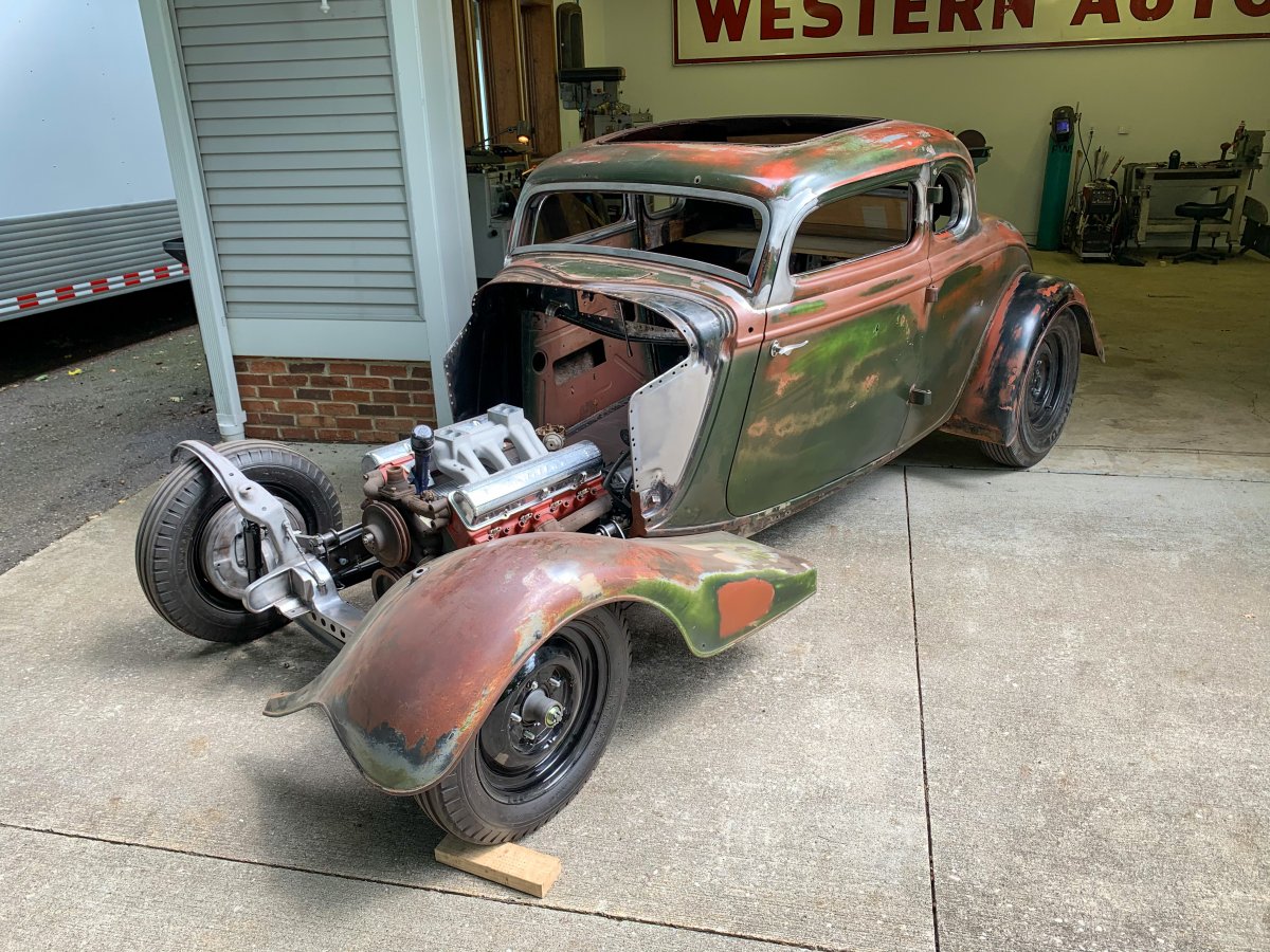

    I had a couple buddies stop by this morning so we could sit the body onto the ch***is. Fortunately, it went right on, and the bolt holes lined up - the frame jig did its job! I bolted down the body, so now I'll be able to plug weld the subrails to the new floor.
    The lower panel on the firewall is going to be set back a bit more than I originally thought, but I think it'll be worth the effort.

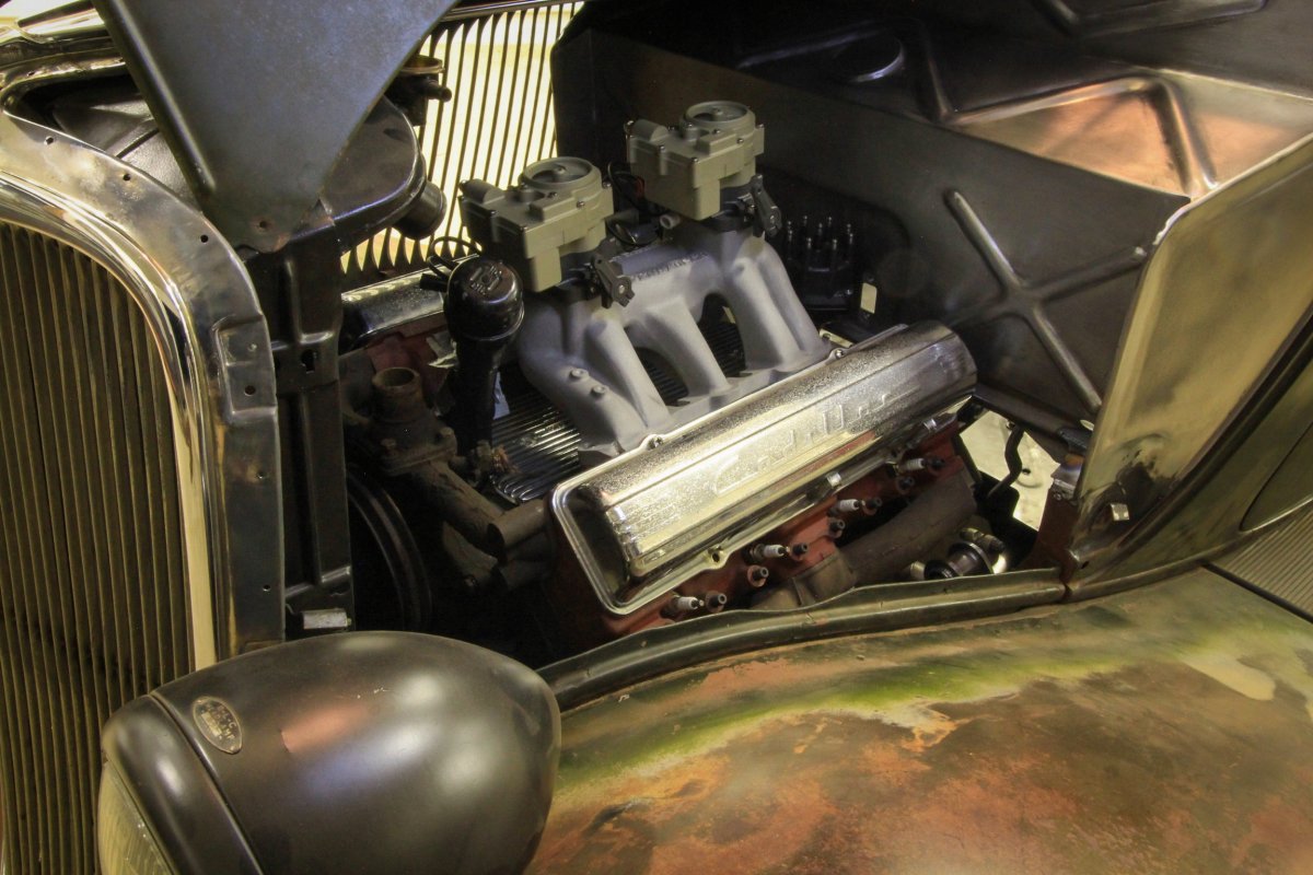

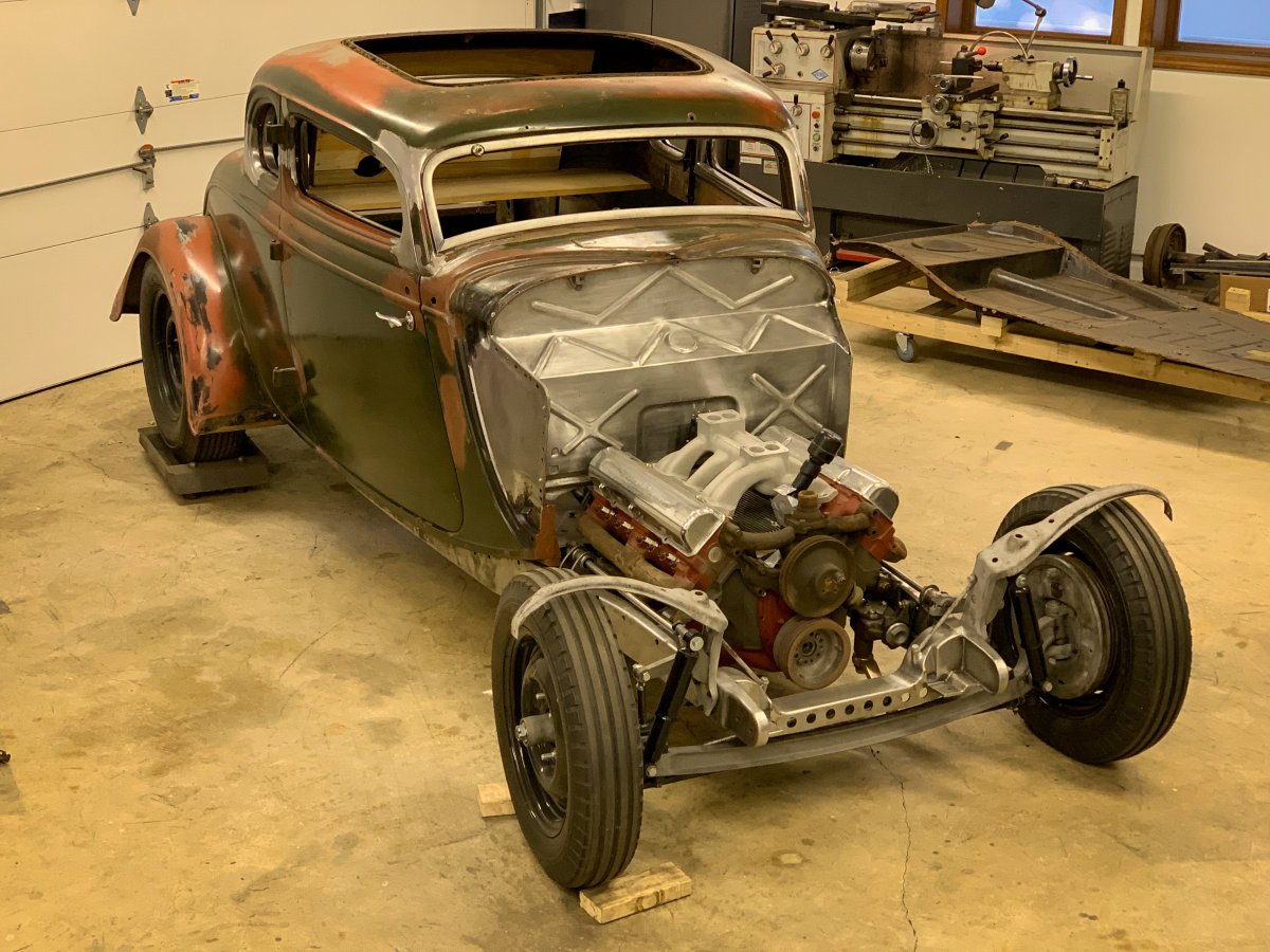

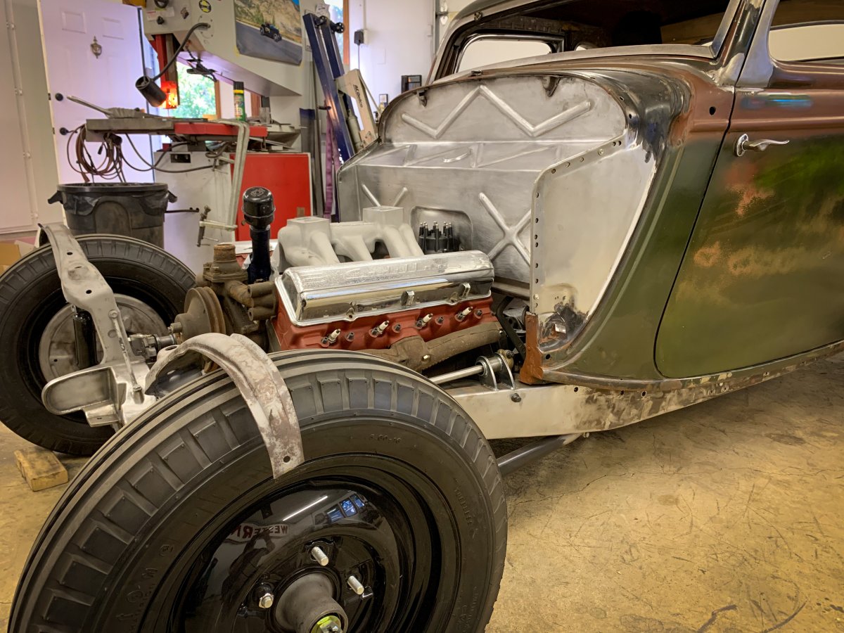

    I've been working on the firewall modifications to clear the Cadillac. Initially, I thought it was going to be 1-1.5" of set back, but it came in closer to 2". I began by cutting apart the firewall into three sections - the upper vertical, the angled mid, and the lower vertical. The upper vertical went right back into the car since it would be unmodified. The lower section got the spot weld flanges cut off, and new/deeper flanges added for the set back.
    With the angled mid panel getting shorter, the beads were going to be cut off. That's one detail that bugs me with setback/recessed firewalls. While I could add some beading to a new piece of sheetmetal with Dan's pullmax, I decided to try something I saw here on the HAMB - the angled mid panel from a '40 Ford firewall. It has similar beading, but more importantly, the distance is less, fitting in my new window.

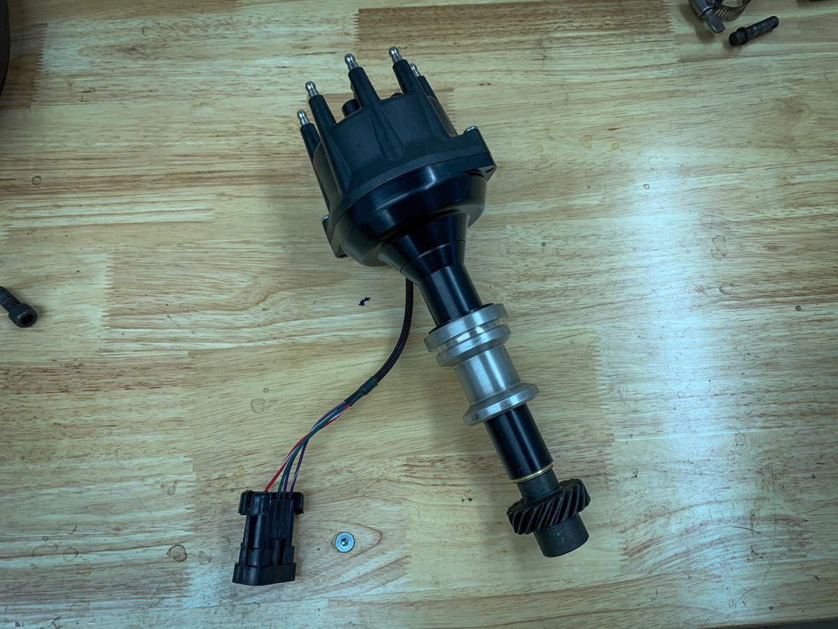

    Before I welded everything together, I need to verify my distributor clearance was sufficient. I had been using a stock Delco distributor up until this point, but the car was going to eventually get a Holley Dual Sync for the OT digital timing and fuel injection. Holley doesn't make a distributor for Cadillacs, so I was going to have to make something on the shelf work.
    I had read somewhere on the HAMB that someone used a SBF housing, and turned it down to fit the Cadillac. Either I couldn't find the proper SBF housing, or that was incorrect information as the Cadillac housing is ~1.902" where is enters the block. Both SBF and Pontiacs, which have large diameter housings, weren't any larger than that. With that knowledge now in my hands, I decided to order up a Dual Sync for a sbc/bbc and get to work modifying it to fit the Cadillac.

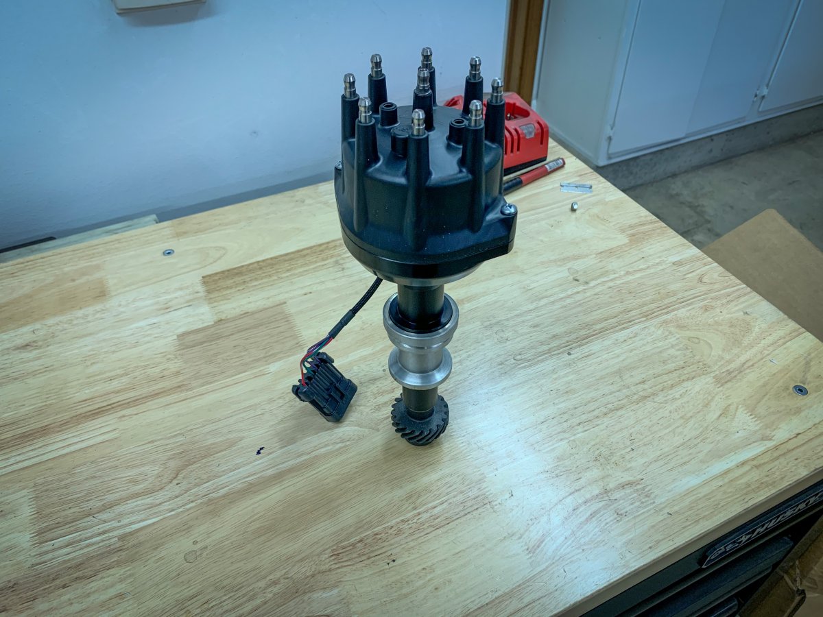

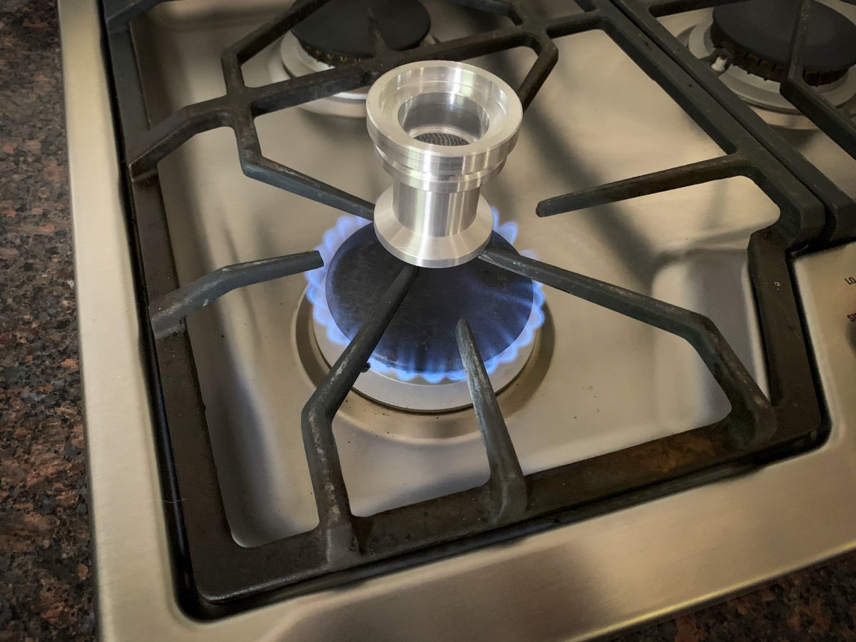

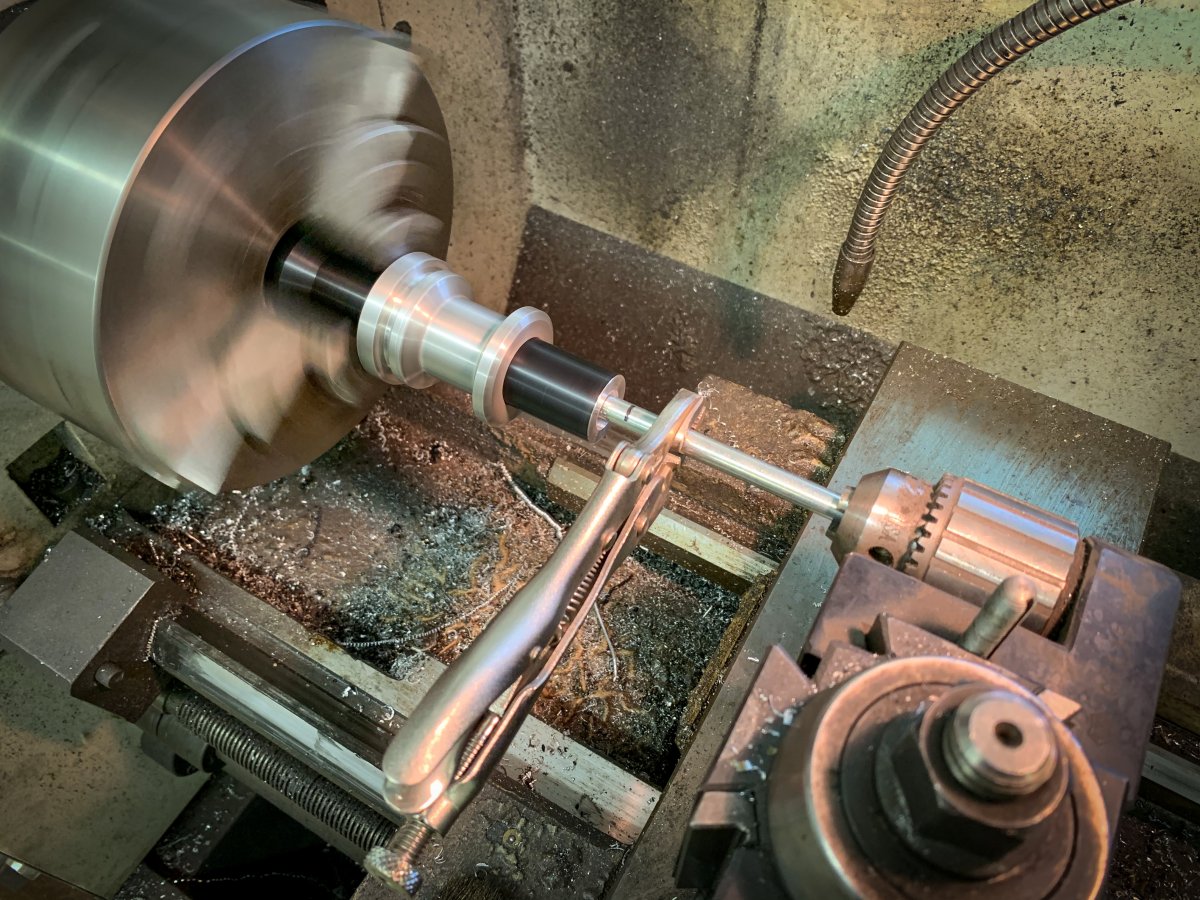

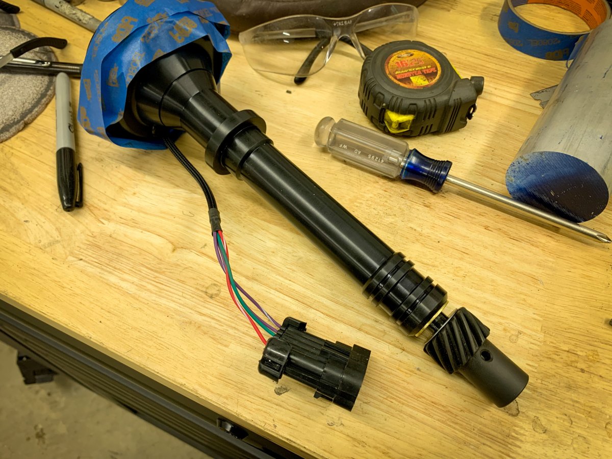

    Now the first thing someone is going to say is that the sbc/bbc distributor is CW rotation, while the Cadillac is CCW. That's correct, but the Dual Syncs don't care about which direction they're rotating since it's simply a hall effect sensor.
    First thing first, I dis***embled the Holley distributor. I machined up a bushing from 6061 on the lathe to have the dimensions of the Cadillac, but have an interference fit of the sbc/bbc housing. I then cut off the end of the distributor since it needed to be shortened anyway. I put the bushing on the gas stove, and the housing in the freezer for a couple minutes, allowing the pieces to easily fit together.
    When the temperatures cooled, I measured and cut the housing to the correct Cadillac length. I then had to bore the end a bit to allow the lower bushing to be pressed in.
    With the housing finished, I reinstalled the shaft to measure the correct length. I cut that on the bandsaw, then faced the end, and turned the diameter back about ~0.015" so that the Cadillac gear could go on. After drilling the shaft for the pin hole, I was finally able to ***embly my newly converted Cadillac distributor!

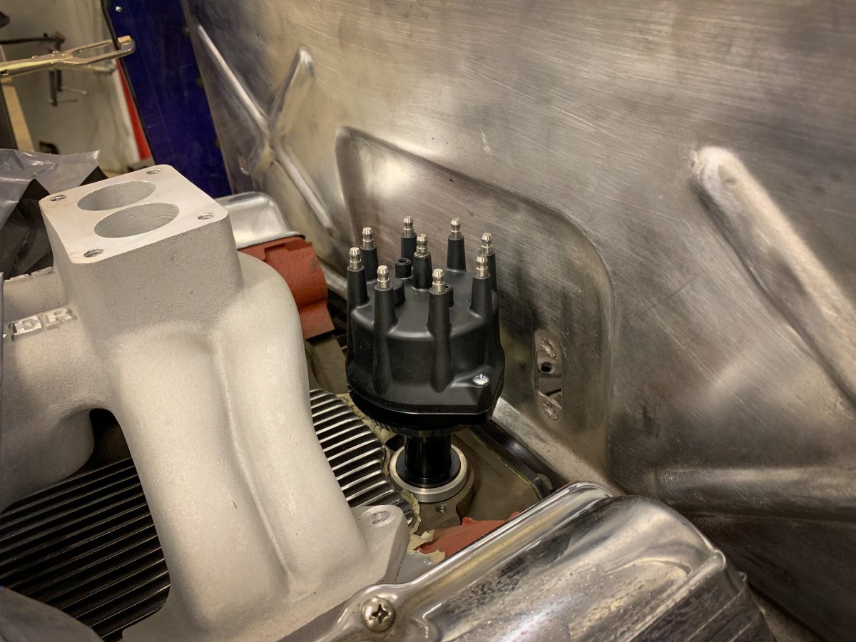

    With the distributor done, I put it in the engine and confirmed I still have enough clearance. That allowed me to get to work welding the firewall pieces together. I put the firewall back in the car tonight, held in place with some sheet metal screws. Hopefully this week, I get the firewall and floors welded to the body.

    Are you sure you sectioned that firewall? Or did the Lord send it down like that?
    I can't for the life of me see the seams between the sections. Did you leave the bends in the slanted '40 piece and **** weld or.........?

    You should put a gauge in the 40 Ford circle.

    It'll get something there to embellish it? I originally thought about removing that from the firewall, but thought it would be cool to see who recognizes what it's from.

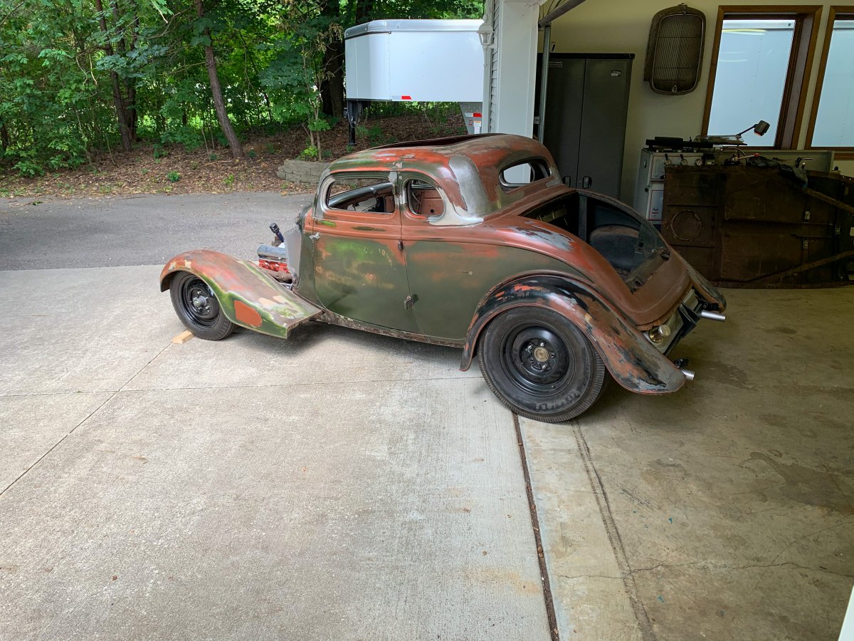

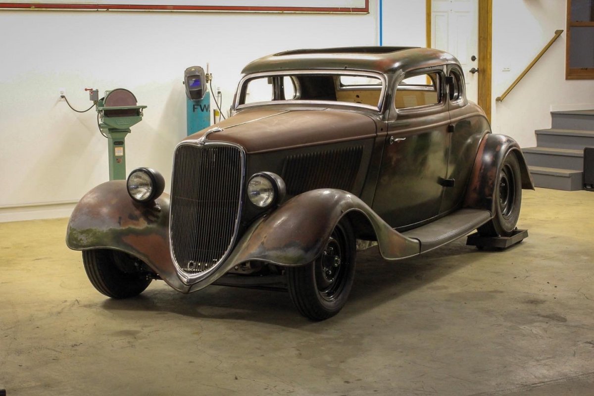

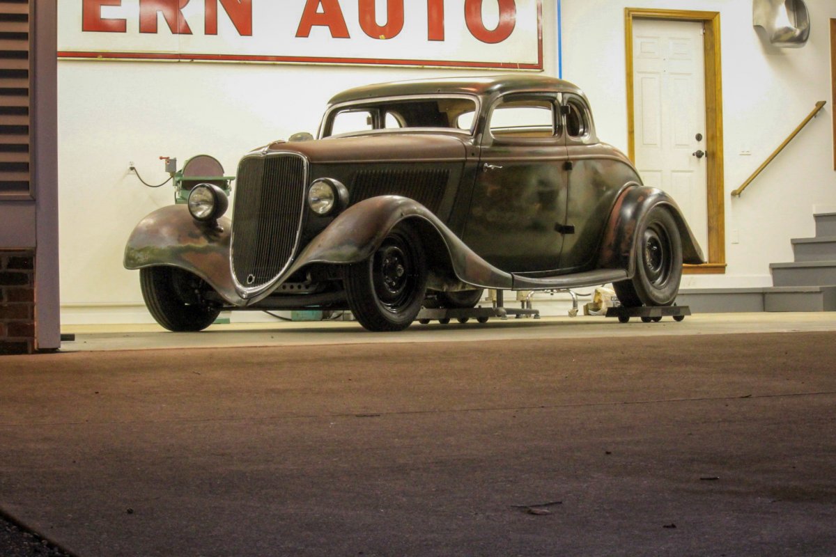

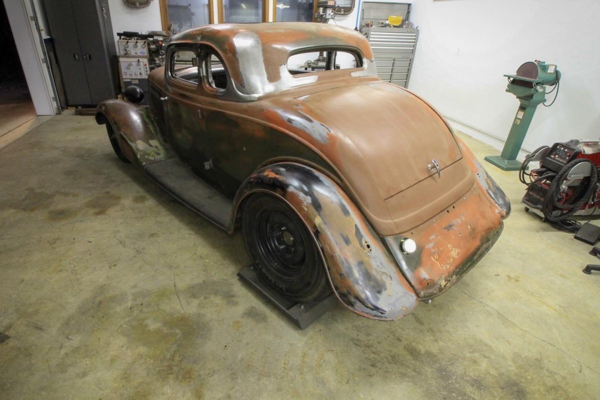

    Not much new to update other than I put the sheet metal back on the car for the first time in nearly a year. Felt good to stand back and see it as a whole car again. Don't mind the dollies under the rear - I'm using those to mock up what the car will sit like with 7.50s on it.
    It was a lot of work to make sure nothing hung down low on the ch***is, but that low shot shows why it's worth the work.

    Cory, looking at the last shot, with your engineering capabilities, you could power those dollies by spinning the rear wheels, and maybe start a new fad . That car has one hell of a profile !

    Thanks Marty! Maybe a gilmer belt with a couple pulleys, and we can make that happen!

    I'm a bit torn because the car has great patina, but I've destroyed large areas with the chop. I also plan to gap the panels, which is only going to further destroy the patina.
    I originally thought about "faking" the patina back in, but I came to my senses and decided it would be right to just strip the car. As for color, I'm not sure yet.
