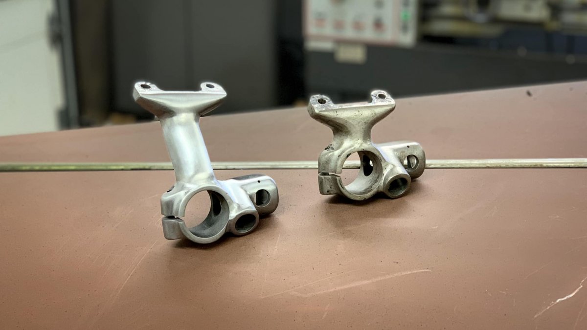

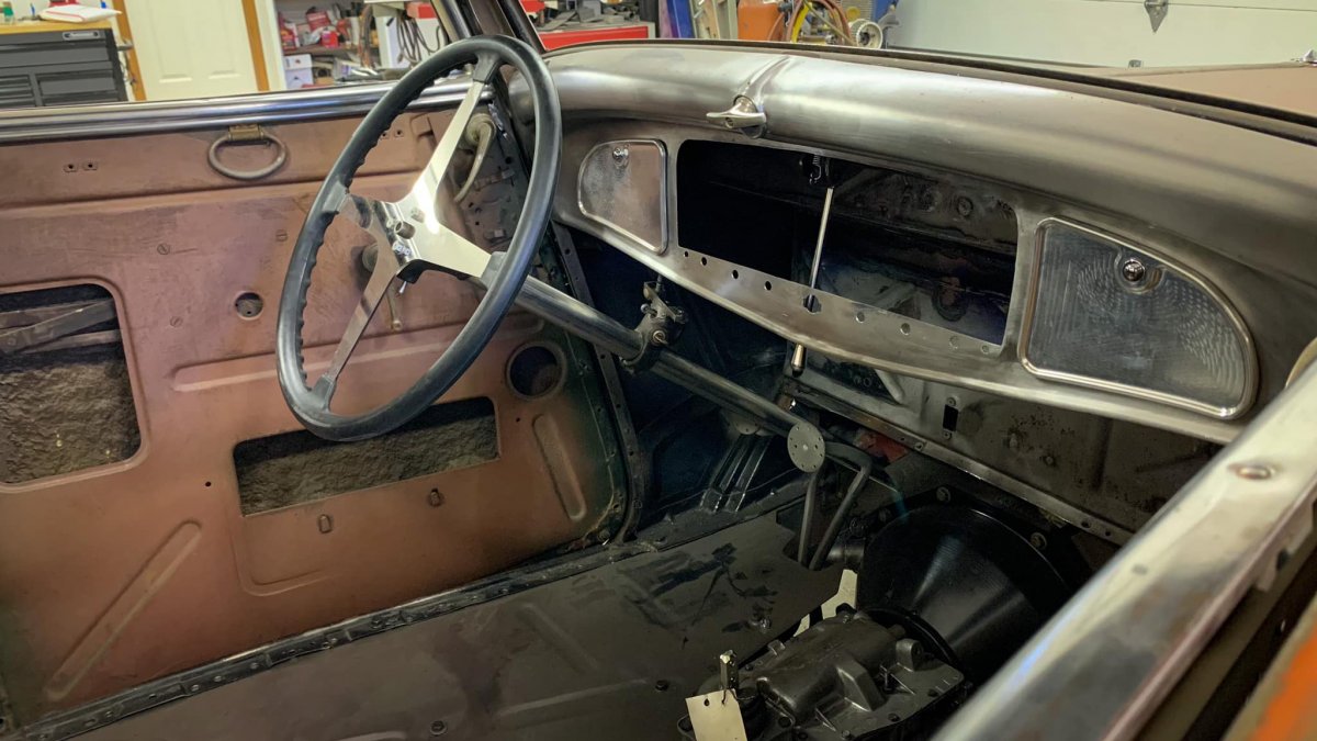

    I'm getting a plan together to wrap up the last bit of interior fabrication on the car, and started off with the steering column. One thing that became clear quickly was that the seating position on a '33-34 is a lot farther back than a '32. That means getting to some of the dash controls might be a bit of an inconvenience, especially for something that you may need to use often - turn signals and high/low beams.
    I had an idea of packaging two miniature Mil-Spec toggle switches in a custom column tube bell/flare, behind the steering wheel. I gave it a shot in CAD to get a design I was happy with, then had it 3D printed in plastic for mockup to make sure I was happy with the design.
    130569956_10100316359894569_3059069661500894298_o.jpg 130681094_10100316360044269_8091388996704144945_o.jpg 130939037_10100316359984389_3500465049858879020_o.jpg
    The 3D printed piece allowed the upper column bearing to be installed, as well as both switches. That was pushed into a piece of 1.5" tubing, formally mocking up the whole ***embly. I was happy with the concept, with the switches being easily accessible while remaining out of sight for the most part.
    130551090_10100316359924509_9014199158116316791_o.jpg 130195068_10100316360139079_3739884262911506991_o.jpg

    I ordered up that steering column bell to be machined out of stainless, matching the column tube. It should look good fully polished!

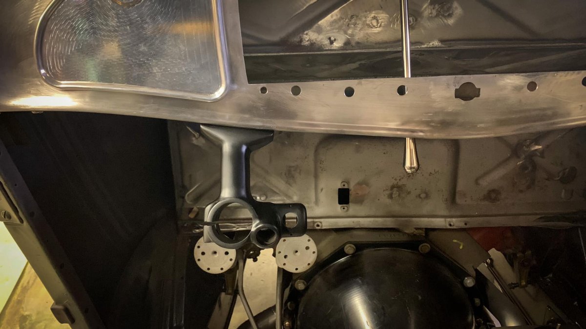

    I turned my attention to getting a column drop built for the car. I chose to use a '35 drop as the starting point, cutting and stretching it down to a length that provided a comfortable wheel position.
    I shot some etching primer on it for now, but I'm wondering if it would look better chromed to go along with the polishing column? I have time to figure it out......
    Again, another mockup to make sure everything was shaping up well.
    131934596_10100317954034899_1622441587273620420_o.jpg 132400572_10100317953980009_2507132100449342006_o.jpg

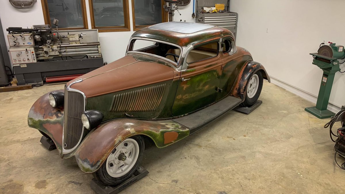

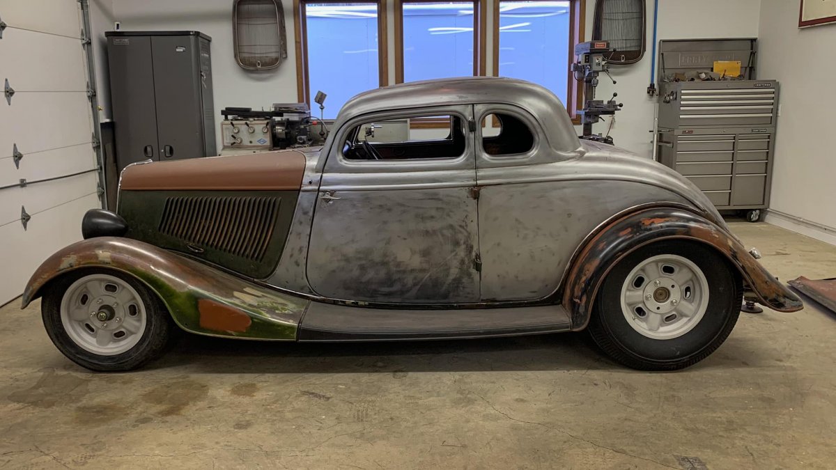

    I picked up a Walden roof insert panel about a year ago, with it patiently waiting on the shelf. I wasn't going to fill this roof, but trim his panel down to fit under the stock tack strip moldings.
    I first started off by fitting the tack strip moldings to the body opening a bit better than factory. With the help of a rosebud, I carefully tweaked the moldings, making their fitment follow the body more consistently. I ended up fitting them a bit tighter to the body, taking a longer run, which meant I came up about 1/2" short from the back moldings meeting in the middle! Fortunately, I had some sedan moldings where I could rob a piece off to weld onto my coupe moldings.
    With the tack strip moldings fit, I trimmed down the Walden panel, carefully sneaking up on the right size to fit under the moldings. I chose to add six attachments to the panel, taking some of the work off of the tack strip moldings. I welded nuts to the bottom of the Walden panel (forcing me to then planish out those welds), then welded tabs to the opening of the roof. Now there are six 5/16" bolts that help pull down the panel.
    The tack strip moldings are fastened down with several 3-48 machine screws.
    132080253_10100317953820329_5340793495813959581_o.jpg 132201168_10100317953835299_106126733262746579_o.jpg

    I'm jumping around just a bit, but I think my next project to tackle is gapping the doors and decklid. I got a bit side tracked (and carried away), with the DA the other day.
    I guess this is the point of no return!

    Bobby's panel fit great! I'll wrap this with vinyl for a stock look....but a much smoother look.
