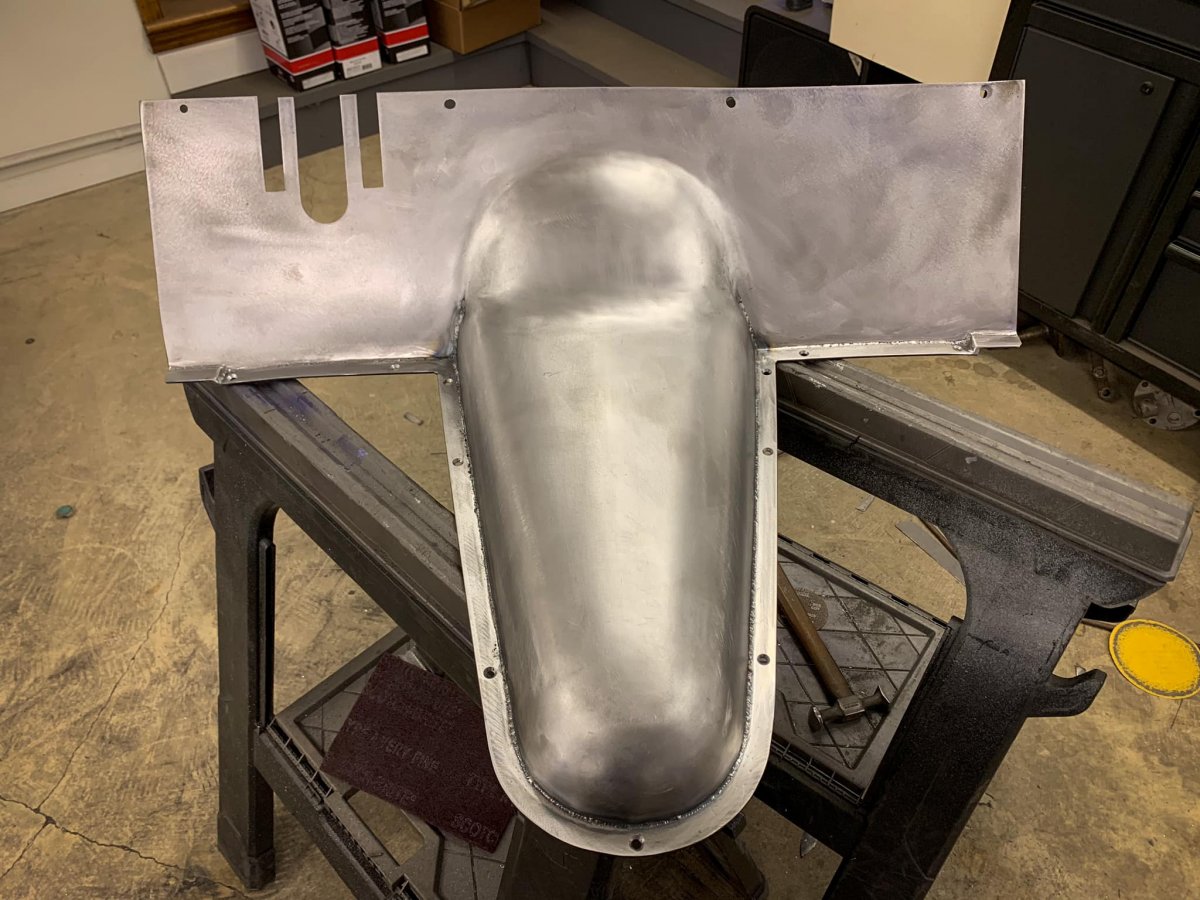

    It's been a while since I updated this thread, but it wasn't because I haven't been working on the car.....I've been thrashing on it!

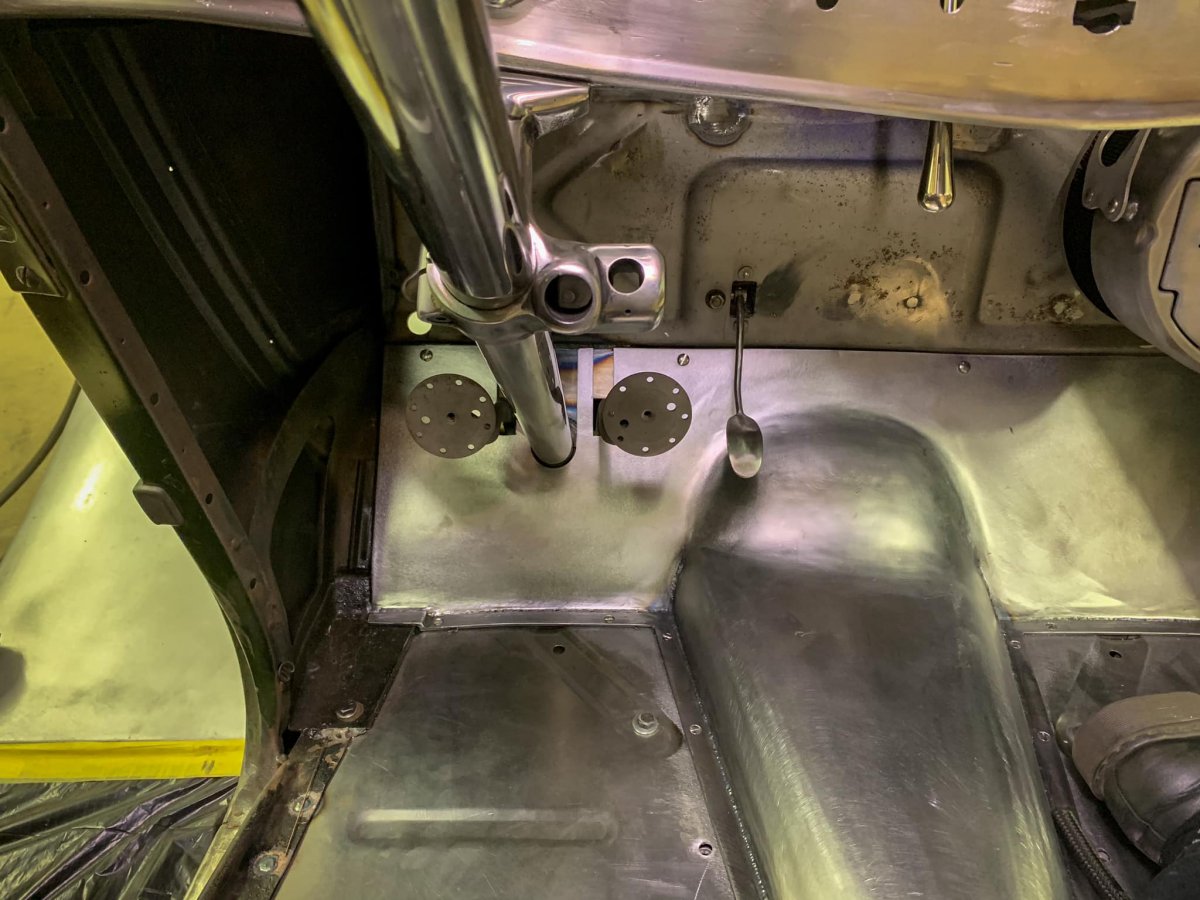

    I needed to finish off the front floor area of the car, with the project revolving around the toeboard and trans tunnel. I decided to build one complete unit, fastened in place with several machine screws.
    The toeboards are 16g, and the tunnel is 18g, both with a lower perimeter in a 1/8" flange to fasten to the floor and firewall.

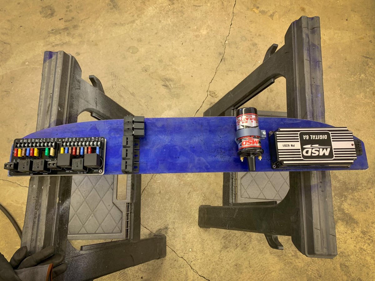

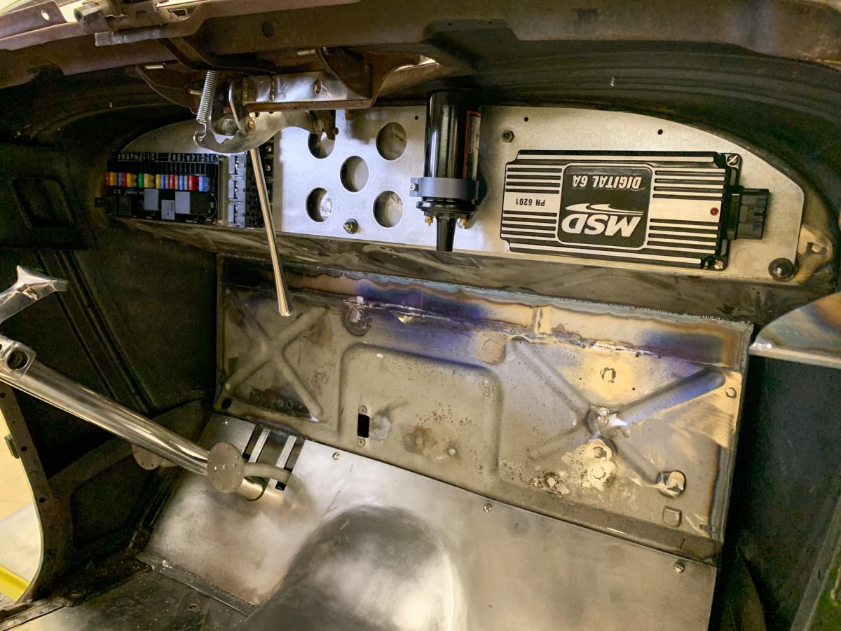

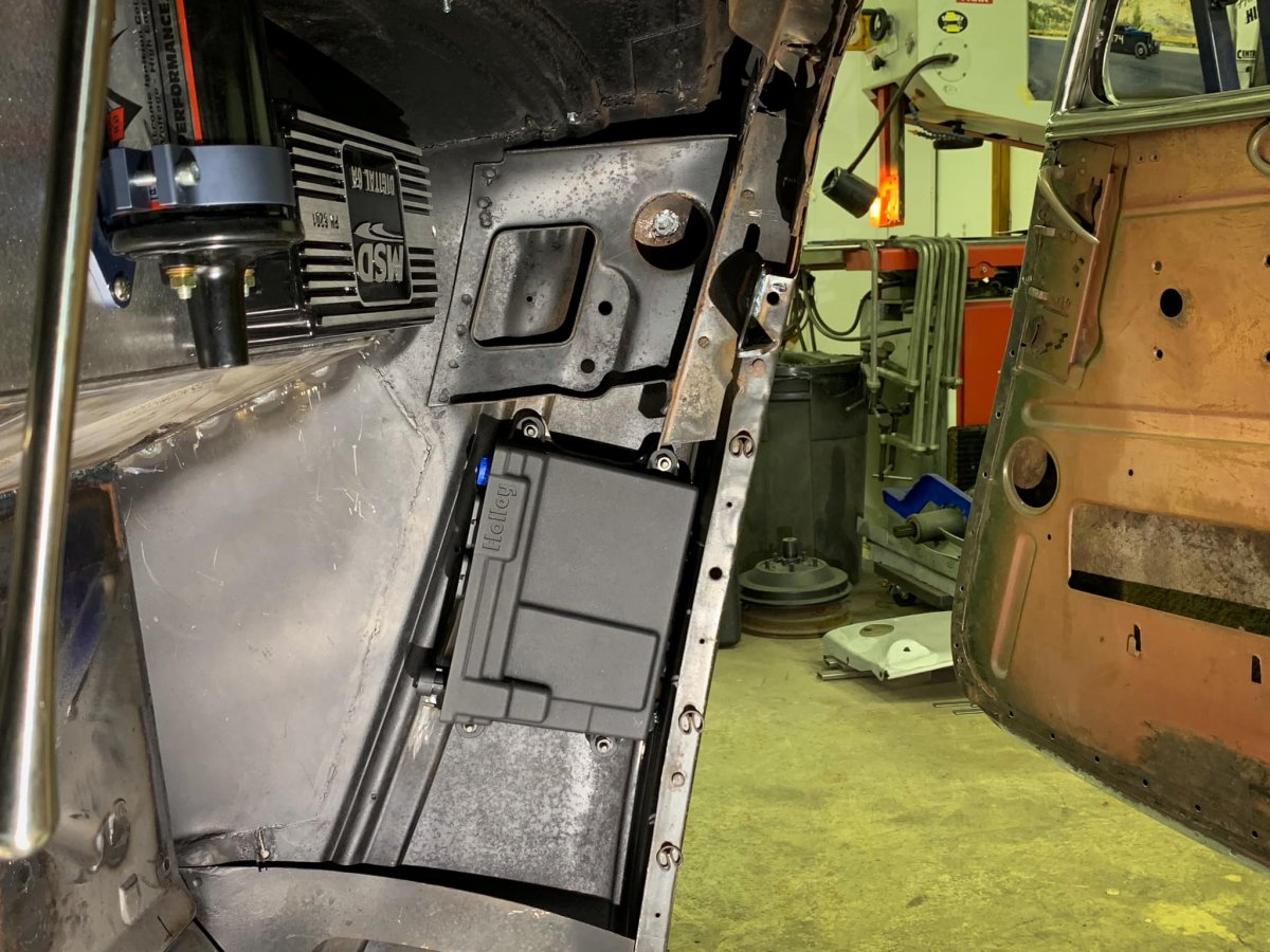

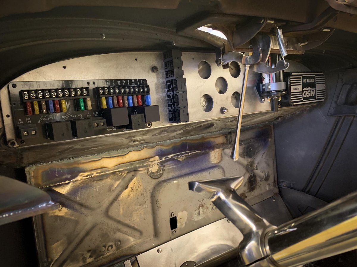

    With the floor closed up, I started working on a removable panel to house all of the interior electronics for the car. I made the panel out of 1/8" steel, fastened with a half dozen 1/4-28 nuts. This will allow me to prewire some of the car on the bench, before hanging it under the dash.
    Ignore the OT fuel injection controller, but admire the bracket I made to hide it behind the p***enger kick panel!

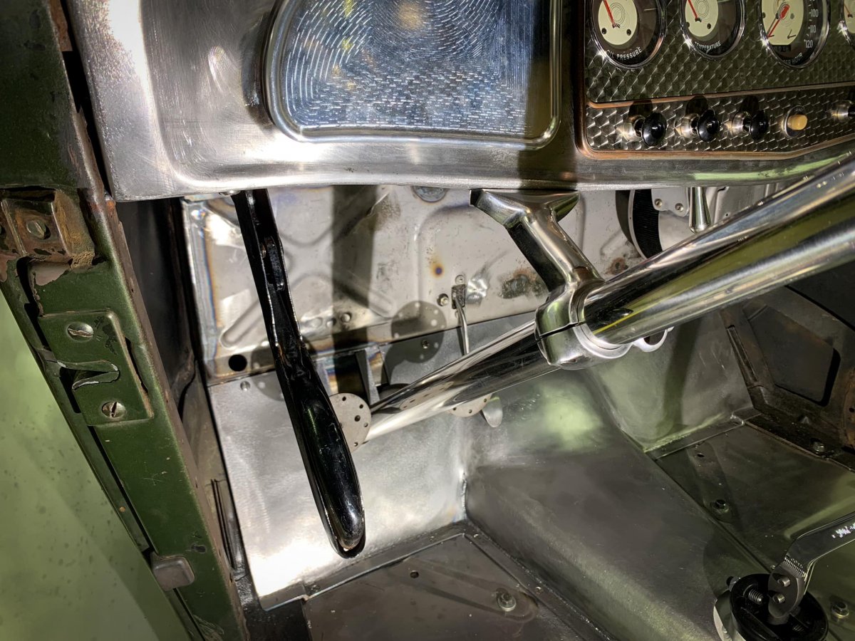

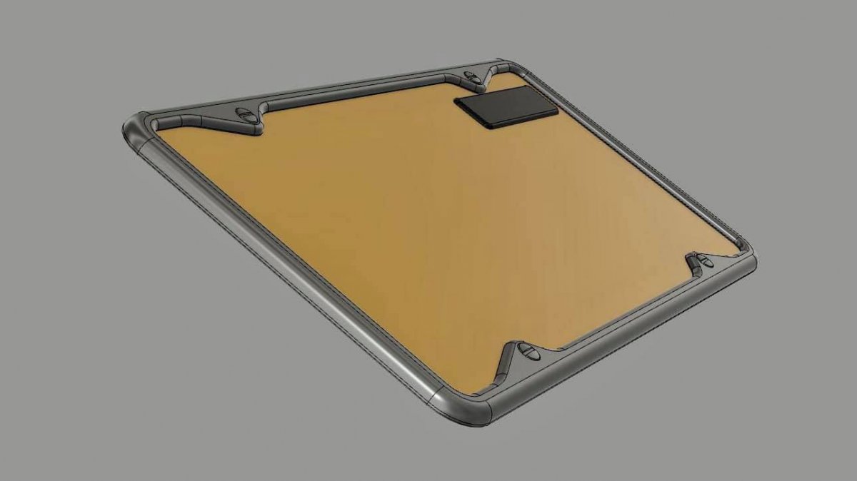

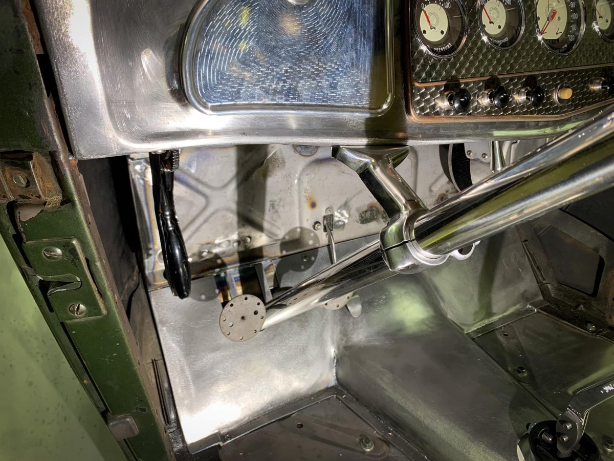

    I also modified a '33-34 pedal to fit back into the car, with a left hand arm exit.

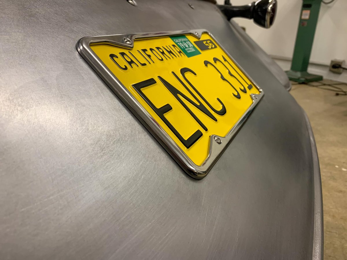

    While I had been working on this stuff, I had a license plate frame getting machined out of stainless too. I designed a California-esq frame, but scaled down to look less bulky.

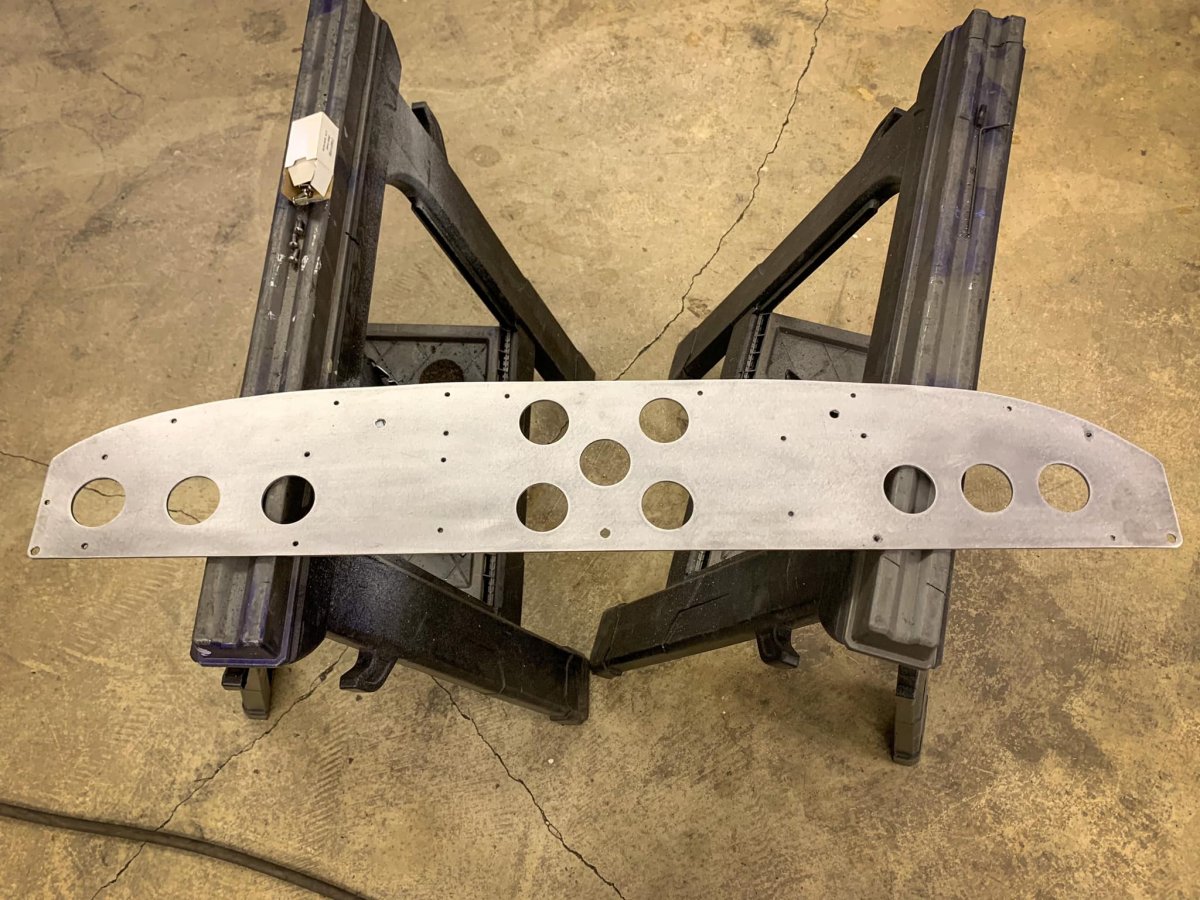

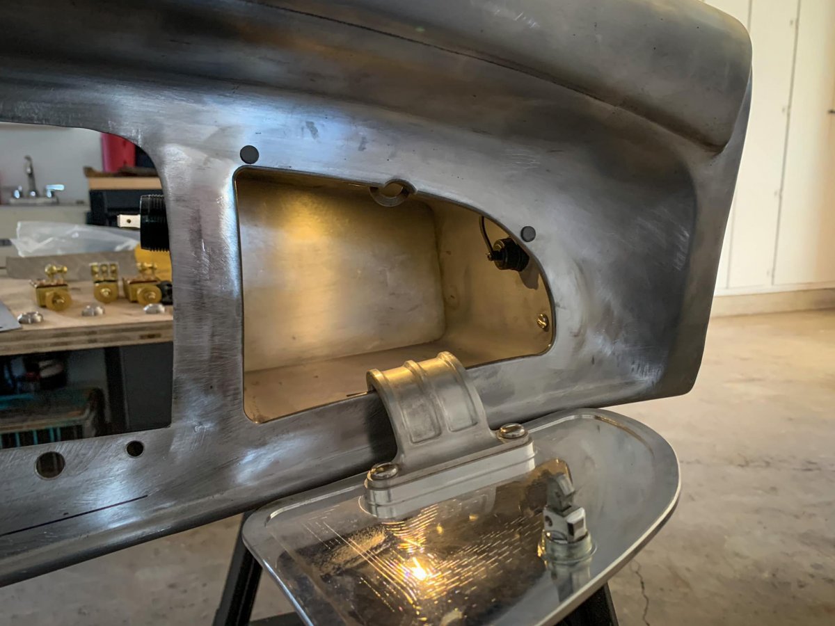

    With the list of interior items narrowing up, I started building the gloveboxes for the dash. I formed up some 18g boxes, with the rear wall removable. That makes getting access to things behind easy, but it's also going to make the upholsterer's job easier when he wraps them in felt!
    Each box has a pair of USB charging ports, and an overhead LED light (that will be tied into the dome light circuit). In the p***enger box, I added a mini-USB port to communicate to the OT injection controller. I also managed to tuck the heater valve on the outside of it next to the cowl, with a shaft p***ing through the box to control the water flow.

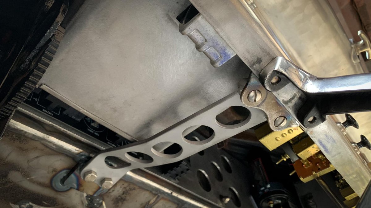

    One of the last projects inside was modifying a '40 park brake lever to fit in the car, and adding a steering column brace to take the load off the dash.

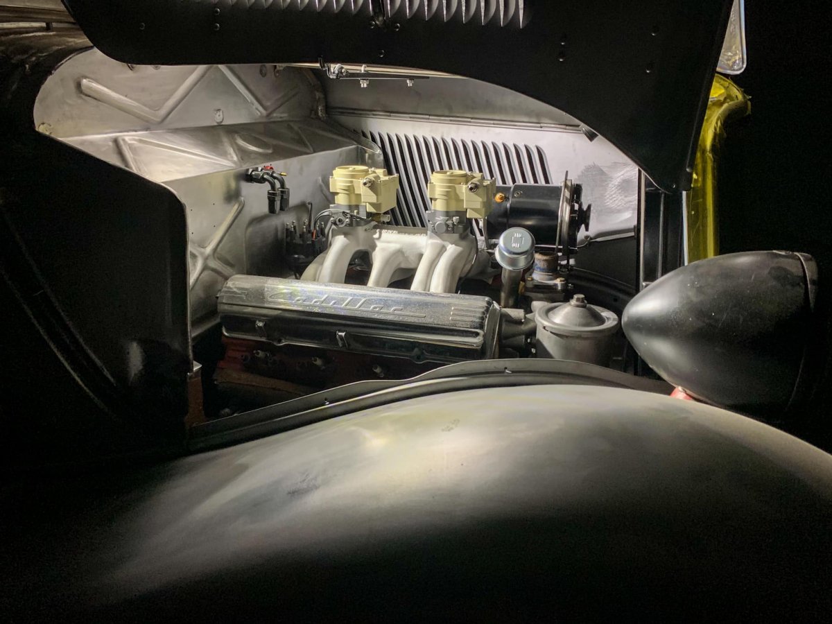

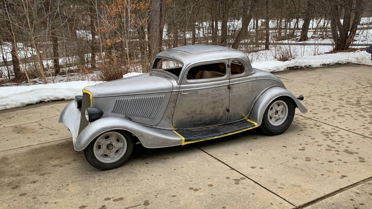

    By this time, we finally had a nice day in Michigan, so I rolled the car outside again to see how things were shaping up.

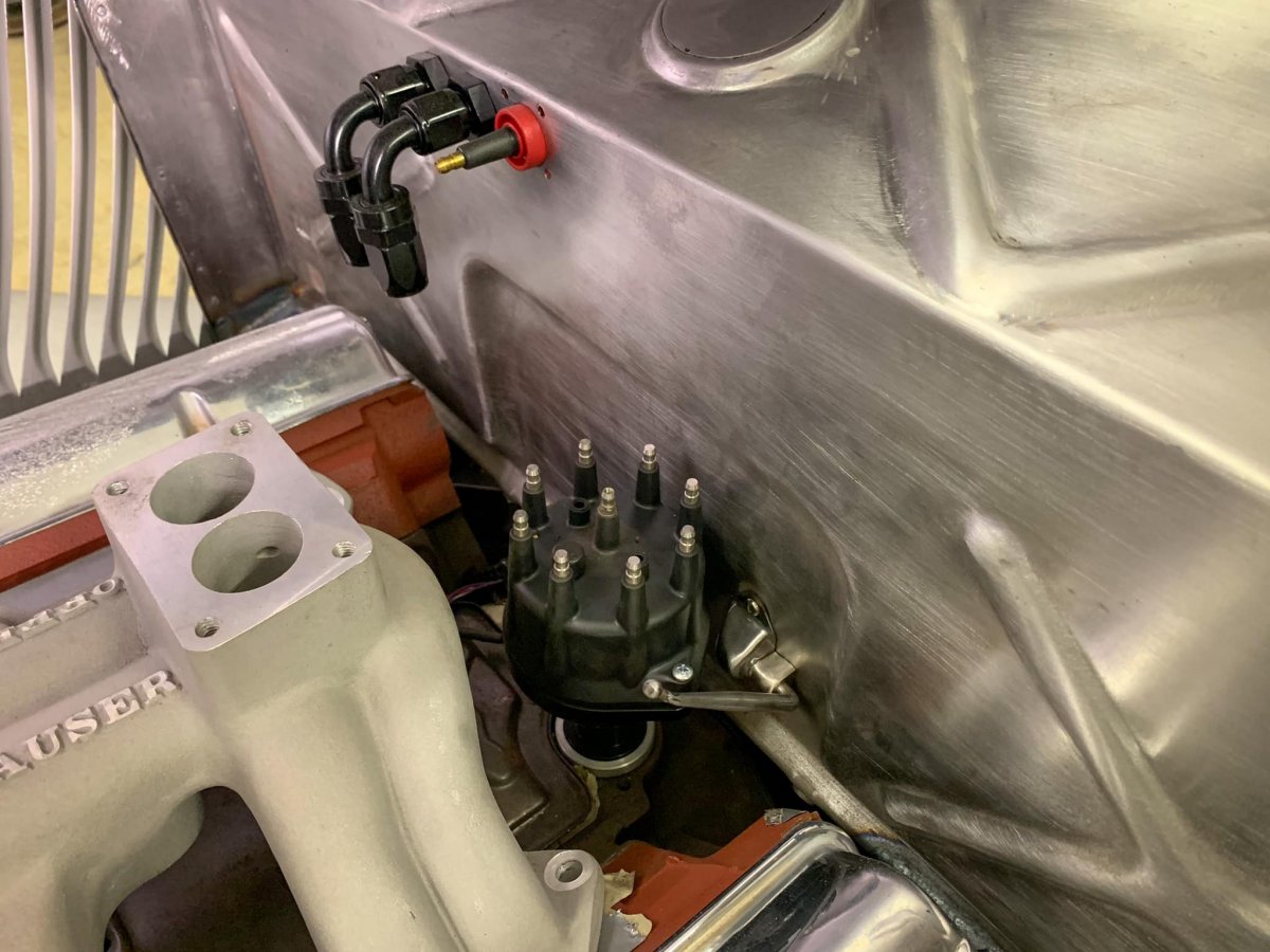

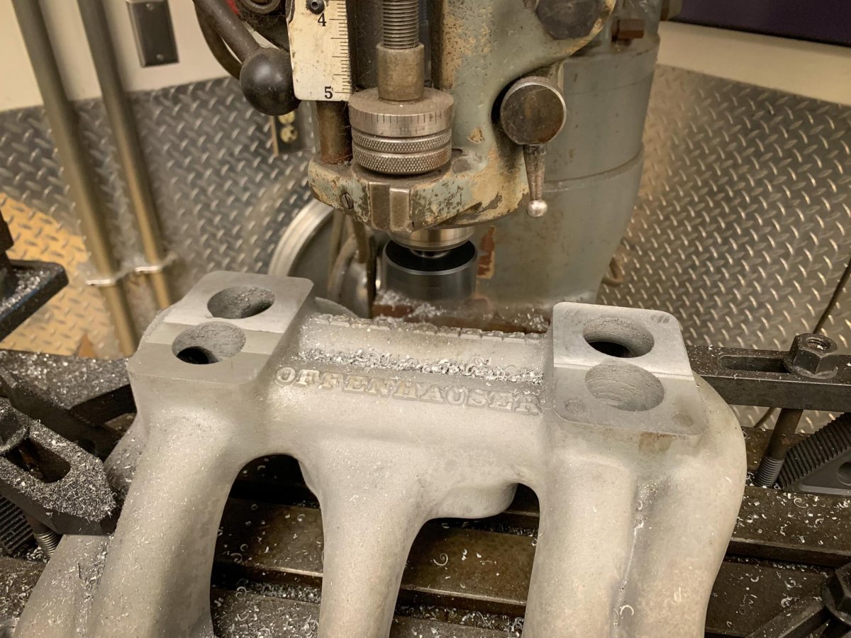

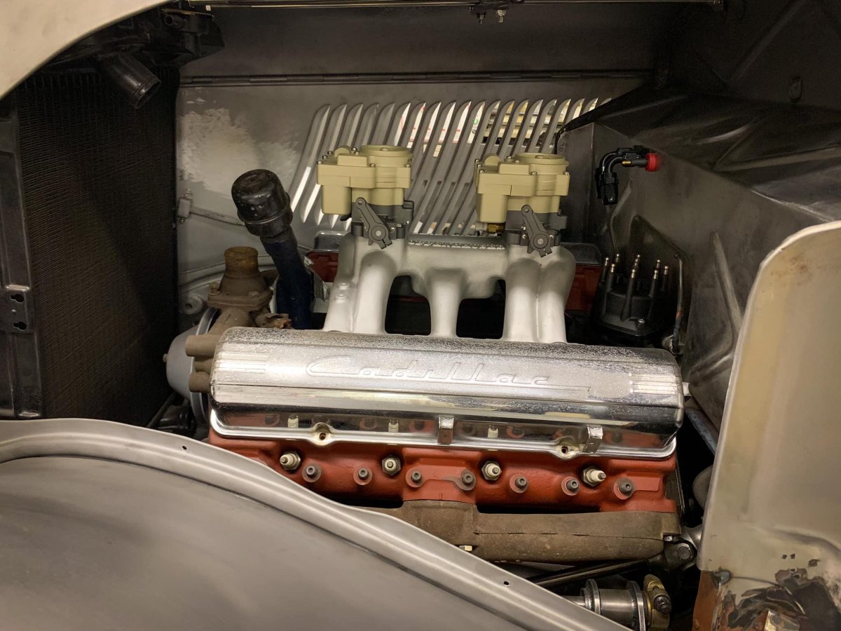

    My NOS Offenhauser 2x2 Cadillac intake looked great, but the angle in the carb bases must've been destined for a boat! I knew that I would eventually recut the bases, and finally got around to the project.
    I went up to Dan's to use his Bridgeport. The first step was the fixture the intake with the carb bases level. From there, I bored down through the 5/16-18" fastener holes with a 0.373" end mill. That allows me to press in some 0.375" slugs.
    With the slugs in place, I refixtured the intake with it level on the mill, and began flycutting the bases until I brought them to be on the same plane. I then redilled the fastener holes with the mill, keeping them perpendicular, and finished it by tapping it by hand.
    It looks much better now!

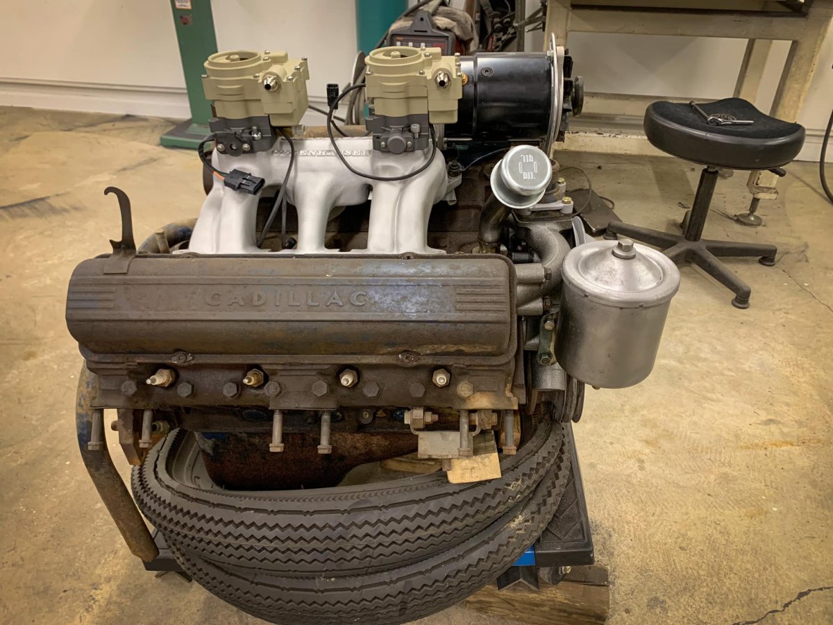

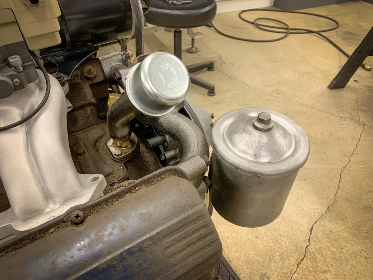

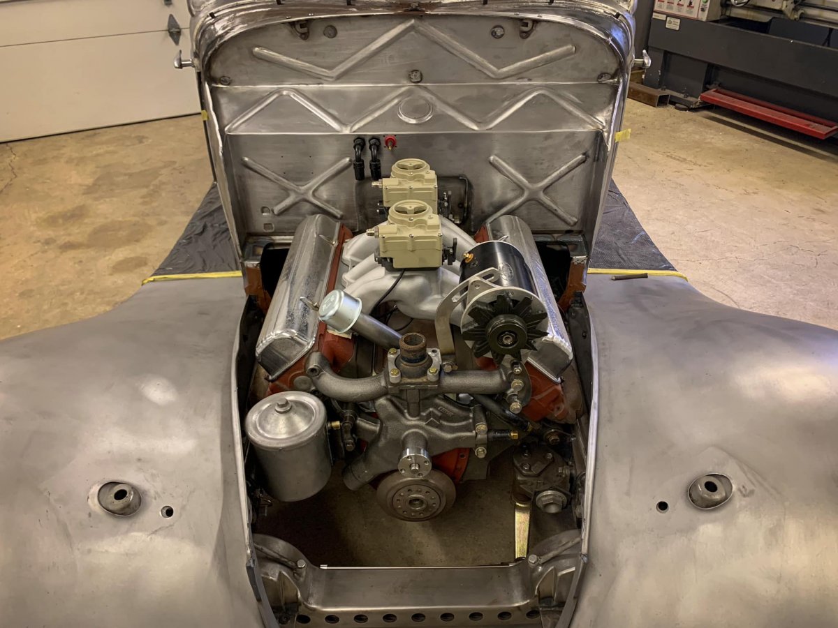

    I still needed to mount the PowerGen alternator, and factory byp*** oil filter in the quickly closing up engine bay. I used a mockup engine to build the brackets near my bench, allowing me to quickly confirm things on the car.
    I also built a new oil filler neck, sans the fuel pump provisions since this car won't need one.

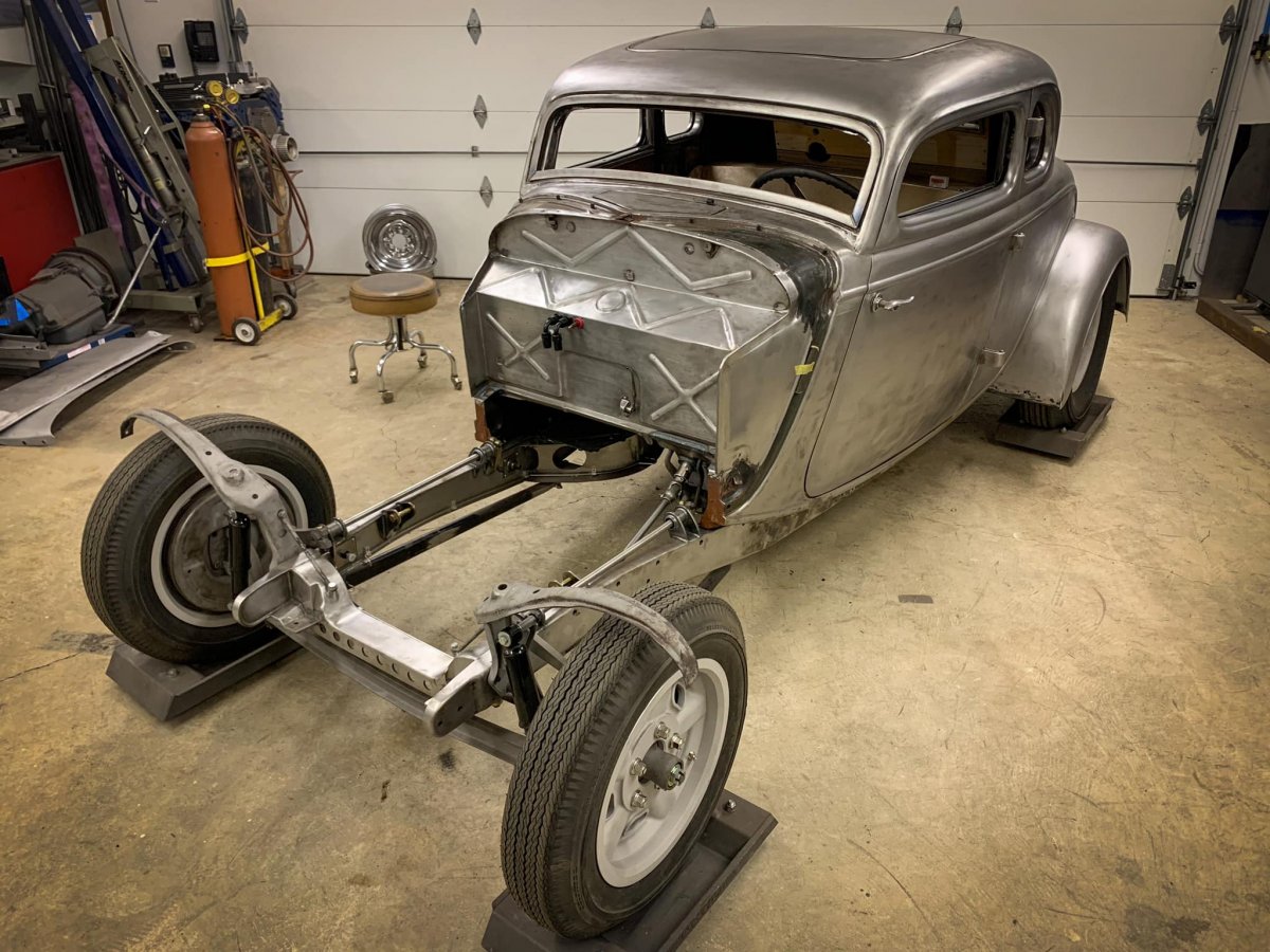

    At this point, my fabrication is dwindling for the car. I think I've pretty much covered everything that needs to be built for the car, which will make re***embling the car after paint much easier.
    Speaking of which, my date with the painter is soon, so I pulled the drivetrain out, and got to work stripping the last bit of paint from the car.
