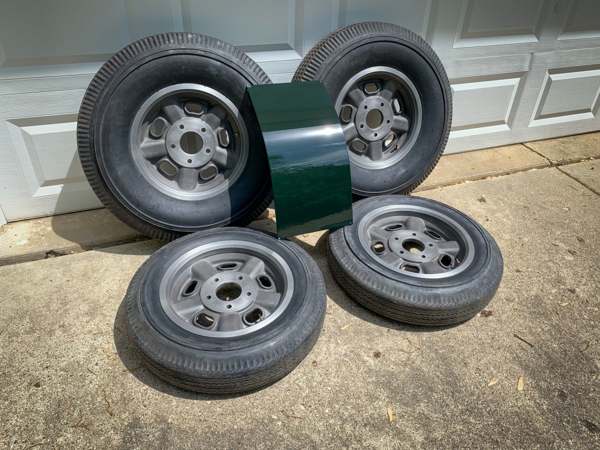

    I had a specific color in mind, and Matt did a color spray out for me. I hadn't seen the specific color in person, so I was anxious to actually see it up close - I can say that I'm very pleased with the choice.
    I think it's going to complement the magnesium wheels, and minimal plating well.

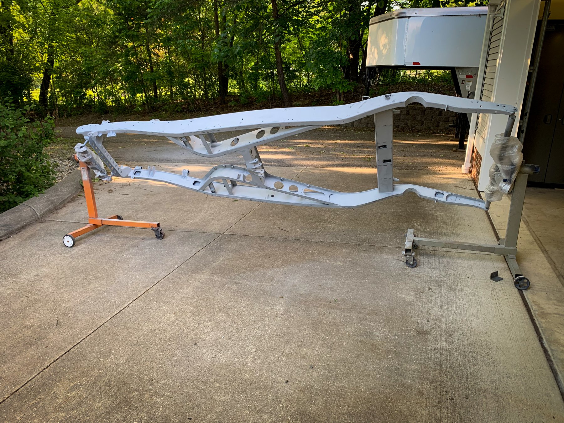

    While Matt’s been working on the body, I got the frame blasted at SS. I got it mounted to a couple engine stands to help get it ready for paint.
    In the background, I had the bar arms machined out of chromoly, then sent them down to Chalk Stix to have the splines broached.
    I also sent the manifolds out to get porcelain coated, which just came back as well.

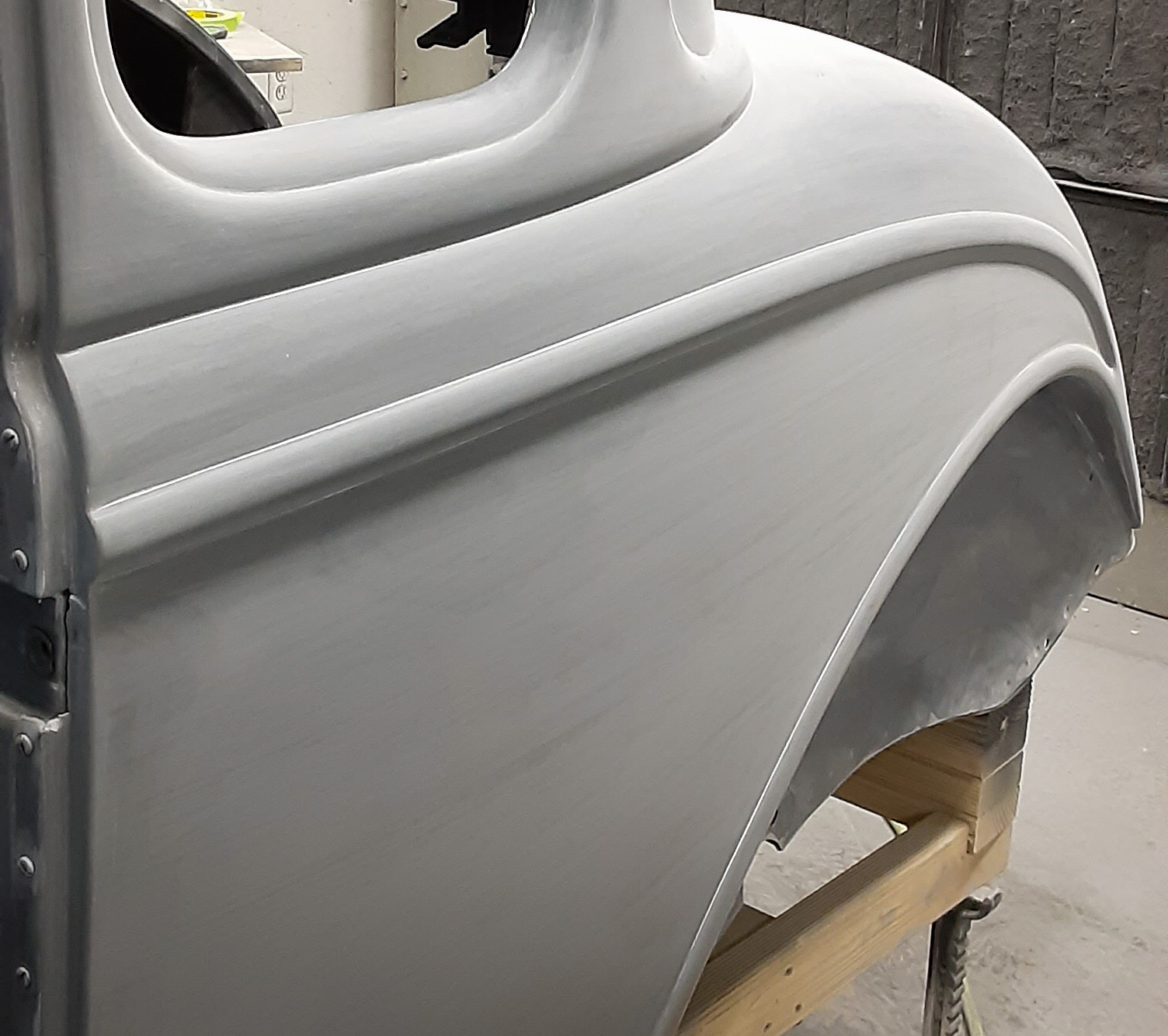

    Matt's got the body final blocked, ready to shoot color. His attention to detail really shows - how many times do you see painters today wash out the definition of body lines?
    He sprayed some solvent on it the other day to check his work - I'm ready to see color!
