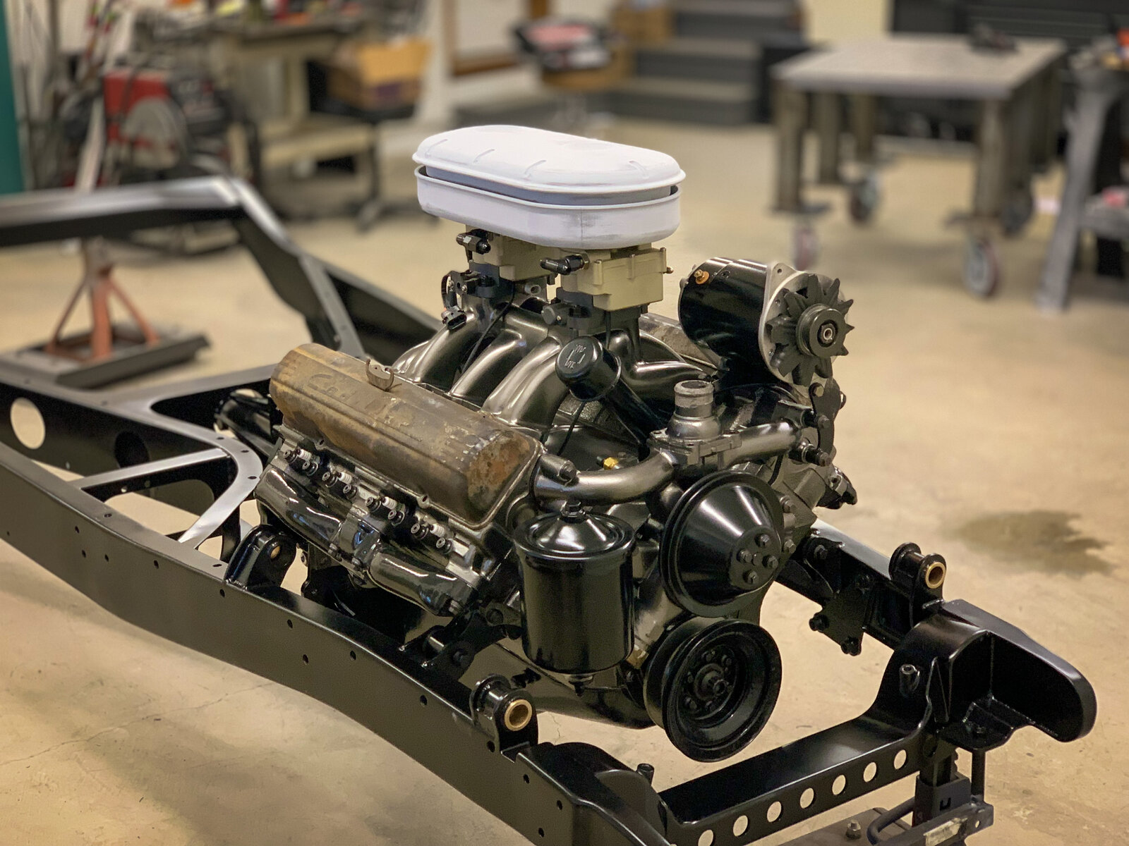

    With the engine and trans married, I decided to set them into the frame.

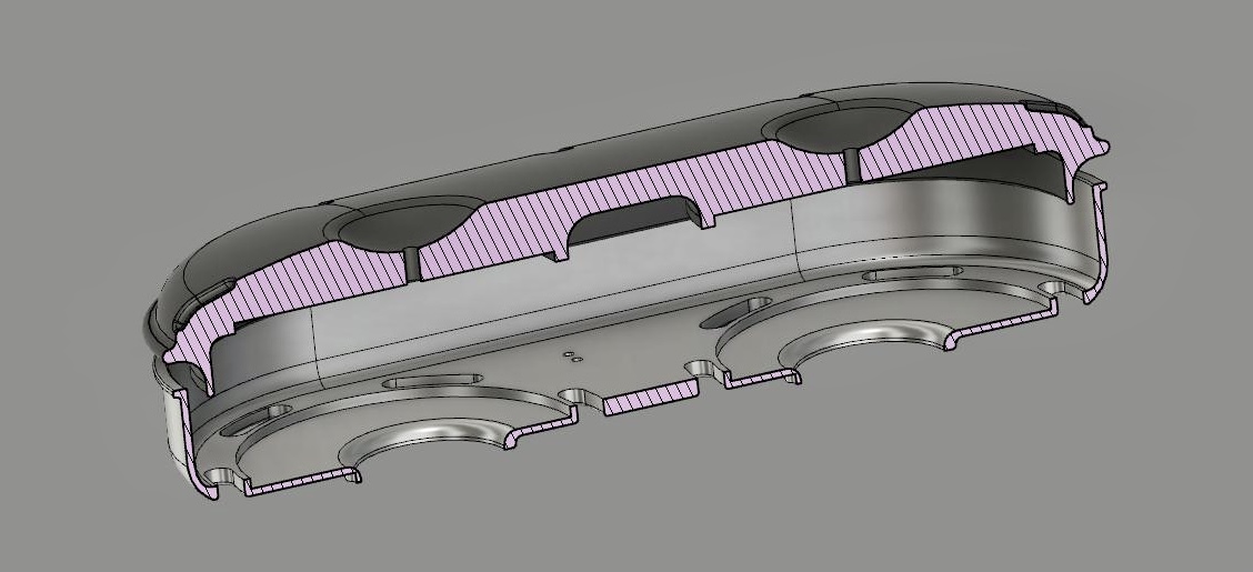

    A side note - a while back I designed an air cleaner for the engine in CAD. The body houses two elements for the throttle bodies, along with the OT IAC and Map sensors to keep them out of sight. As I had done on my roadster, I had the entire thing 3D printed. It could've been machined, but that's unnecessary weight on the throttle bodies, and cost from my wallet!
    Here are a couple shots of the CAD model:

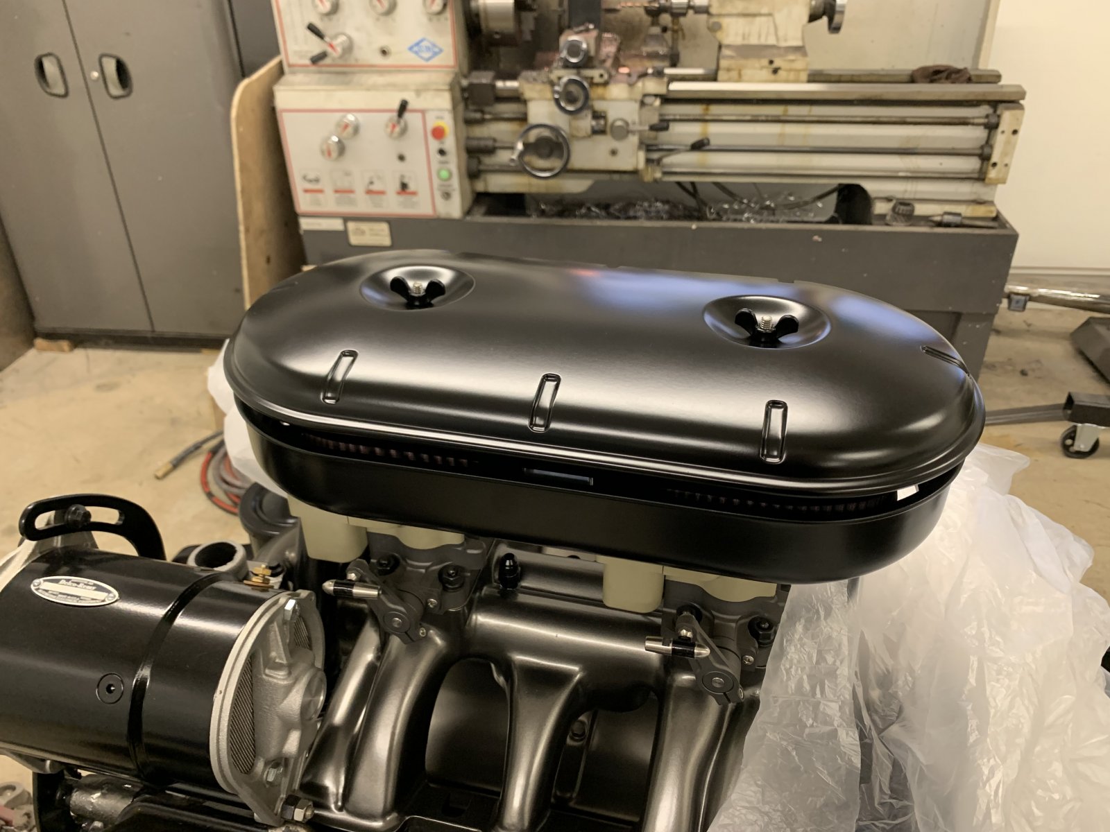

    I've been continuing at getting more small ch***is parts in satin black, and chipping away at getting the air cleaner ready to paint. This is the final coat of primer before blocking. The lid is sitting a bit high due to masking of the inside, but you can start to get an idea of the colors for the engine. Now I just need my valve covers back from the plater!

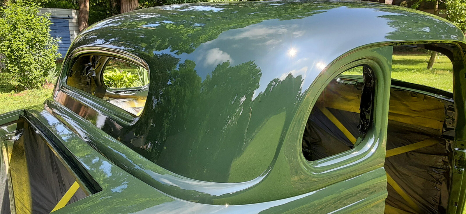

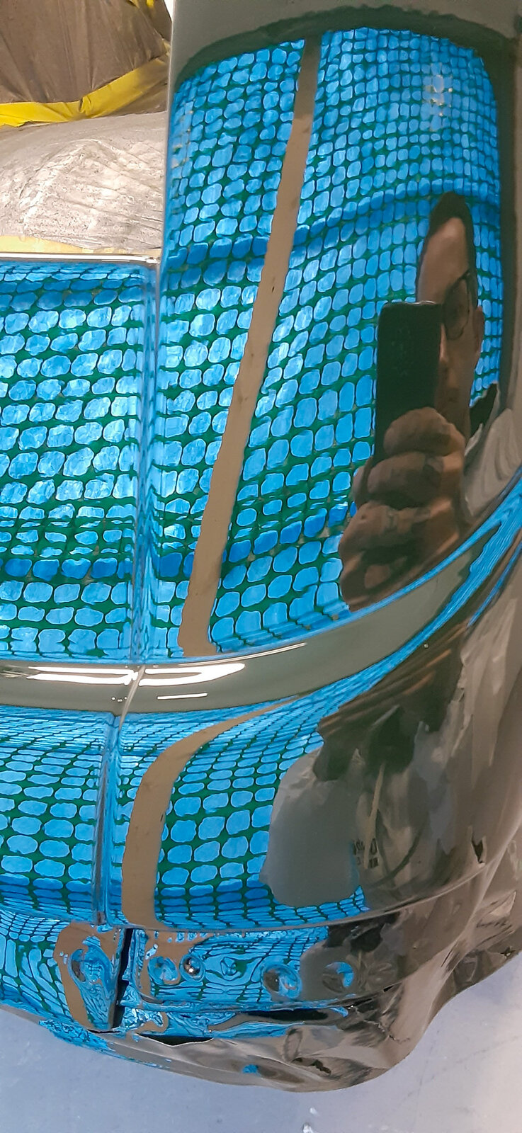

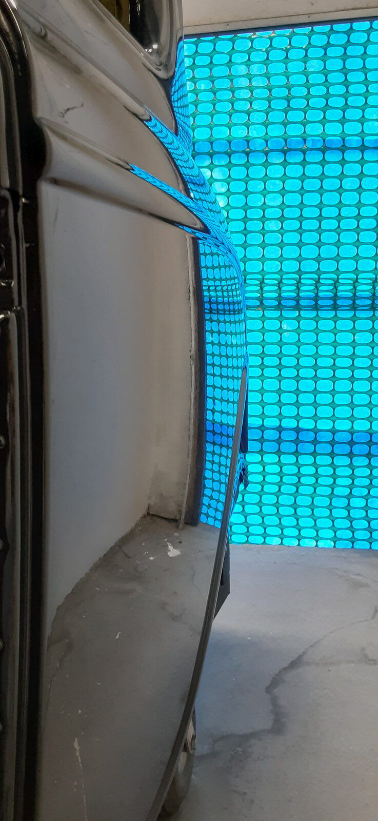

    Matt is starting to put down color, starting with the body and the swing metal. I haven't made it over to see the body in person yet, but the photos make it clear that his hard work shows!

    I'm real happy with the color. For it being a stock, off-t******lf code, it fits well on an early Ford.

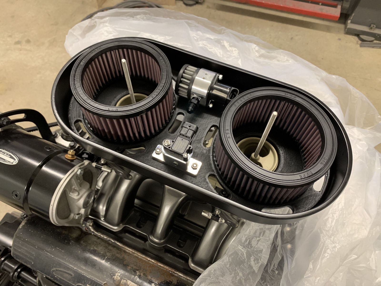

    I also got a few other things knocked off the list too. One of them was repainting the air cleaner due to my own fault of disturbing the first wet paint job! With the lid off, you can see the filters and the OT EFI hardware that's hidden inside.

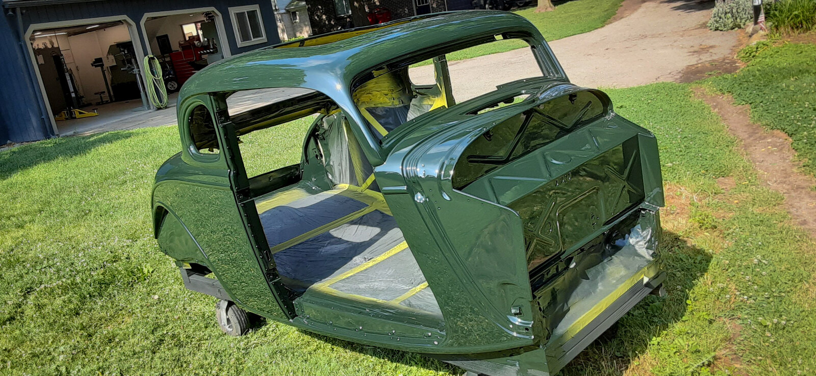

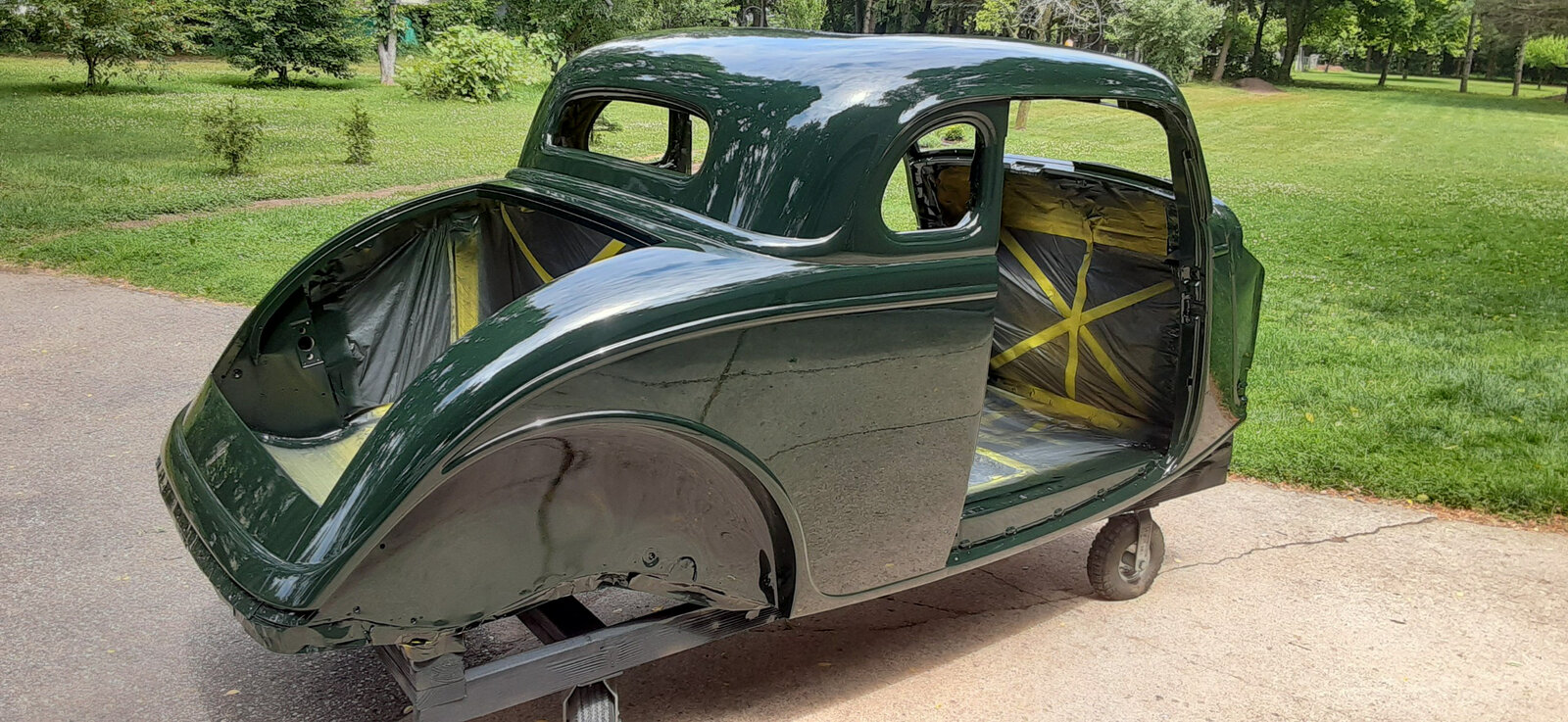

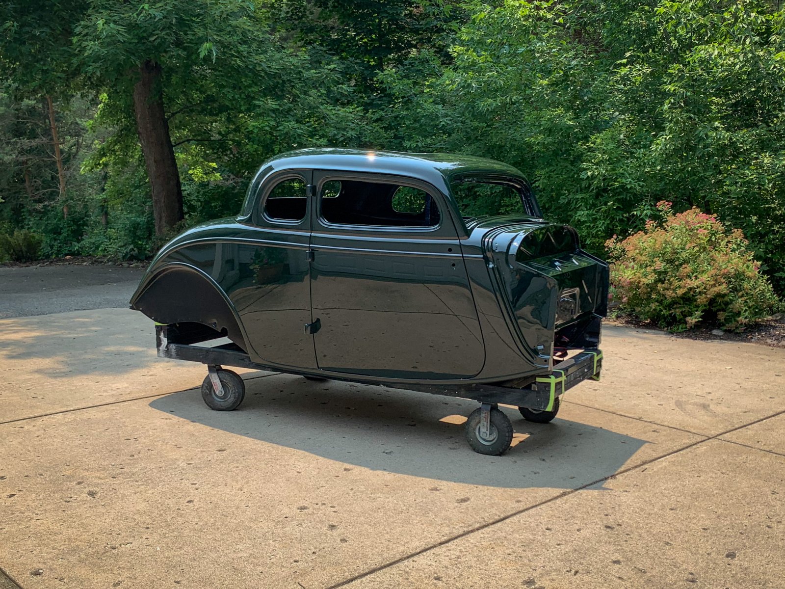

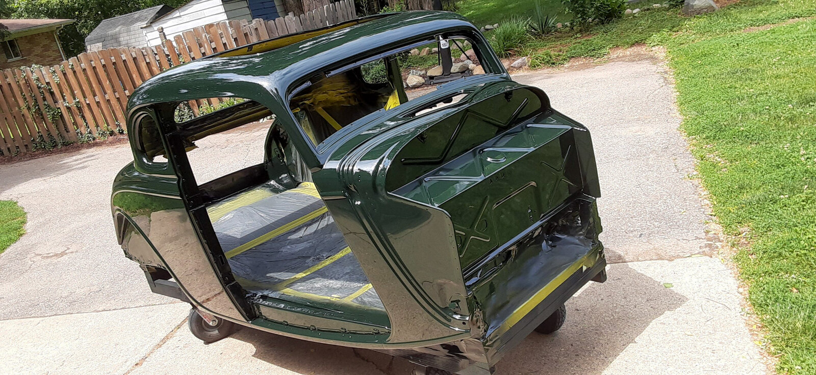

    Big day - the body came home from Matt's! I'm very pleased with his work.
    Hoping to get it on the frame by the end of the month if all goes well.

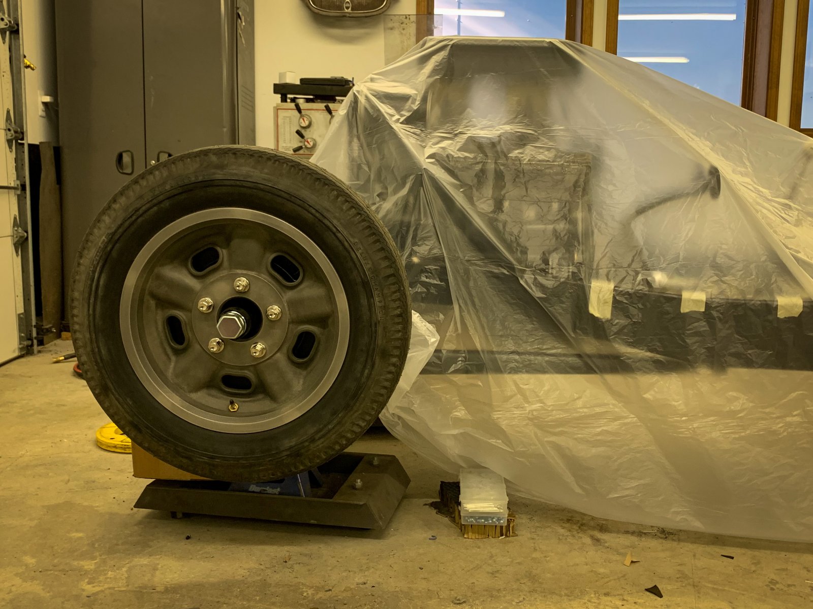

    I had to put a rear wheel next to the body to see how the colors would look together too!
