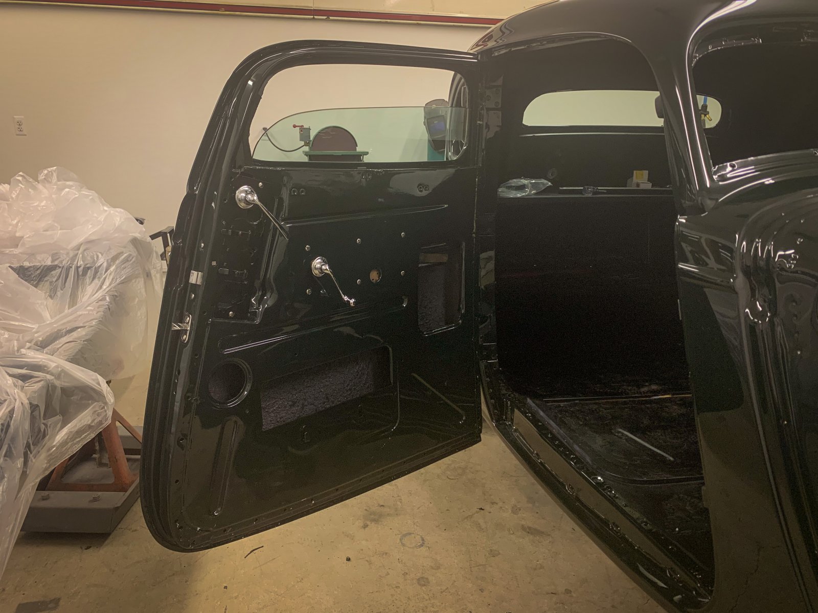

    I've been chipping away at some small projects on the '33. With the top insert panel wrapped, I got the tack strip moldings installed, and ****oned up with the nice rubber filler strip.
    Then I moved on to reinstalling all of the body wood that I had previously painted black. Next, the cleaned and regreased window regulators went in after some new gl*** I had cut for the car. After working on a project last year that had Solex gl***, I grew to really like it....so that's what I had cut for this car. I think it complements the body color well too?

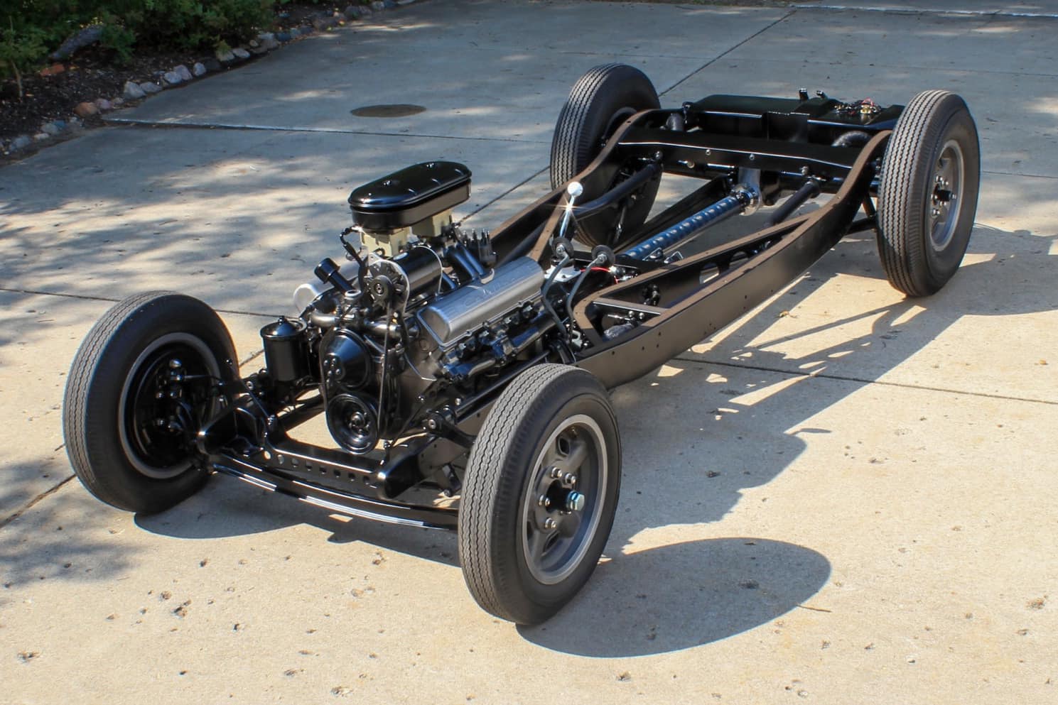

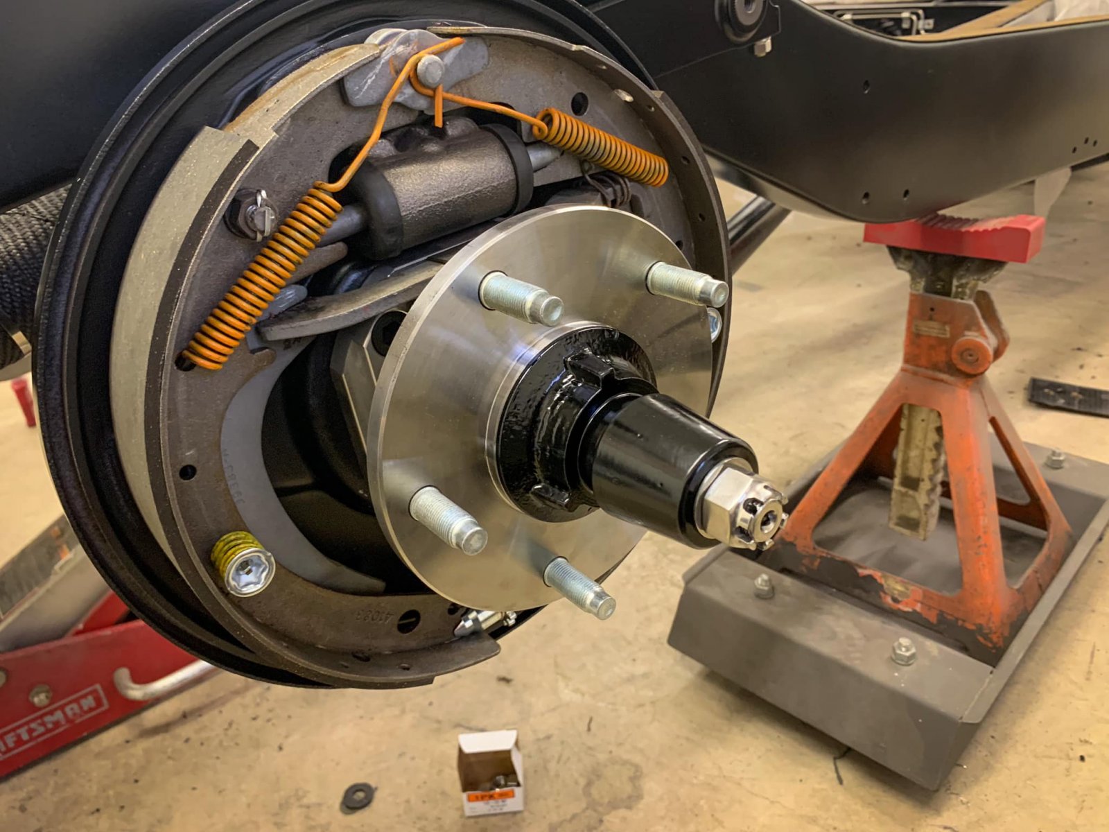

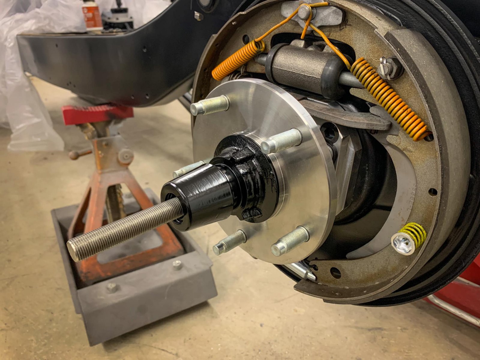

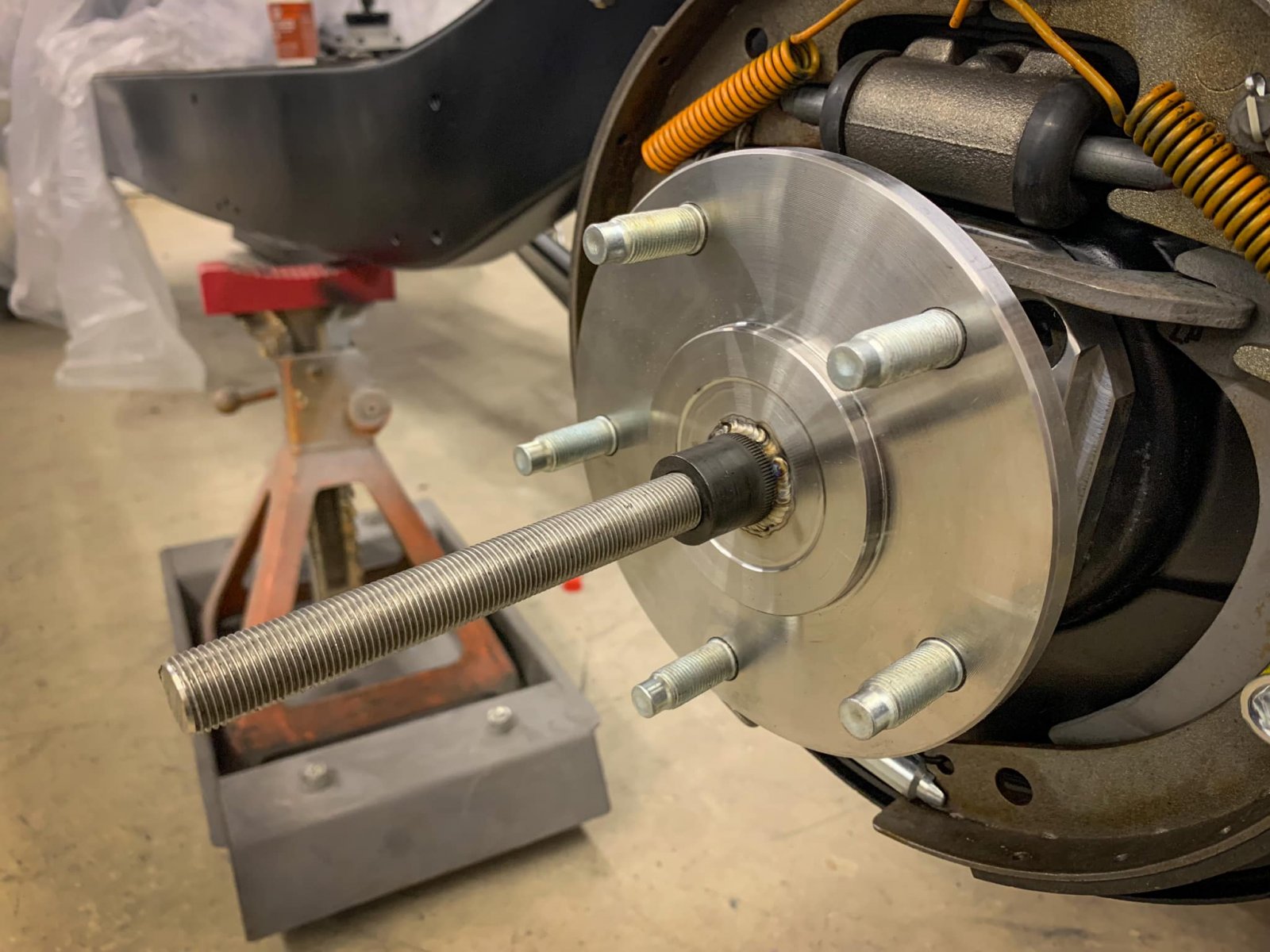

    Knocked out a bunch of small projects on the frame this week. I got the freshly painted rear end in the car, and the rear suspension ***embled. With the rear end in place, I could measure for a driveshaft, and I promptly got one on order.
    I wanted to keep the look of the original Ford rear hubs, so I took a pair of rear hubs and machined the snouts off. I found a socket nut in the McMaster catalog, along with some stainless all thread and castle nuts, and came up with a plan to make the rear end appear to still have stock axles.
    I chucked the new slide-in axles in my lathe, and used a live center to locate the socket nut on the face. I then rotated everything by hand as I welded on the socket nut. The stainless all thread got shortened to fit, then drilled for a cotter pin. Looks stock on the outside, and easy to remove and reinstall as needed!

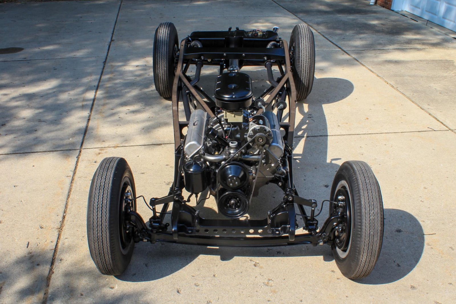

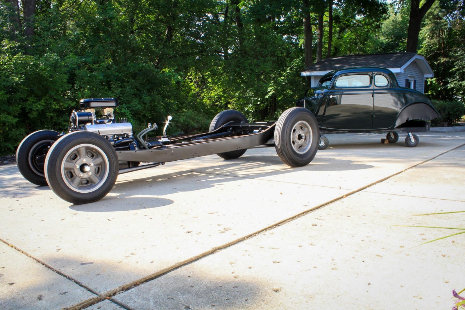

    Another small project was doing some light turning on the MT brake drums to fit the original Lincoln backing plate slash shields. It didn't take much, but it was necessary to get enough clearance. With that done, I painted the rear drums and once dry, got them installed.
    I moved onto bleeding the brakes, using a Motive power bleeder. When I built the plumbing last year, I stepped up and bought a nice turret style flare tool. I can say that it was worth the money, as I didn't have one leak! Once everything was bled, I adjusted each corner, and the resulting pedal felt great.
    About that time, the driveshaft hit the door, so I got it installed along with the rear wheels, and rolled it outside!

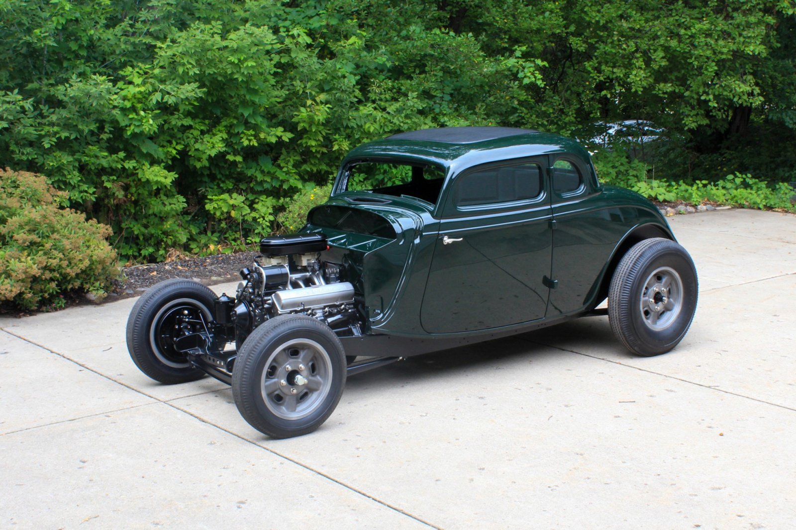

    A few more shots before I rolled everything back inside......
