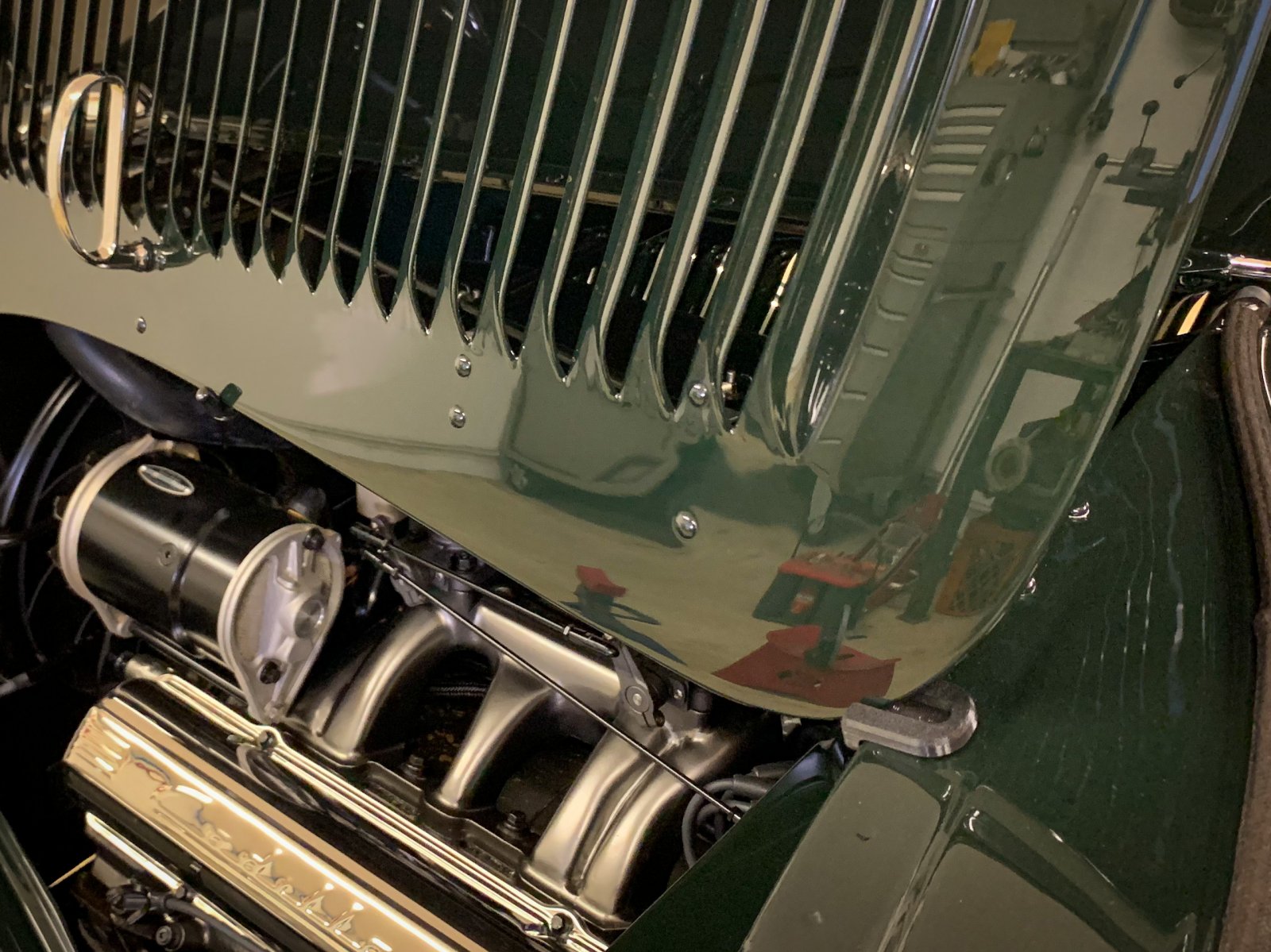

    I got the fenders and running boards on this week, and continued forward with ****oning up the fender braces and headlights. I had picked up a pair of Rick Bales' br*** tags to replace my poor quality original tags on my 682 buckets.
    I also spent some time tracking some Cibie H4 headlights to use in the Guide buckets. Cibies are the best damn headlight you can buy, but unfortunately, they're no longer made. What's left for sale is the end of production, which were barely meeting their lighting standards. I found a nice pair for sale locally, date coded 2000, so I know they're good! I also added "city lights" to them, repurposed as daytime running lights via an amber BA9 LED bulb.
    My hood caddy was forcing the hoodside to contact the cowl when raised. Short of making some really long arms, I decided a bumper might be better to keep everything tucked in nice when raise. I designed up a simple bumper in CAD to fit the cowl, then had some 3D printed in a TPU material which is rubber like. Now, both the hoodside and cowl are protected from chipping.

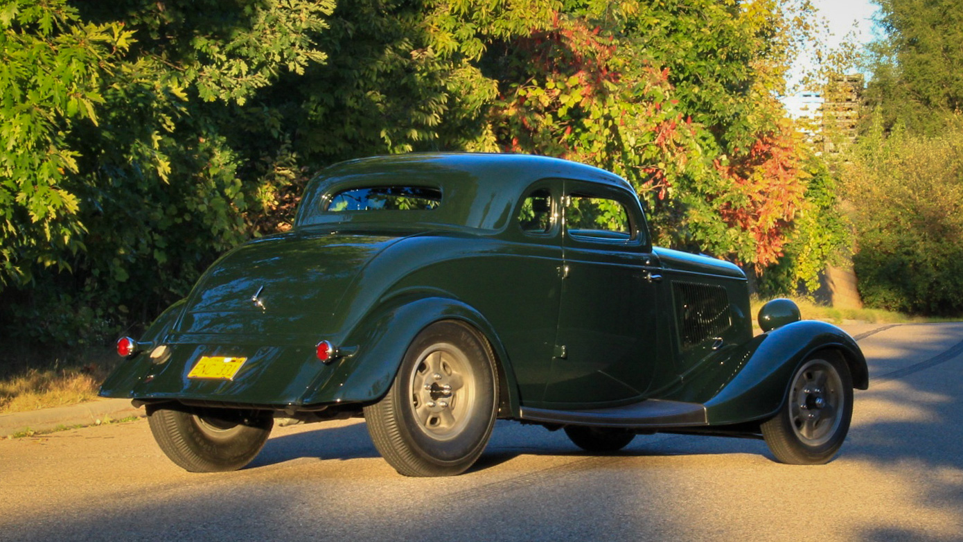

    I've been venturing farther and farther away from home, so of course I grabbed some shots in a different environment!
