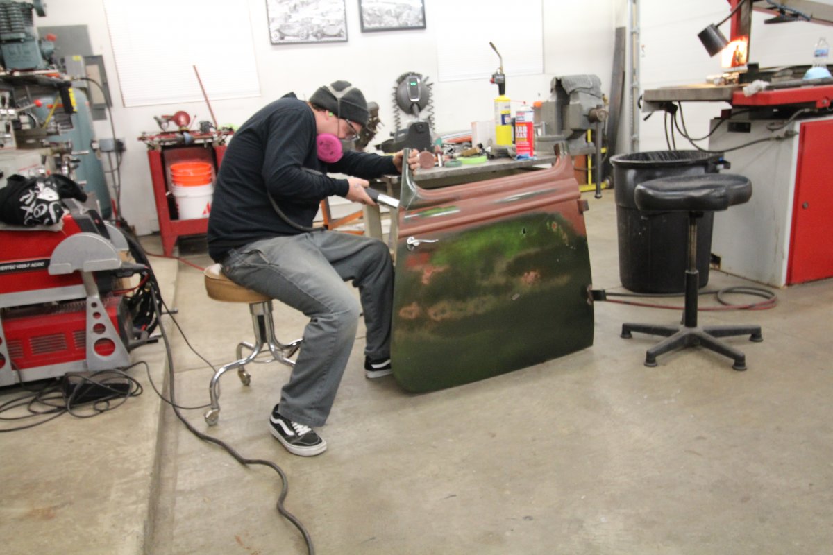

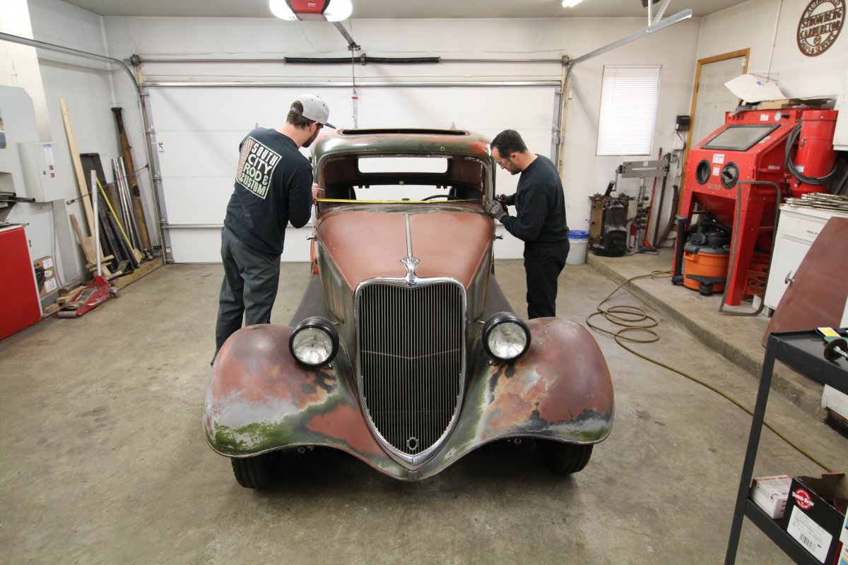

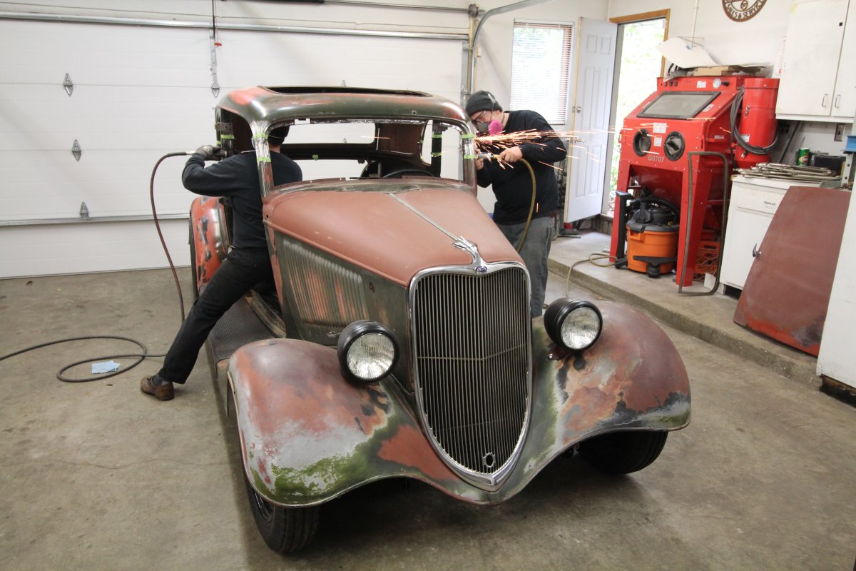

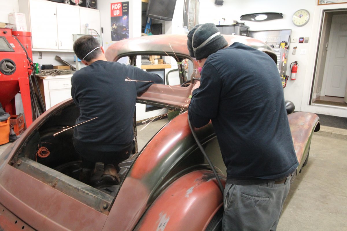

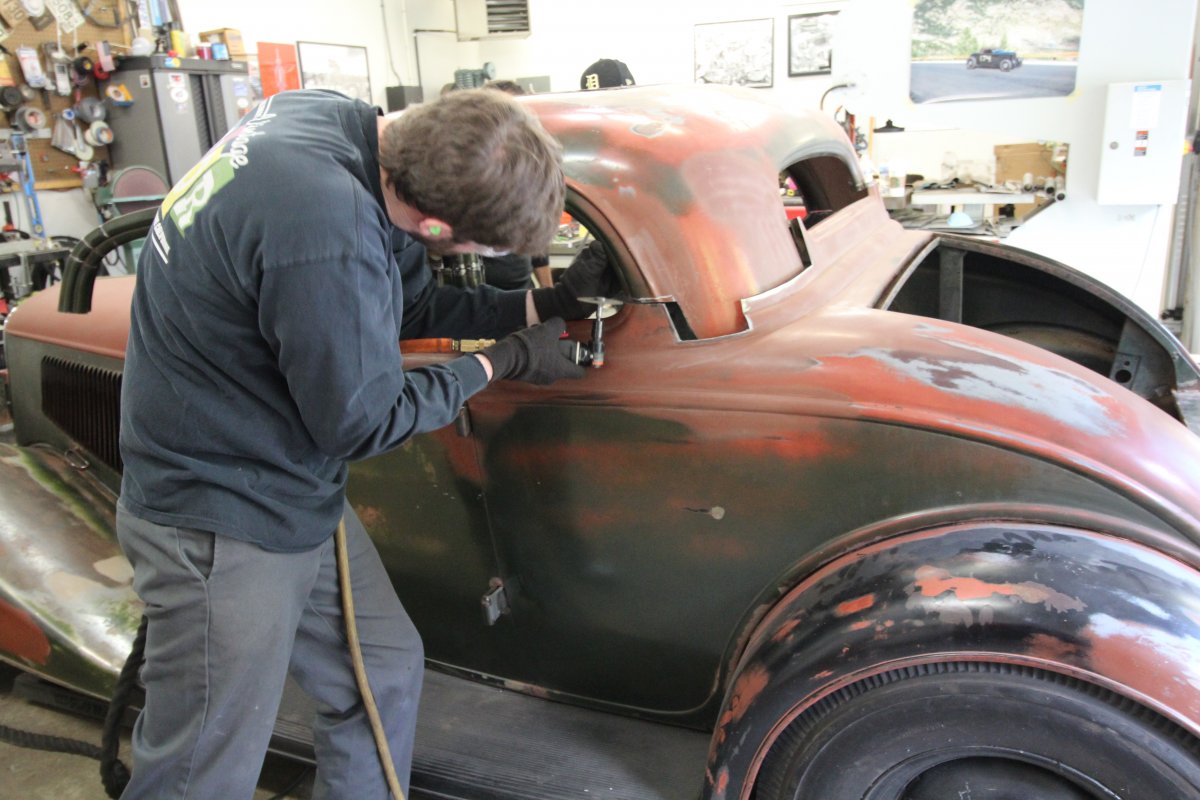

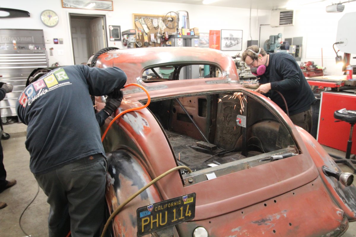

    A few weeks ago, a couple of friends came back from Northern California to help me chop the '33. I'm not a sheet metal guy, so having them here helped get the car on the right track. We spent about 2 1/2 days in a thrash, and got the car pieced back together before their plane headed back west:

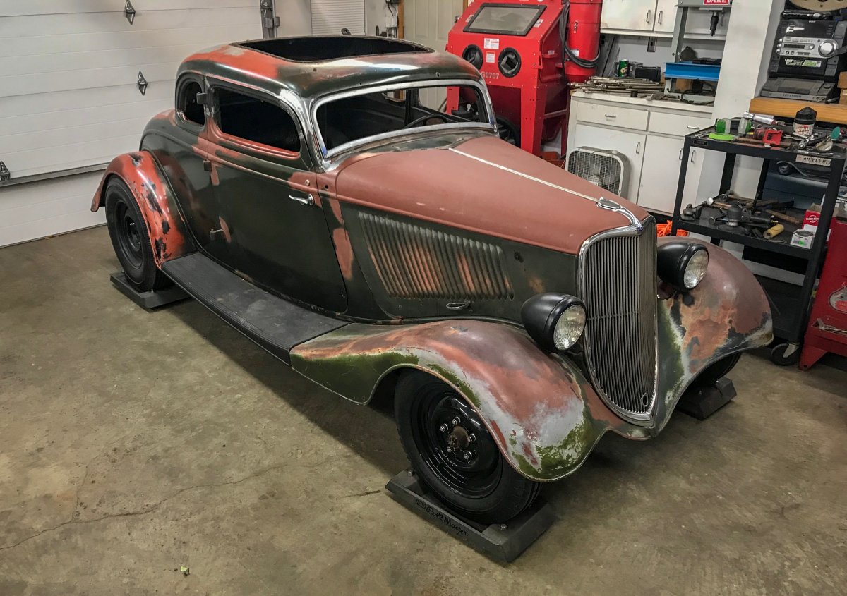

    I've got a lot of finish welding to do, as well as the garnishes, but I'll chip away at it now in the evenings and weekends.
    A look back at the car Bill helped me with in 2015, next to the car in 2018:

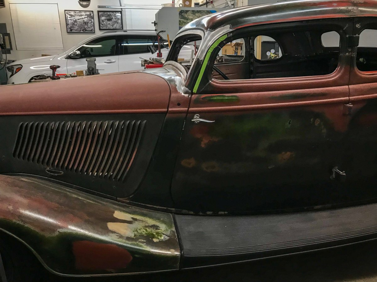

    The header was still out of the car, allowing access to the backside on the upper a-pillar corners. Once that was welded, I refit the header in the car with some sheet metal screws, and got the windshield frame chopped. After the frame was mounted, and everything dialed in, I pulled the frame and welded the header in the car.
    I'm real happy with the size of the opening, and with the frame in the car, the lean of the windshield shows well now.
