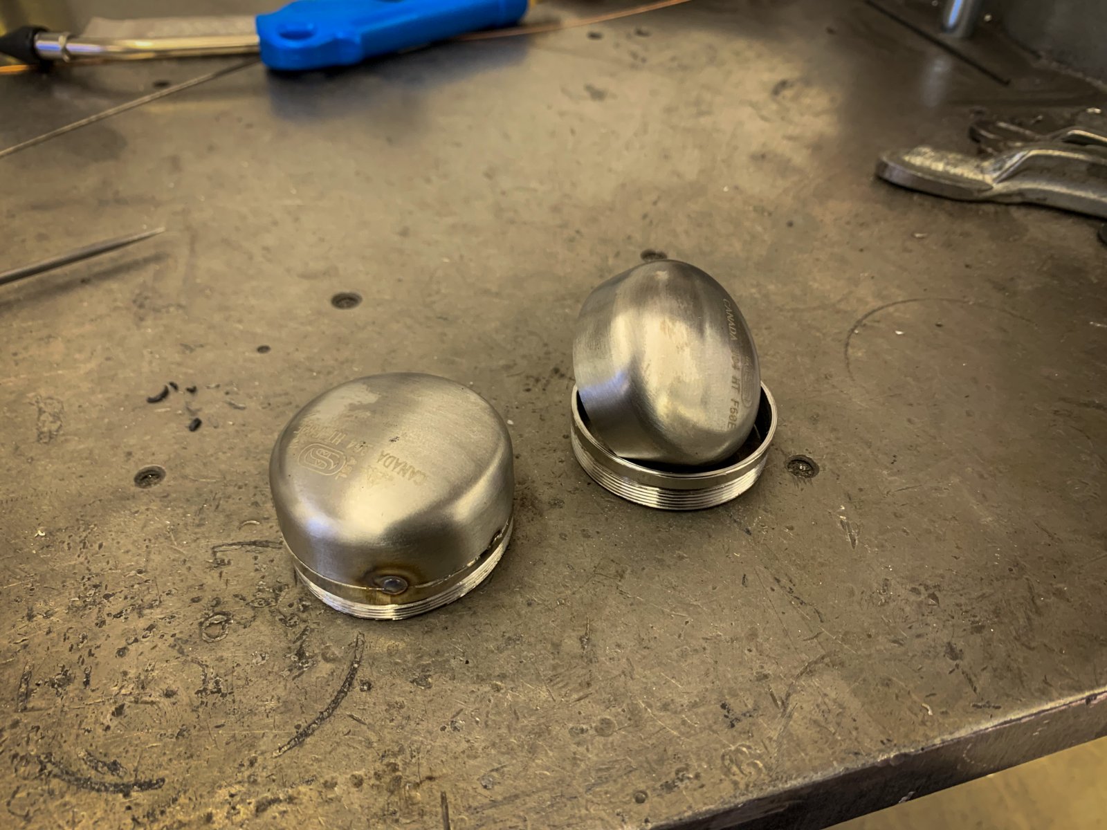

    The snow has been flying, so I've been working some projects that I put off this summer.....
    I wasn't real happy with the front hub dust caps. They were reproduction screw-in caps, which I had planned to have nickel plated in an effort to look similar to the polished stainless lug nuts, but I ran out of time to get them done before the car hit the road.
    I browsed the McMaster catalog, and found a rounded stainless cap in the correct OD to make a dust cap. I picked up some 2" OD stainless tubing as well because the caps needed to be a bit deeper to clear the end of the spindle.
    I cut threads in the tubing to match the hubs, then cut "slugs" to be welded onto the McMaster caps. After the welds were dressed, I polished everything. I think these look better than the hex shaped caps?

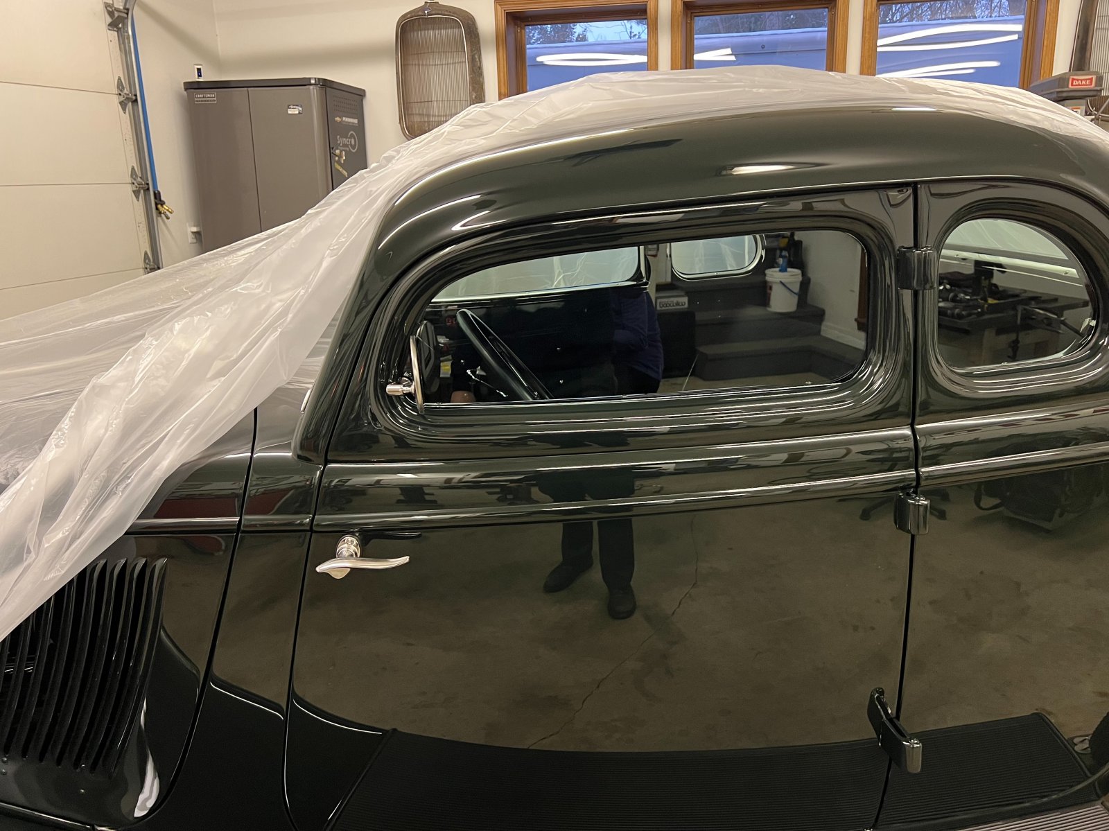

    I didn't have a drivers side mirror on the car, but definitely needed one. With a p***enger, I could have someone check over my left shoulder, but it was always sketchy if I was alone!
    I guess some of the delay was finding a clean way to hang a mirror on the car. I didn't want to drill the door skin in any way, and my efforts to tighten up the door gaps meant that an edge clamp arm wouldn’t work. I saw that Ray Forbes had a creative solution on his newly finished '33 3w, so followed his lead!
    I picked up a 3" peep mirror from United Pacific. I was only going to use the mirror head, which I liked because it had a convex lens to expand the viewing area. From there, I fabricated a stainless bracket that attaches to the return flange of the window opening, out of 0.125" stainless flat stock. I welded a 3/8" post onto it, followed by a piece of 5/8" stainless, with the inside machined to accept the mirror mount. The window channel is sponge rubber in this area, so it conforms around the bracket without pinching the gl***.
    With the welds dressed and polished, I got it installed for the final time.
