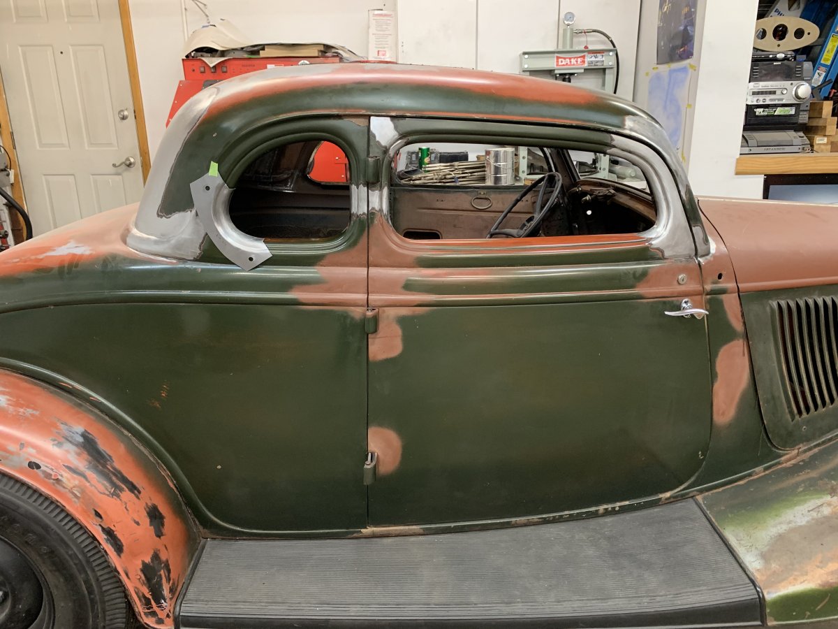

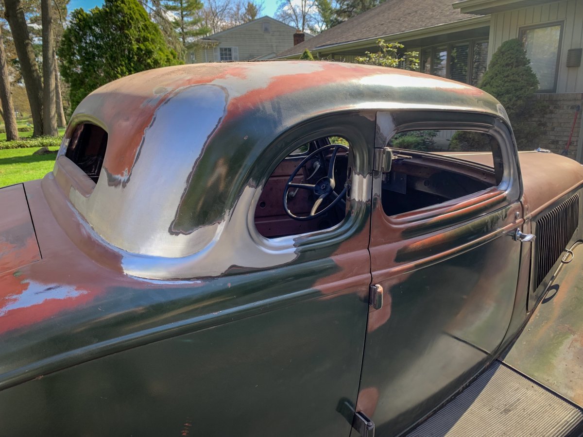

    Between some other projects, I chipped away at the car in the background. I had to address the rear corner of the quarter windows, which were now peaked from the path of the chop. I wanted to finish it in a larger radius, to complement the other two radii of that window.
    I've never used a Pullmax before, but have access to one, and figured it would be the best route to making the new corner. I made a paper pattern of the window opening that I wanted to achieve first. With that known, I knew the radius that I needed to achieve for the new corner, and transferred that to a wood hammerform that I made. This allowed me to turn the window opening flanged after stretching the material:

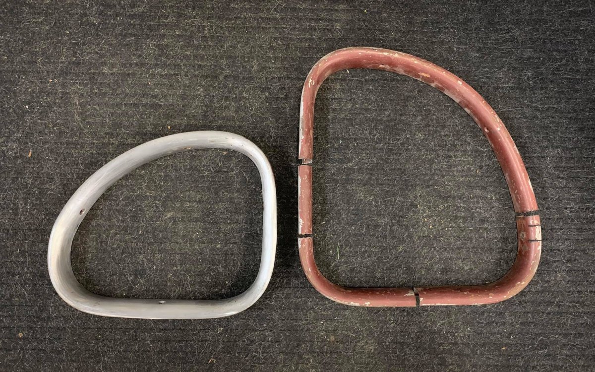

    I made some dies to form the detail of the window opening using some 1/2" steel. With that done, and several window corner blanks, I went to Dan's to try them on the Pullmax. It took a couple of trips, and probably a half dozen blanks, before I got a pair down that I was happy with:
