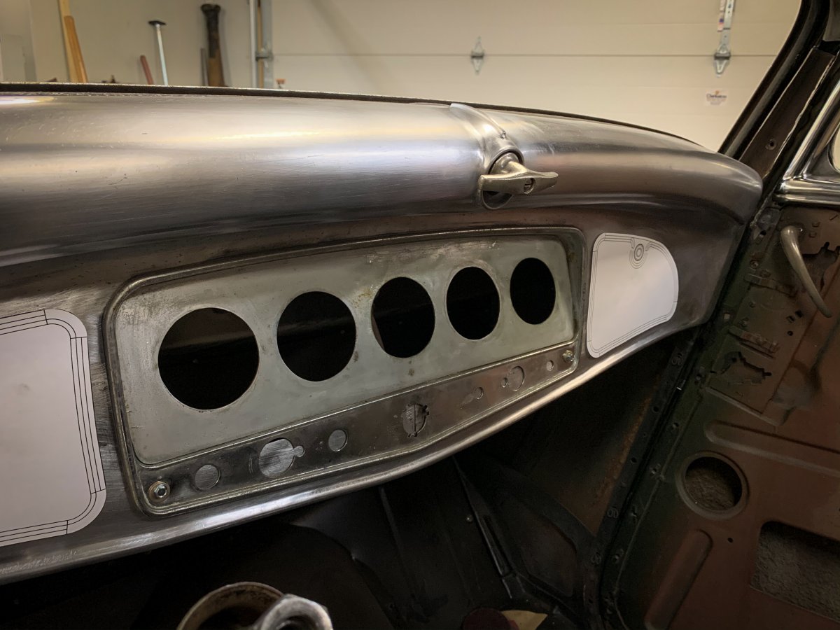

    I've also been working on the dash for the car. In my opinion, '33-34 dashes are hard to make look good in anything other than stock form. I had an old '32 3w dash that was in a hot rod at some point in its life. Someone had remade the bottom half to accept an Auburn panel (along with a 5" Stewart Warner speedometer and tach), and after sitting it in the car, I thought it was a cool look:
    Unfortunately, that dash panel was a little too far gone to make it worth while for the '33, so I picked up a new Brookville flat 3w dash to use. Here's an idea of what I wanted to get at:
    HEMI32, 51box, Shadow Creek and 4 others like this.

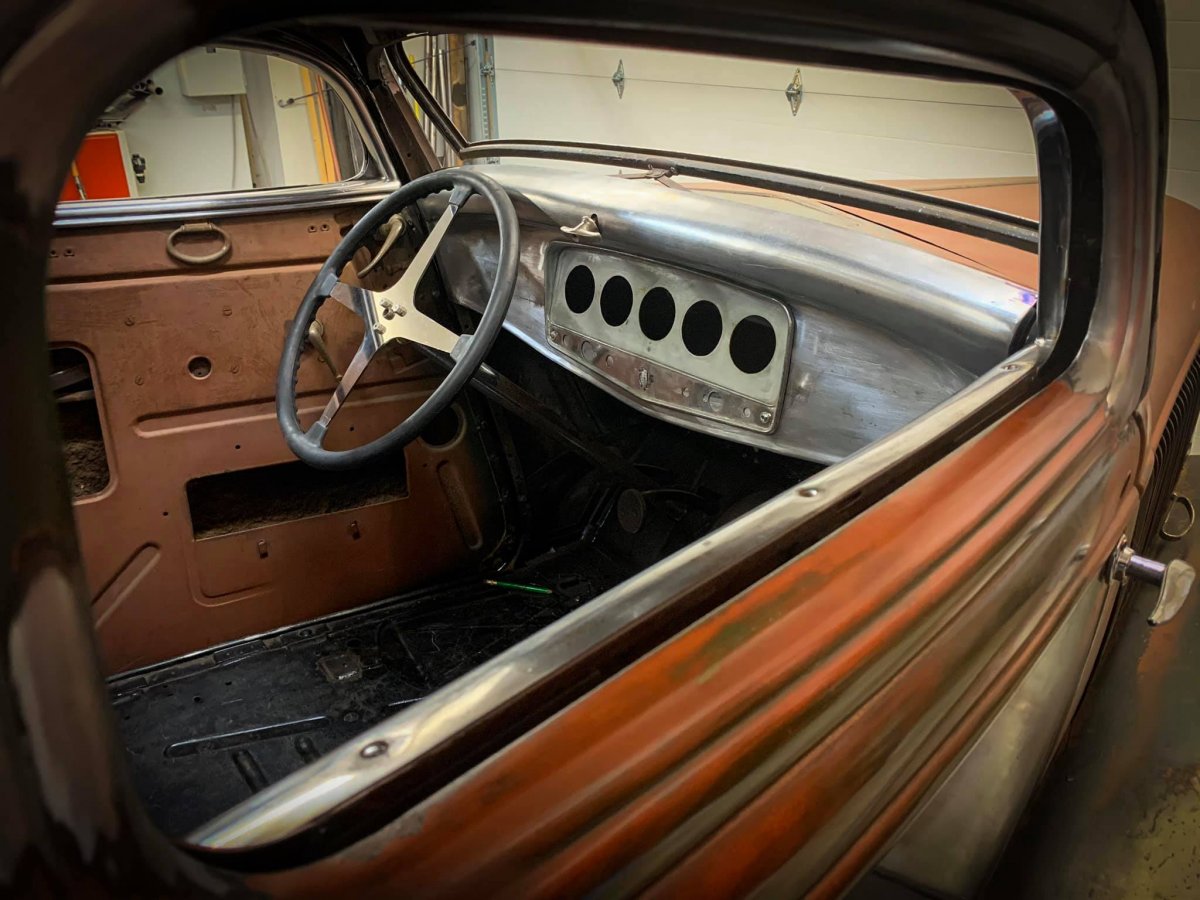

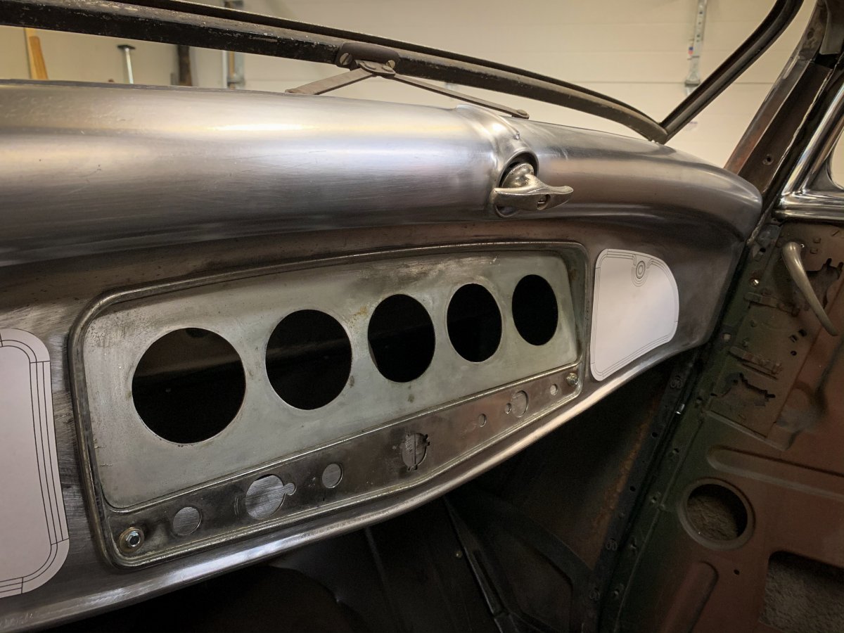

    Once the upper rail work was about 75% done, I moved onto lengthening the lower area to accept the Auburn panel. I added 1 1/2" to it, and got the hole cut for the Auburn panel. As of today, I got the welds hammered and rough ground enough to do a mockup in the car.
    Overall, I think I'm pretty happy with the concept. I'm going to make something to finish off the transition between the upper rail and windshield crank knob, and maybe put dual gloveboxes in the dash to balance out the space.
    The dash still needs quite a bit of finish work, the Auburn panel needs to be repaired from the current gauge sizing/spacing, and the cowl vent handle and spring need to be moved a little to clear the gauge panel as well......

    I spent some time this week working on the glove boxes for the dash. I used some 1/4" blue tape and came up with a shape that complimented the Auburn panel and lower rib. From there, I traced the profile on a piece of paper so that I could scan it and trace it in CAD.
    I took that profile in CAD, and came up with a door that has a raised rib around the perimeter to compliment the Auburn panel. I designed a ring (green in the pics) that will be machined from mild steel so that it can be welded into the dash. It has the provisions for the hinge and a couple rubber bumpers.
    The door and hinge are getting machined from aluminum. I'll also be using some '60s VW glove boxes latches as they're very compact and look pretty cool too.

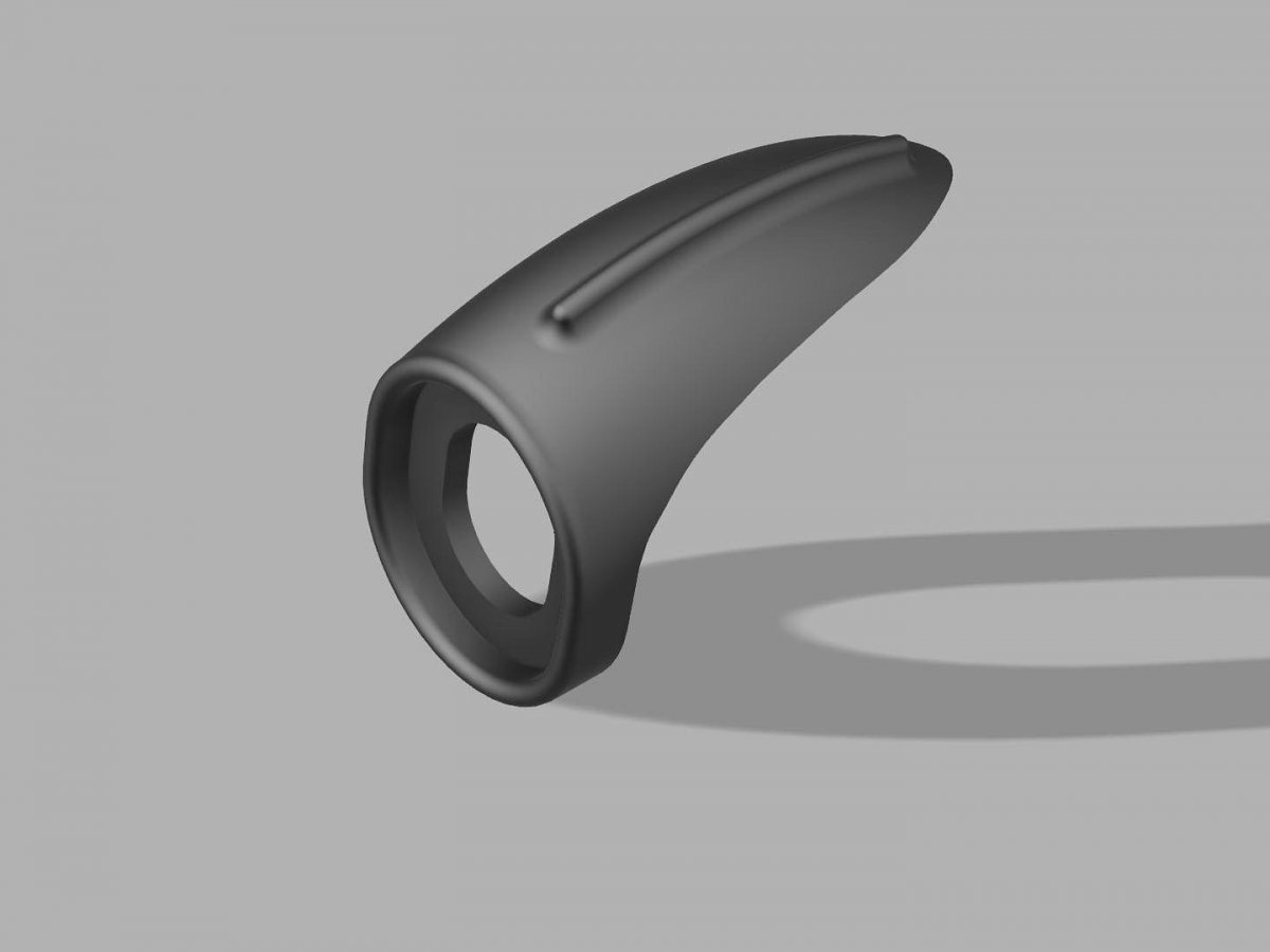

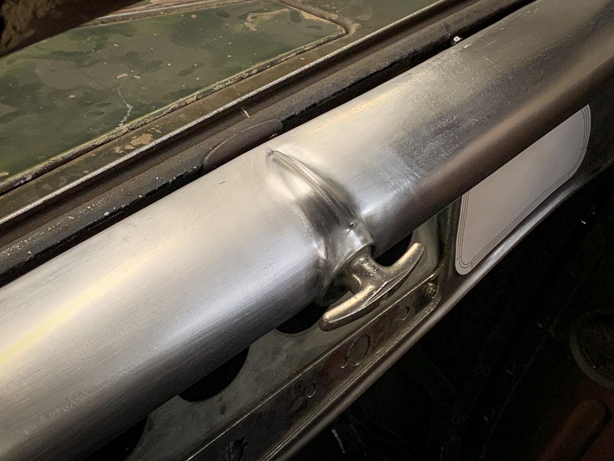

    The windshield crank looked like it was hanging out in the wind on the '32 dash rail, so I thought it needed something to finish/integrate it a bit better. I decided to model something in CAD rather than try to fabricate it.
    Using a contour gauge, I captured the profile of the dash rail and transferred that to a piece of paper. Then I scanned it so that I could trace the profile in CAD. From there, I took some more measurements of how much the crank moves vertically during the sweep to make sure I captured that in the design. I built a raised surface, with a design that was flexible for any errors on my measurements:
    I got the center piece machined from mild steel so that I could weld it into the dash. Here's shot of it laying on top of the rail. After scribing the ****m on the rail, I cut the dash so that the center piece could be set in place and welded:

    After welding and then dressing the welds, I arrived at this finished product:
