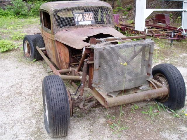

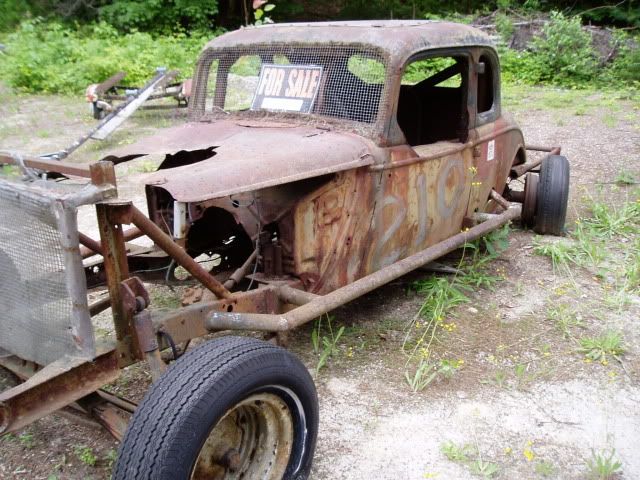

    Stumbled across this car when I was 15 or 16, and picked it up when I was 17 for $400. Brought it back to life when I was 19, and I was on the right track, but I lost my way with the build at the end. Never really happy with how it turned out. After staring at my mistakes for a few years, I decided it was time to rebuild it again - with hopes of entering the Race of Gentlemen. Trying my hardest to preserve the history of this old jalopy, while transforming it into the hot rod I really want.
    Circa 1971 (Photo courtesy of the O'Brien family):
    Circa 1997 (Photos Courtesy of Gene Proulx):
    How I found it:
