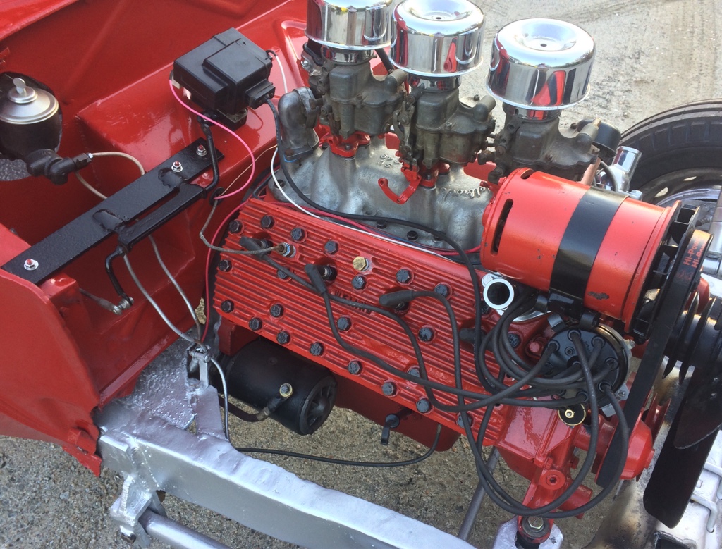

    Thought I'd share a little progress...

    Hopefully this little rig will be receiving a new mill by spring time. After 5+ years, acquiring 5 different flatheads, and dealing with a bunch of headaches with each, it looks like I've finally got enough to build a decent flatty.
    I picked up an 8BA block at an estate sale for $100 (only bid). Fresh back from the machine shop (the day before the auction), looks like it was mag'ed, 4 sleeves, and the rest cleaned up. Already drilled for adjustable lifters.
    The crank is coming from an engine that I traded a couple pieces of ductwork for. The car had sat in a swamp, and after the oilpan rotted out, the engine was invaded by about 10,000 ants. But after cleaning it out, robbing the pistons for another flathead, and using the block for a coffee table, I found that the crank was freshly turned .020. Currently polishing it a little, and trying to find someone to balance the rotating ***embly.

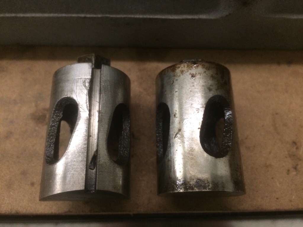

    Anyone an expert on flathead valvetrains?
    The two big bores I acquired are set up for the beveled adjustable lifters on the left. Regular adjustable on the right.
    From what I can find, I believe they’re Weber? Or maybe Isky?

    That's cool as ****! I bet Bored & Stroked has input... hit him up.

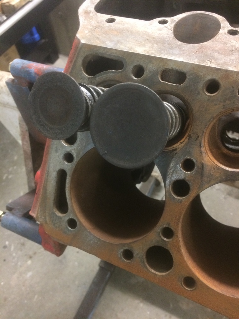

    I think this intake valve is slightly bigger than stock...

    The slotted lifters were pinned to prevent them from rotating.

    Yes, Isky and Weber and other companies offered these. You need to contact Cam Grinder Pete. He's may post here, but definitely posts on Fordbarn. He'll be able to hook you up with a cam and clips for those lifters.
