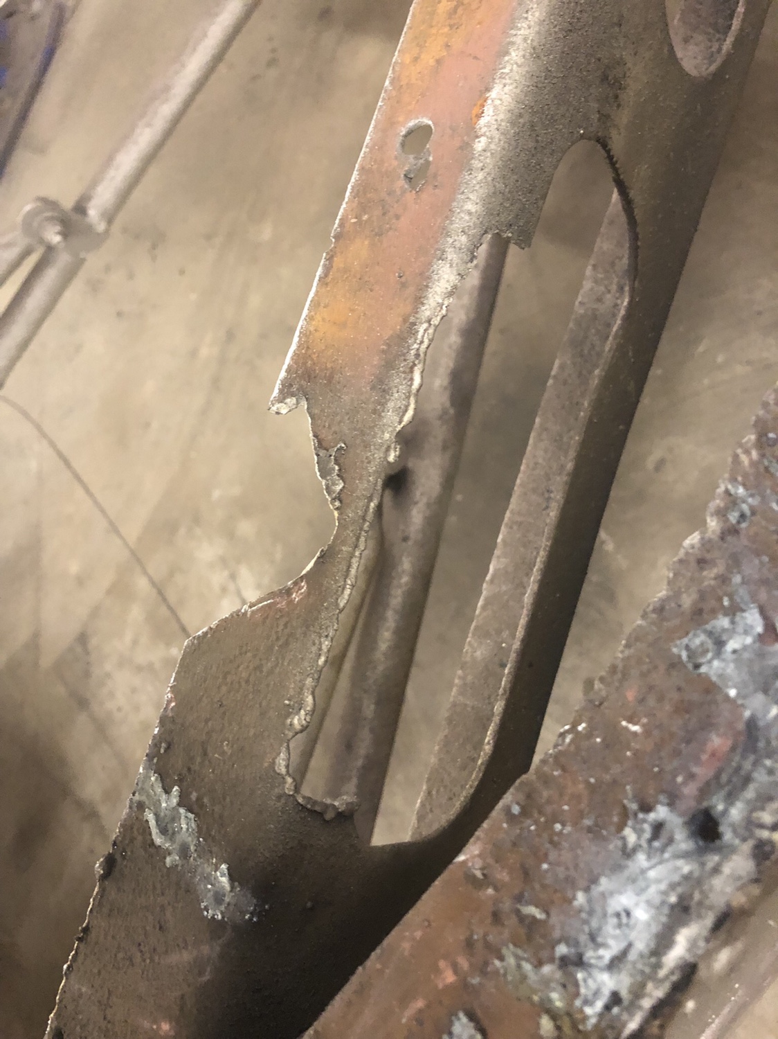

    Some of the ugly that was hiding...
    AHotRod, brEad, Stogy and 7 others like this.

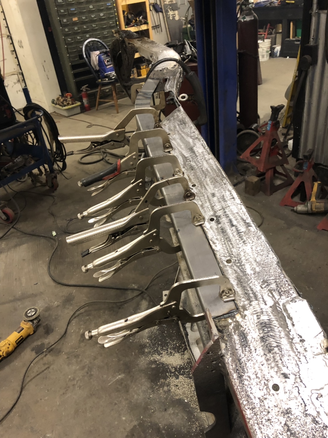

    A little more... Where the rear bumper was attached:
    Top of the p***enger rail (was patched with angle iron previously):
    Both could use a little more welding and blending, but they’re getting there!
    Stogy, catdad49, brEad and 4 others like this.

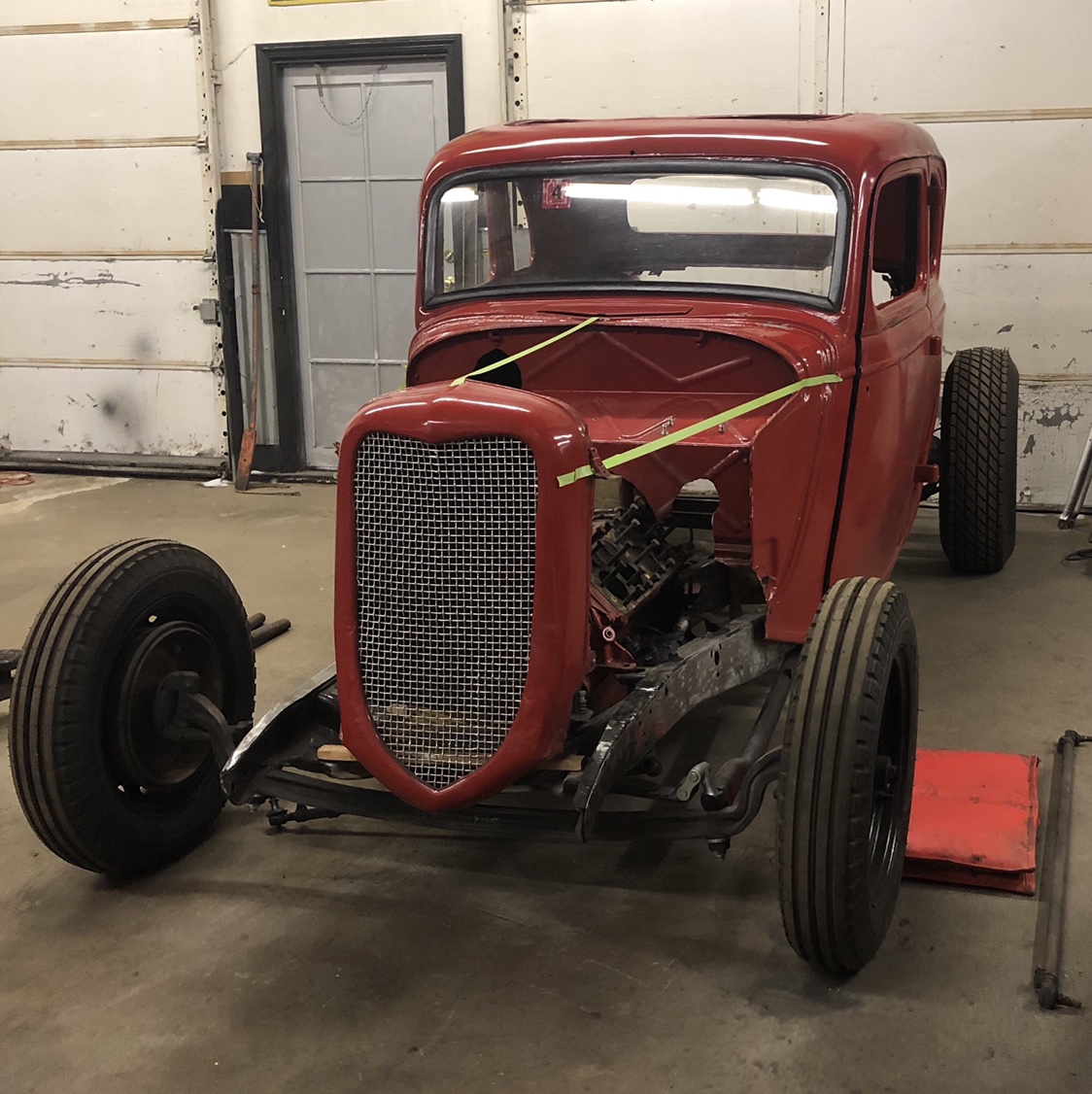

    Need to post some more updates, but toying with the mock-up and rake.
    This one is raised some, as if it were a straight axle:
    And with a dropped axle mocked up:
    51box, catdad49, 48fordnut and 8 others like this.

    I like the top one...;)...me thinks it is more period with less rake...your rubber is takin' care of business already...
    Interesting journey @Shaun1162
    Shaun1162 likes this.
  21. Nailhead A-V8
    Joined: Jun 11, 2012
    Posts: 1,455
    Nailhead A-V8
    I like the 2nd pic for rake... but which one will be the easiest to set up your steering for good ride handling bumpsteer ackerman angle yada yada?

    Some more shots from the front. Mocked up using an old drop axle I have (temporarily robbed from another project).
    Need to figure out how I want to recess the firewall. I think ‘35 Ford pickup firewalls work well?
    catdad49, brEad, Shadow Creek and 3 others like this.

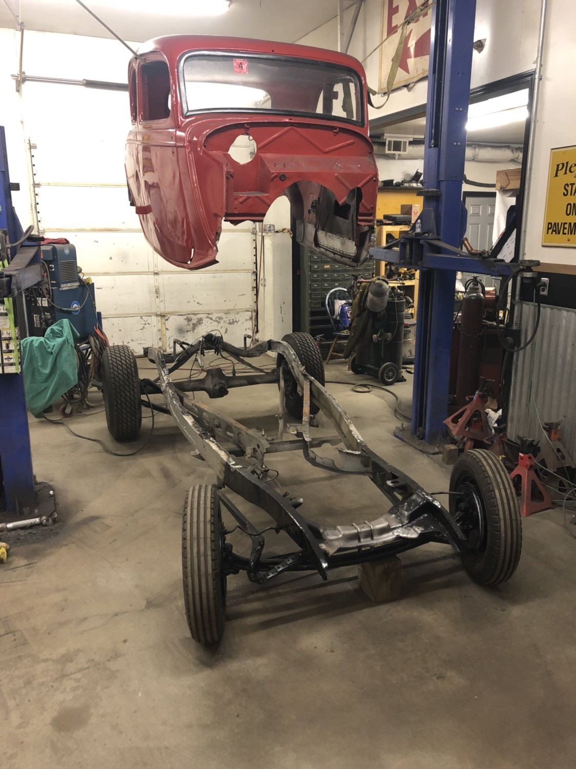

    Thought I’d give a bit of an update.
    Made up my own sub rails. Had some 13 gauge bent at 90. 6”x2”. Cut. Bend. Weld. Not easy, not great, but cheap enough.
    Cut out a floor. Don’t have a bead roller so I just made it out of 16 gauge.
    Trying to get the stance just right before I weld the body to the subrails. Wasn’t after the heavy rake that I had before. Ended up putting in the ‘35 axle I drilled and borrowed the reverse spring and stepped split bones (I think they’re from the later axles?).
    Can’t wait to chop this thing.
    Body is still rough. But I want to just get this thing on the road again. Fix a few more things, and slap another coat of cheap alkyd enamel is the plan for the immediate future. Strip it, blast it, and fix it up right next winter.
