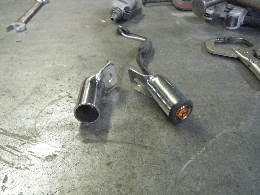

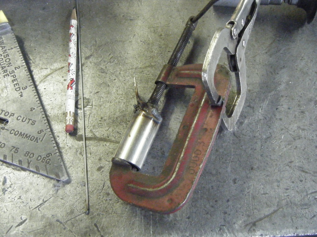

    worked on the front turn signal lights today. i welded a SS angle bracket to a two inch piece of
    ss 1 inch pipe i then sanded and polished it, to look like part of the headlight bars. i then installed a small led light. this light is like the one i put in the top of the headlight except it has an extra "crystal" and is brighter. DSCF3500.JPG DSCF3502.JPG

    i know this is not traditional, but my goal was to make them hidden. using the pipe about the size of the headlight bar i think makes them blend in and these lights are small with only a little black rim. hiding something can be easy, but when in use these need to be SEEN.

    small. sorry having trouble up loading photos today. DSCF3504.JPG DSCF3501.JPG

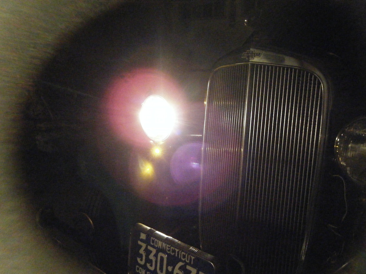

    now i have to go out and check....pictures to follow.....

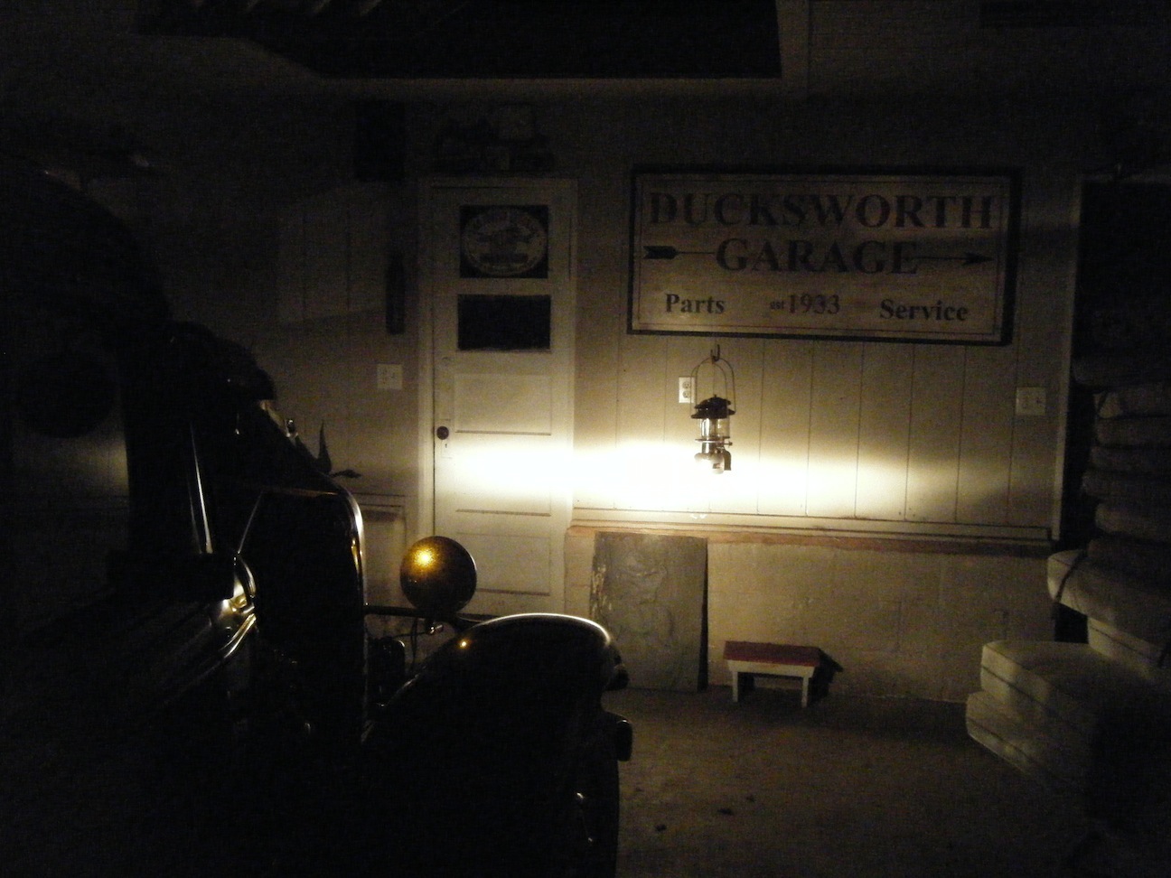

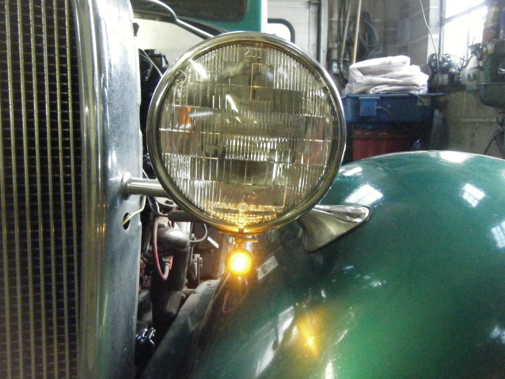

    i think when the light is flashing it will show up well. it is bright! the camera created some glare in the photo that is not seen in person. the light is easier to see than a hand signal at night

    pic 2 looks much more promising than pic 1. Now I see the "amber" effect like was said...
