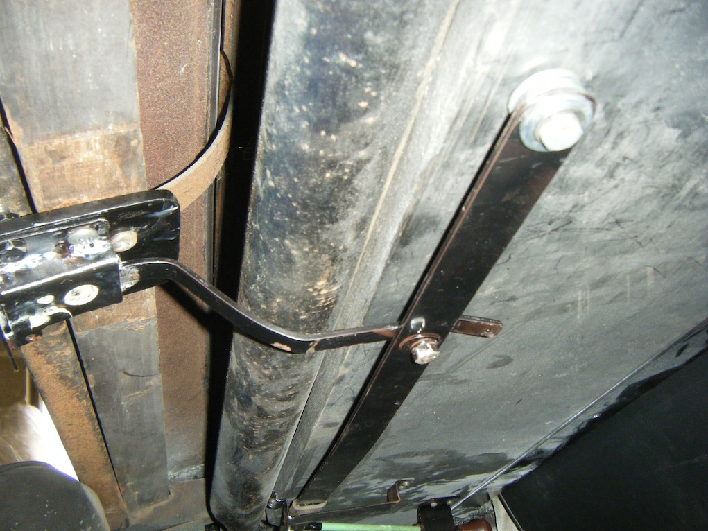

    last weekend i made up the rumble latch. my dad had removed the original rumble latch and mounted it to the body, and used a starter solenoid to pop it open. since i had it, it never worked and was stuck in the open position. rumble stayed closed without it tho.
    i took the latch apart, removed the lever my dad added and cleaned it up. i then made a bar with a T, that can pull on the latch bolt. i then made another bar that is anchored on one end, has the T bar connected along it, so that when the other end is pulled it levers the latch open. to get access i added a rod with a knob that brings it forward to just behind the driver seat. works really well. DSCF3563.JPG DSCF3564.JPG DSCF3565.JPG DSCF3566.JPG DSCF3567.JPG DSCF3569.JPG
